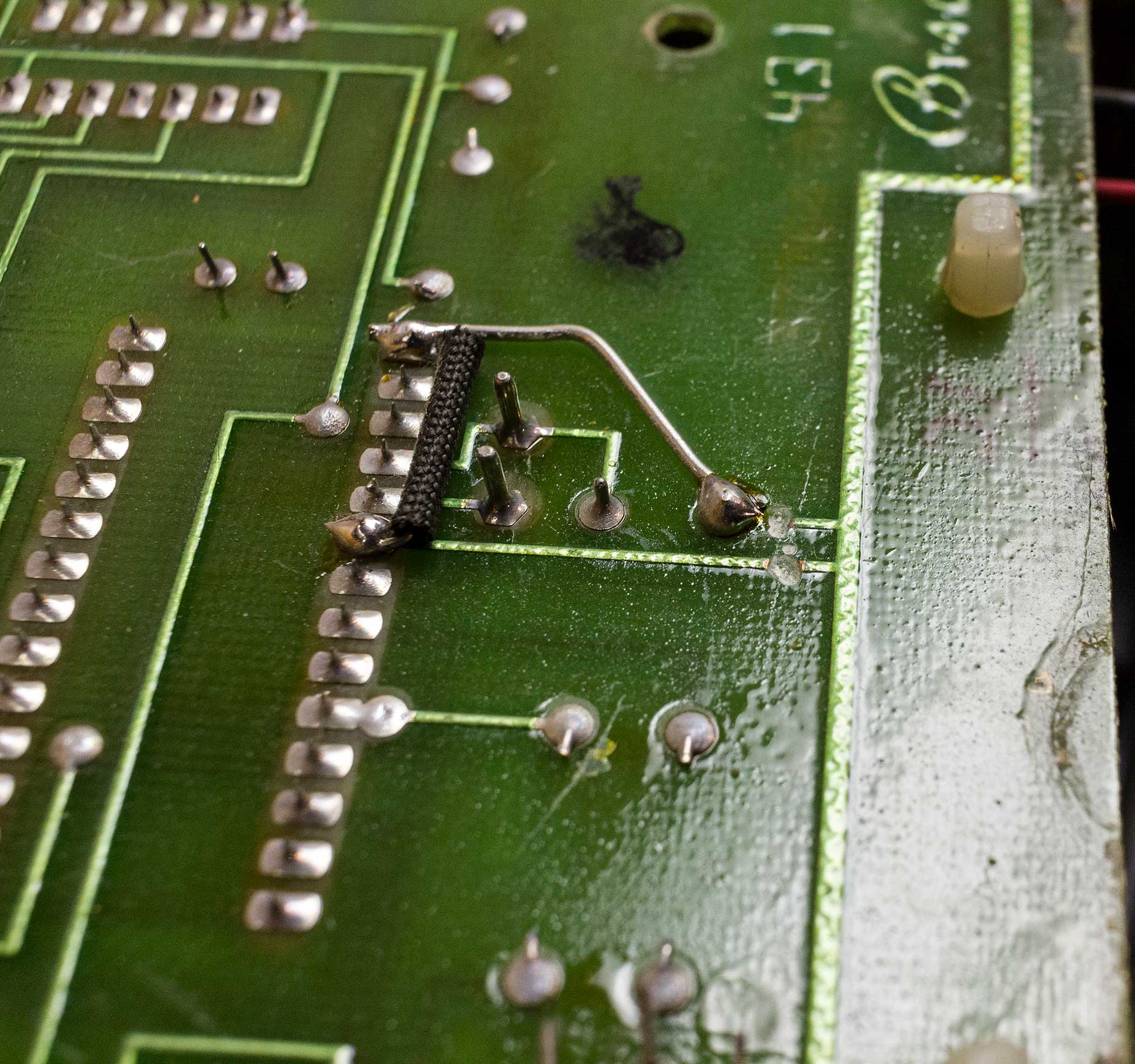

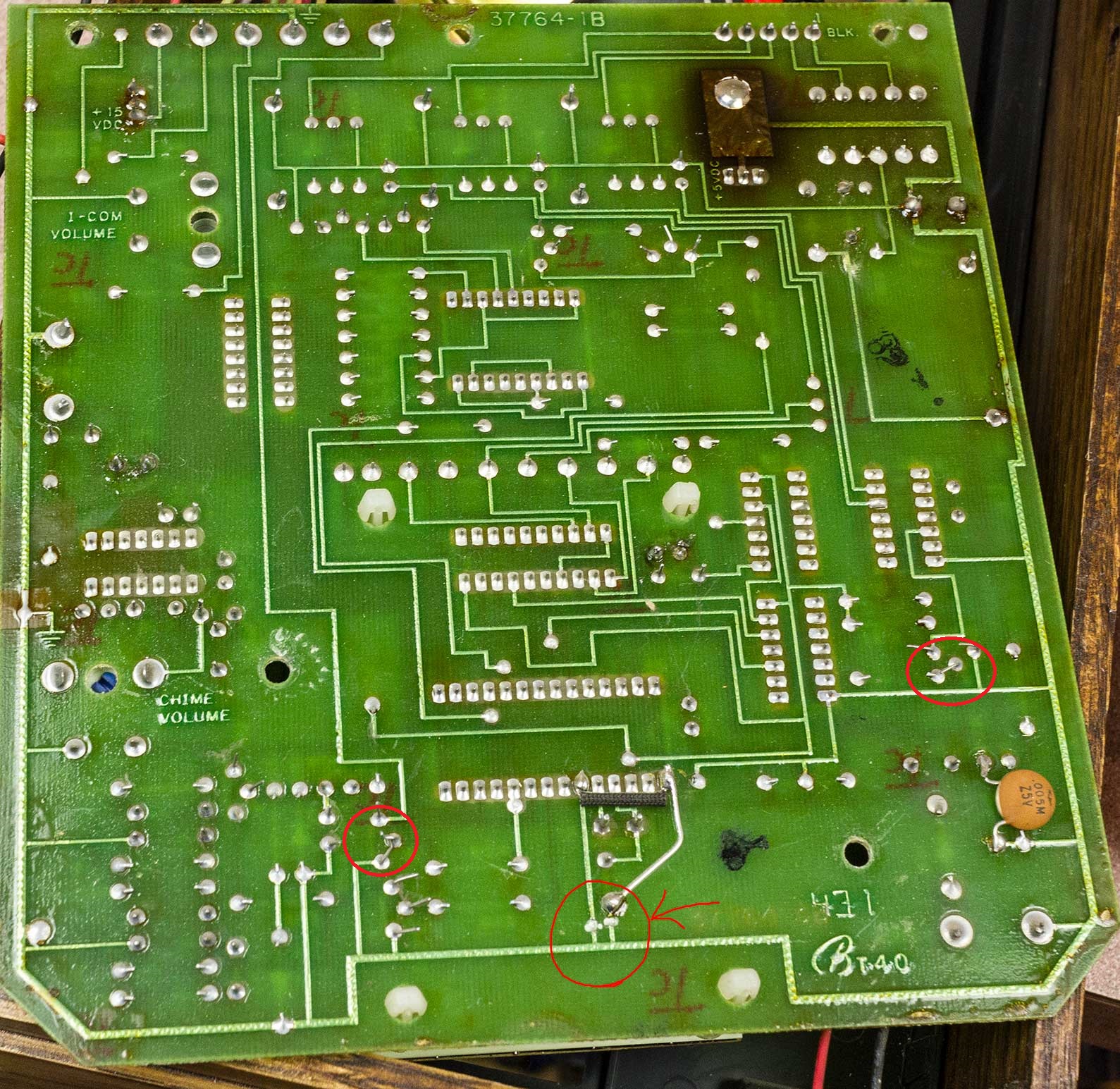

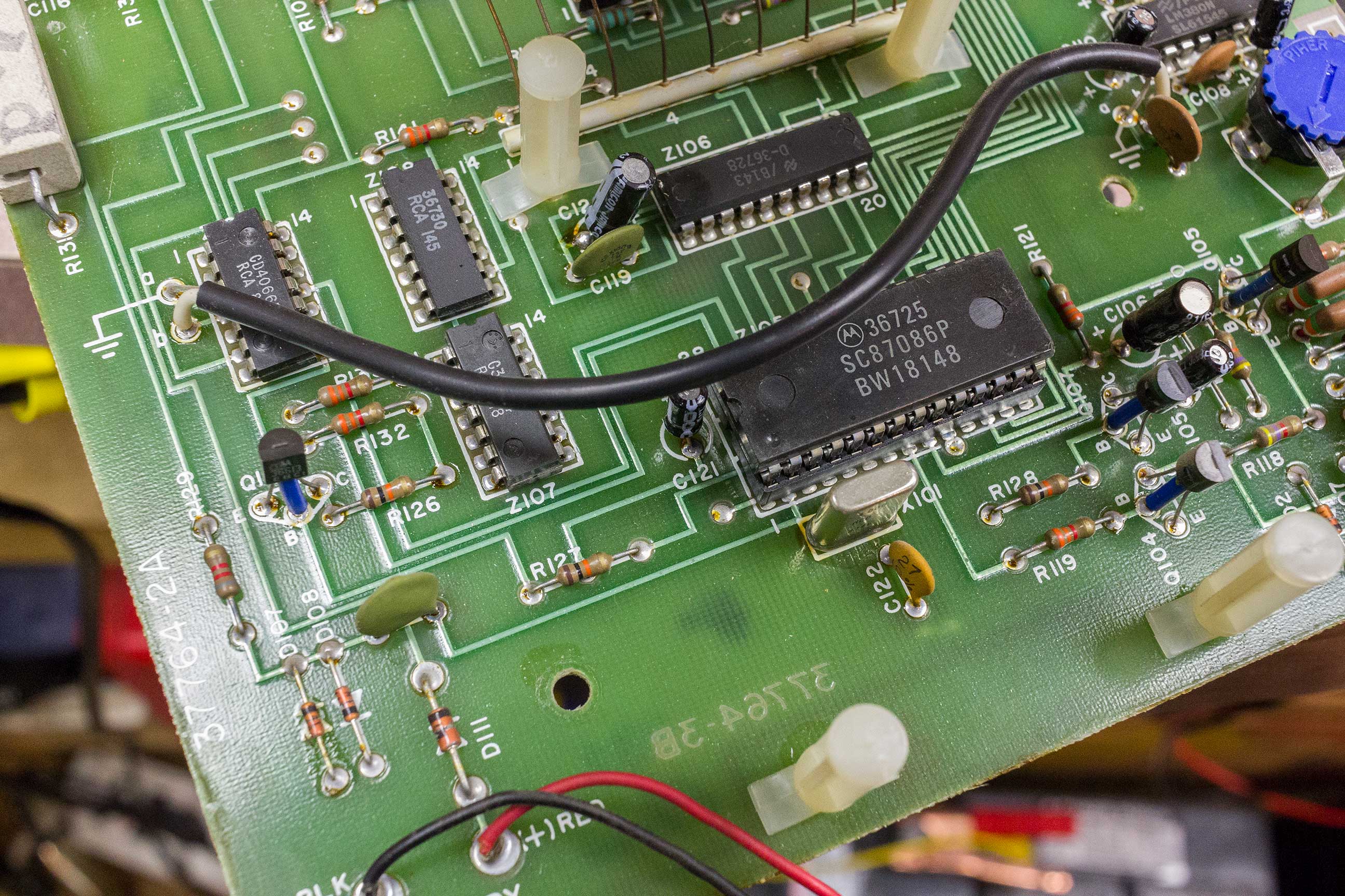

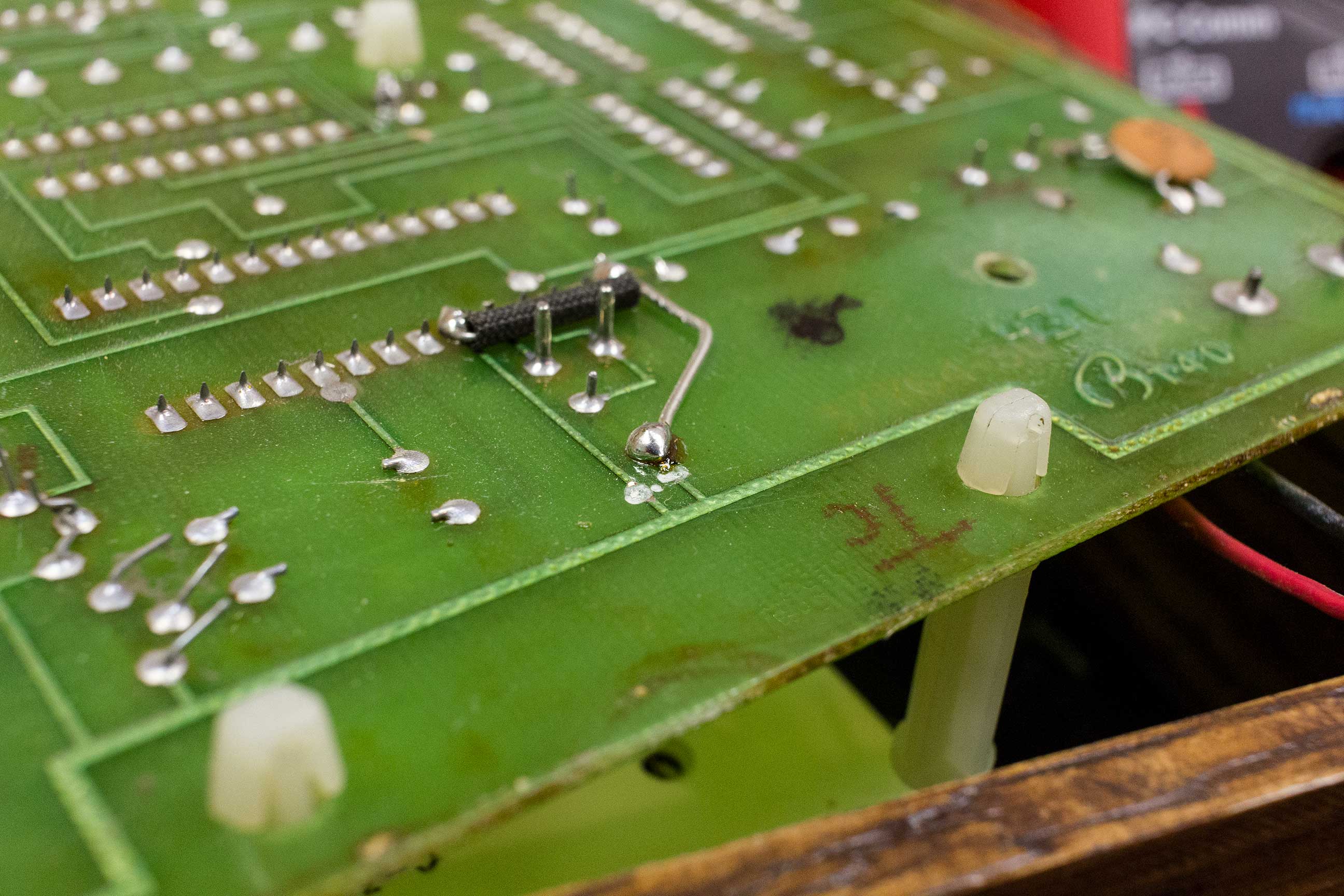

        looking around the crystal and main chip i noticed this: (pic)
        i'm not sure what this is or how it happened, but before i do anything and possibly break it more... i've got a few pics for you to look at. i've circled the point of interest. also i've noticed the whole ground trace is bubbled.
        it looks like both traces exploded?

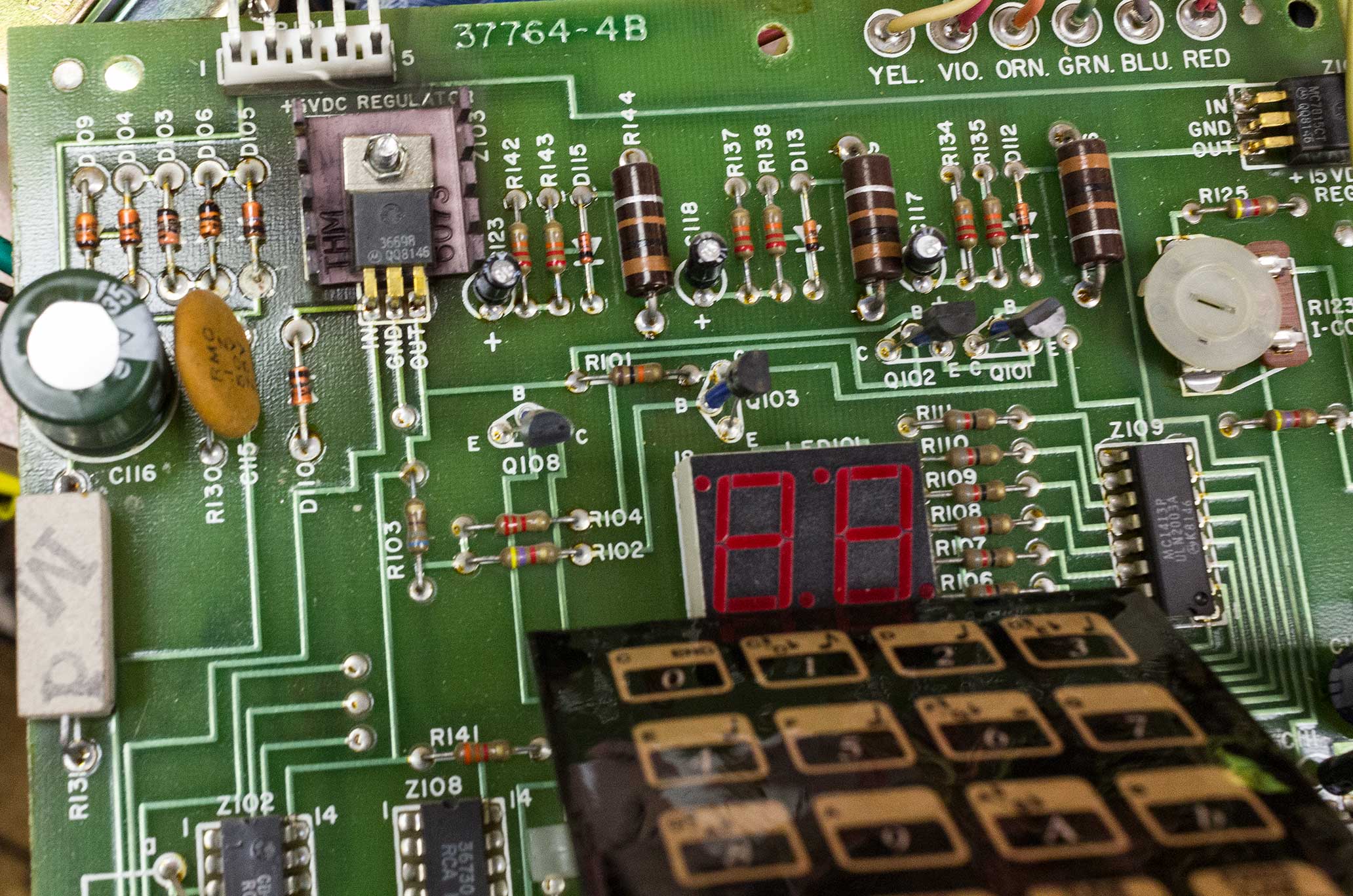

          Re: "Weird Device" : Nutone Door Bell LA60
          What about the charcoal in the top right corner of the first pic?
            that was the first thing i noticed and thought perhaps the 5v had died. or maybe the heat from over 30 years had done it. that 5v regulator is regulating from ~22v after all.
              • 31277
              the circuit has been modified,
              the charing is from the 5v regulator using the pcb as a heatsink (poor design)
              it probably needs resoldering.

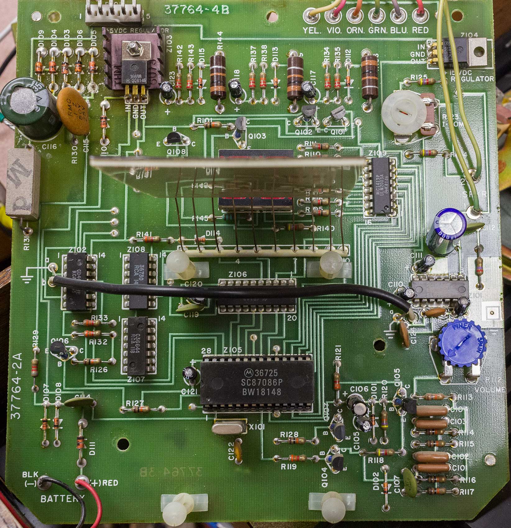

                i really should have taken pics of the front, too the regulator is on a small heatsink that seems to have a solder pin on the back.
                i'll grab a pic of the front tomorrow.
                  pics
                    put the scope to the lead on the cap and i saw a sine wave that is somewhere around 1 cycle every 3 divisions at .1us, that would be about .3us/cycle = ~3.5mhz? my scope is really old and uncalibrated, and i said .3us, but it appears to be slightly faster, so it appears the crystal is working.

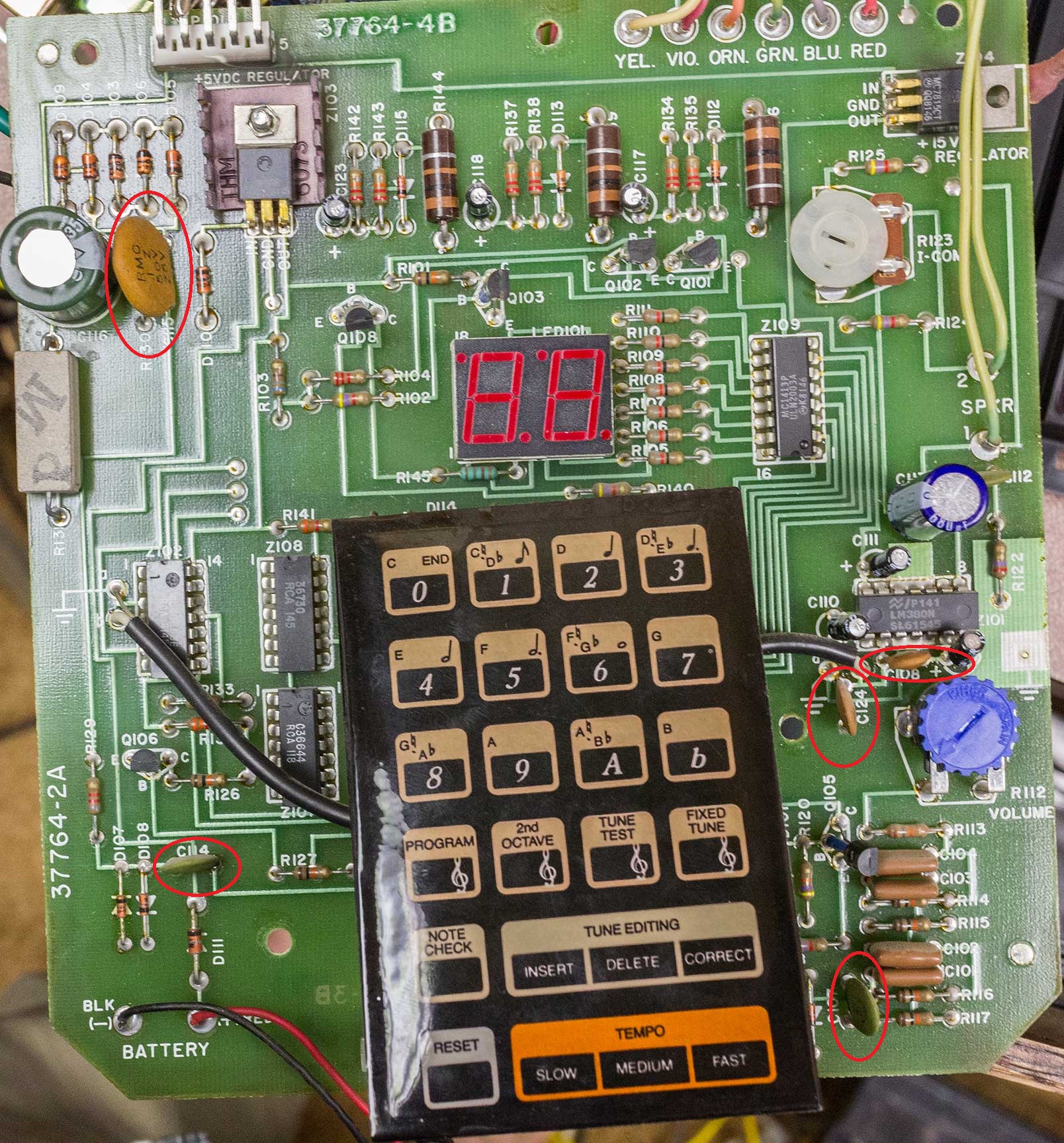

                        So on the two pictures I have mark up potential problem. The top board has a bunch ceramic disk caps and one surge protector. These caps are to low in the board and they have to much stress on the leads. Often times these caps will crack inside. Sometimes you will see and outside crack. Many times if you go to desolder these then they will split. These caps are made to be up off of the board this then will put less stress on the legs and when heated to soldering temperature they will not crack. The back side I have marked points were they leads are bent to another pad. This should be verified on the schematic to find out if it is suppose to go there. If you post the pictures of the scope then we can have a look.

                          ^ If you look at the boardview on the PDF, that mod on the bottom looks to bring an older revision of PCB to match the newest.

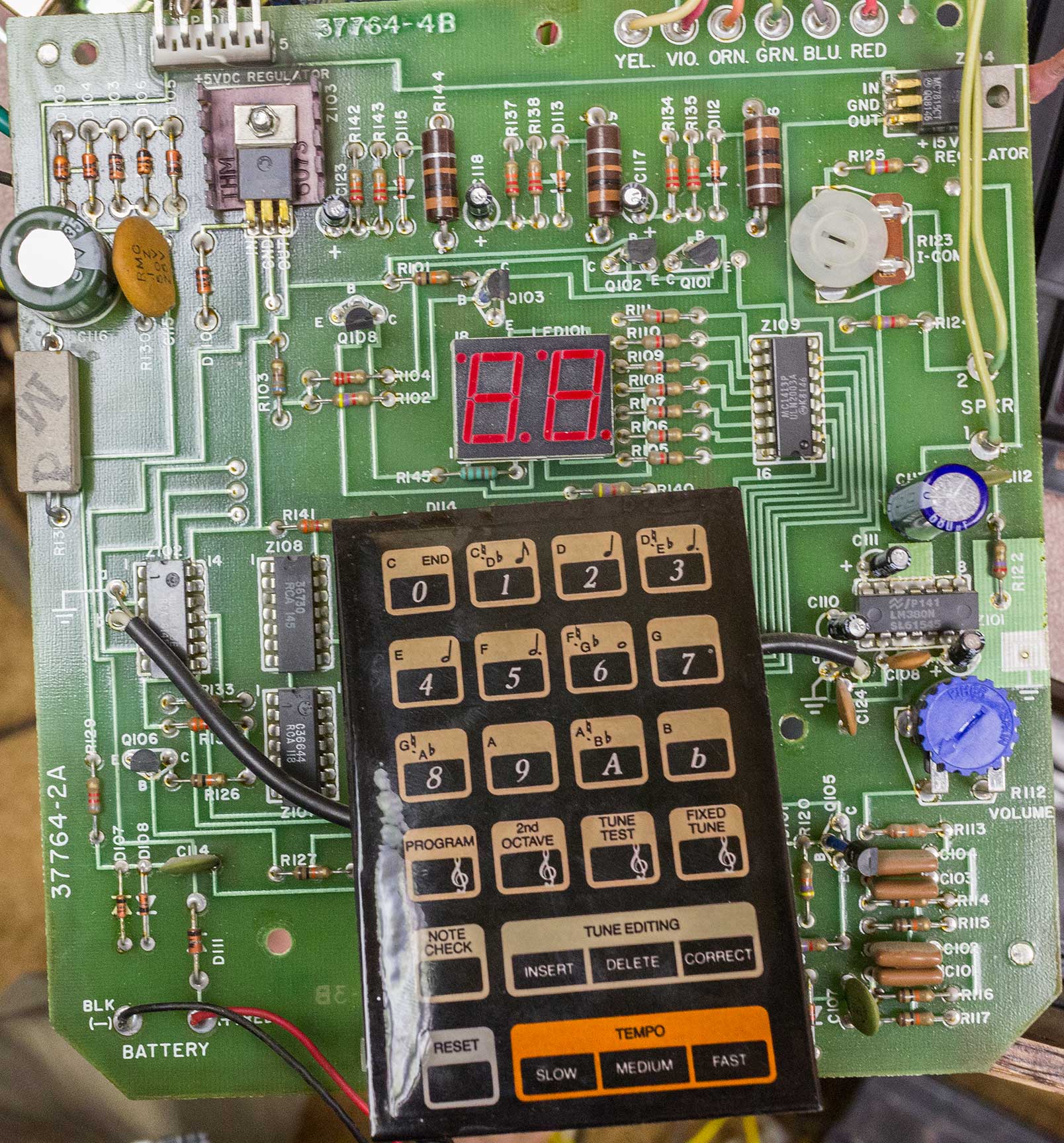

                            BTW, the Volume pot R112 is set to full counter clockwise. Did someone adjust that pot?
                            Also check the R123 pot, it looks like it is also set to Full CCW.
                              i did adjust the blue pot, but did not touch the white one.
                                If the Volume pot is set to FCCW, then you will get the sound that is fed to that pot due to the wiper of the pot is at GND.
                                        this doesnt really make sense. z105 controls not only the sound, but also the display. the display will show numbers (not always the one i press), seemingly never a few of them, such as 8 and 0 and a few more. this could be a bad keypad, but then why is it when i hit the test button the display does not go blank like the manual says it should. (test button works confirmed by measuring resistance between 5,6 on keypad. this makes me think either only part of the z105 is dead, bad socket as stj suggested (how to tell?), or z106,z107,or z108 causing problems though this would make me wonder if it would stop z105 from playing the default chime on power, assuming it does in fact do this by itself.
                                        edit: just tried shorting keypad pins with a bit of wire. 2 and 9 are '0' and 4 and 9 are '1'
                                        whenever i short 2 and 9, i get '1' or '3' most often random, never '0'. but shorting 4 and 9 almost always gives me '1' as expected.
                                        i also noticed that pin 12 on z106 has 3k resistance to +5v while powered off? found this while checking to see if any buttons were bad.
