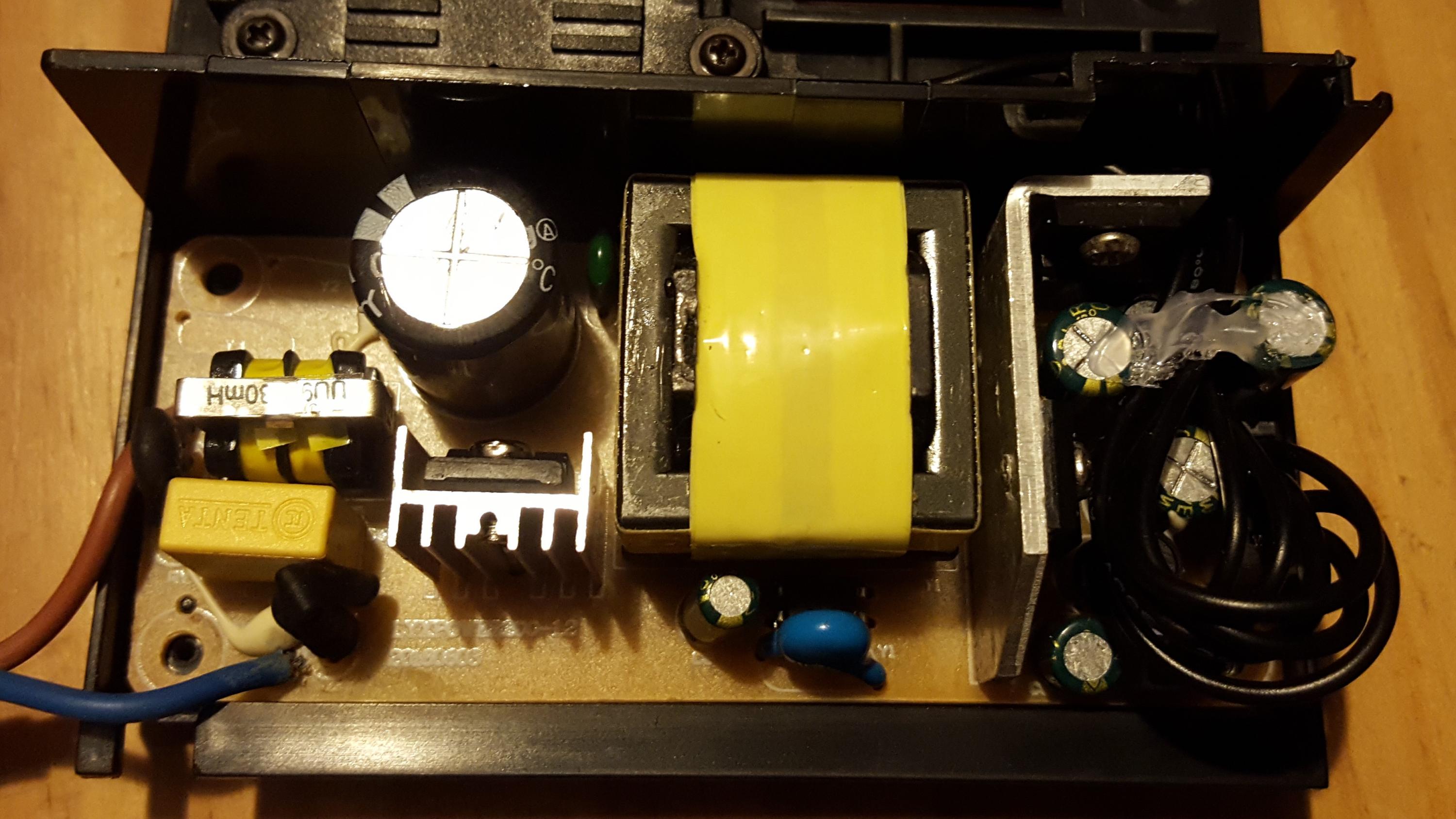

    Hi Guys,
    I have a nyko databank that allows a 3.5" HDD to be used with a PS4.
    The thing has stopped powering up any HDDs (the HDDstill works in a PC)
    I have traced the issue to the 12V power supply. when sitting idle the power jumps all over the place as in this video:
    https://youtu.be/7jh1wkTOnXQ
    You can hear the beep when i switch it on but then the voltage reading goes nuts.

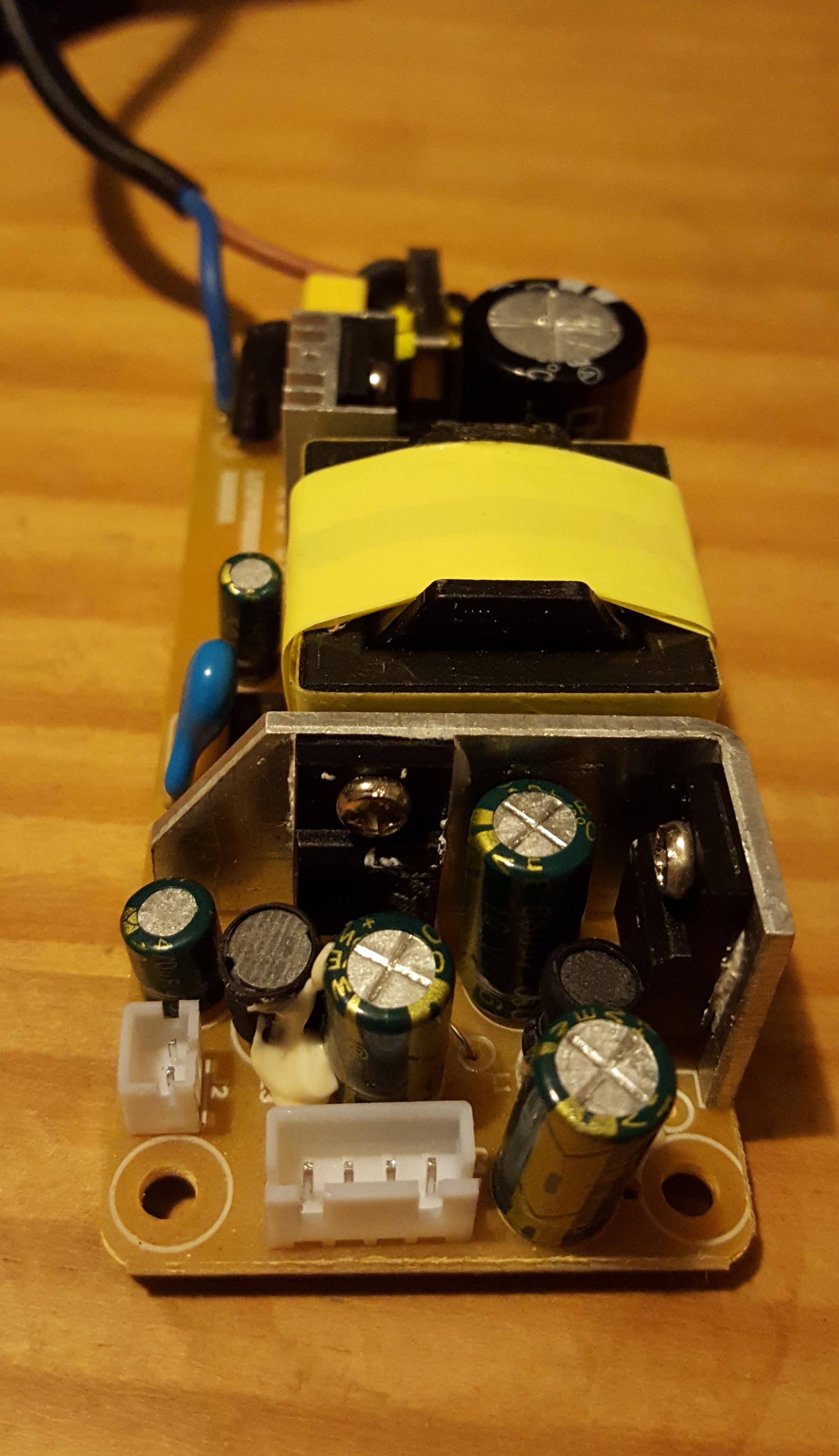

    The 5v comes from the console but plugs into the smaller white connector on the power supply (either to switch it on or just allow the 5v to pass through to the larger connector where both 12v and 5v run up to the sata plug)
    5v seems fine: https://youtu.be/xQZaVRKtNks
    The soldering quality is also not so good with a lot of joints that will at least need a reflow to make me feel happy. It also contains Jwco and Chong Capacitors that I should also replace if I want this thing to live a long time.
    Everything else looks ok, i'm not sure where to start on this one.

    Well it could be as simple as the caps are gone...
    Try heating it up to 60°C or so and see if it behaves better.

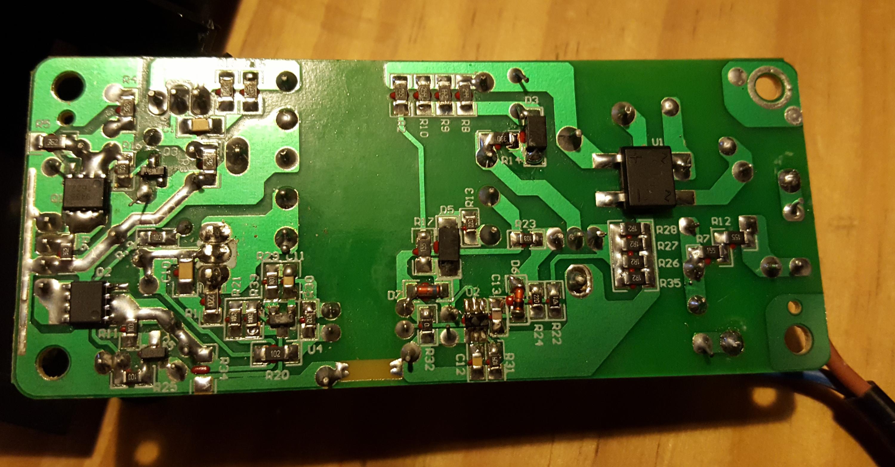

                Well a disappointing update.....
                I started off by replacing all the caps with Panasonic ones (what was on there were crap so worth replacing anyway) and re-flowed all the bad soldering.
                and it still does the same thing
                As the 12v only goes haywire once the console is turned on, I'm thinking there is something faulty that runs off the 5v it receives from the console (5v goes into the smaller of the two white connectors)
                I'll have to try and trace it out.

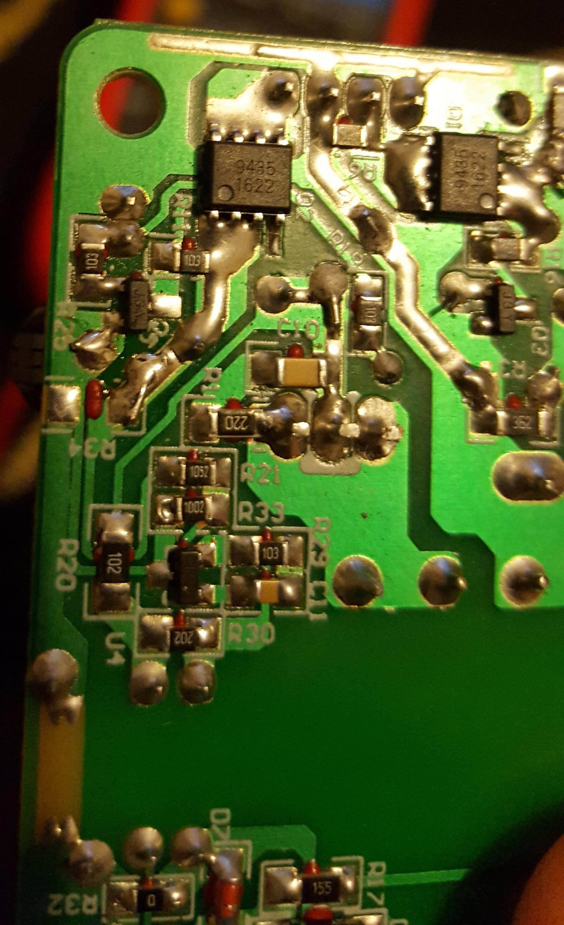

                      What is the part number of the two surface mount ic chips 8 pin ones on the back of the board ?
                      It is hard to tell from the photo but it looks like one the 3 pin surface mount ic chip looks like it is burnt on the low voltage side of board in the photo if this case that would explain the problem your having
                        Hi Sam,
                        The part numbers on those 8 pin chips are 9435 1622.
                        Yeah that 3 pin ic had some sort of flux or something on it that wiped off. it looks ok to me, i'll upload another pic of that section of the board.
                        I think that may have also been one of the joints I reflowed that didn't look too good.
                        This is pretty much where i'm up to. trying to google the numbers on the IC's but not having much luck so not 100% sure what each pin is.

                          I think I found the problem.
                          one of those 8pin IC's is shorted. I'll remove it and test to be sure.
                          looks like these mosfets are it: http://au.rs-online.com/web/p/products/6710750/
                          thanks for the tip in the right direction.

                            I thought that the way the part was lay out on the board that it might be a MOSFET and if was that might be the place to look at

                              Re: Nyko Data Bank for ps4 not powering HDD
                              gah this thing is anoying....
                              yes one of those mosfets was shorted, and no, replacing it still hasn't solved the issue
