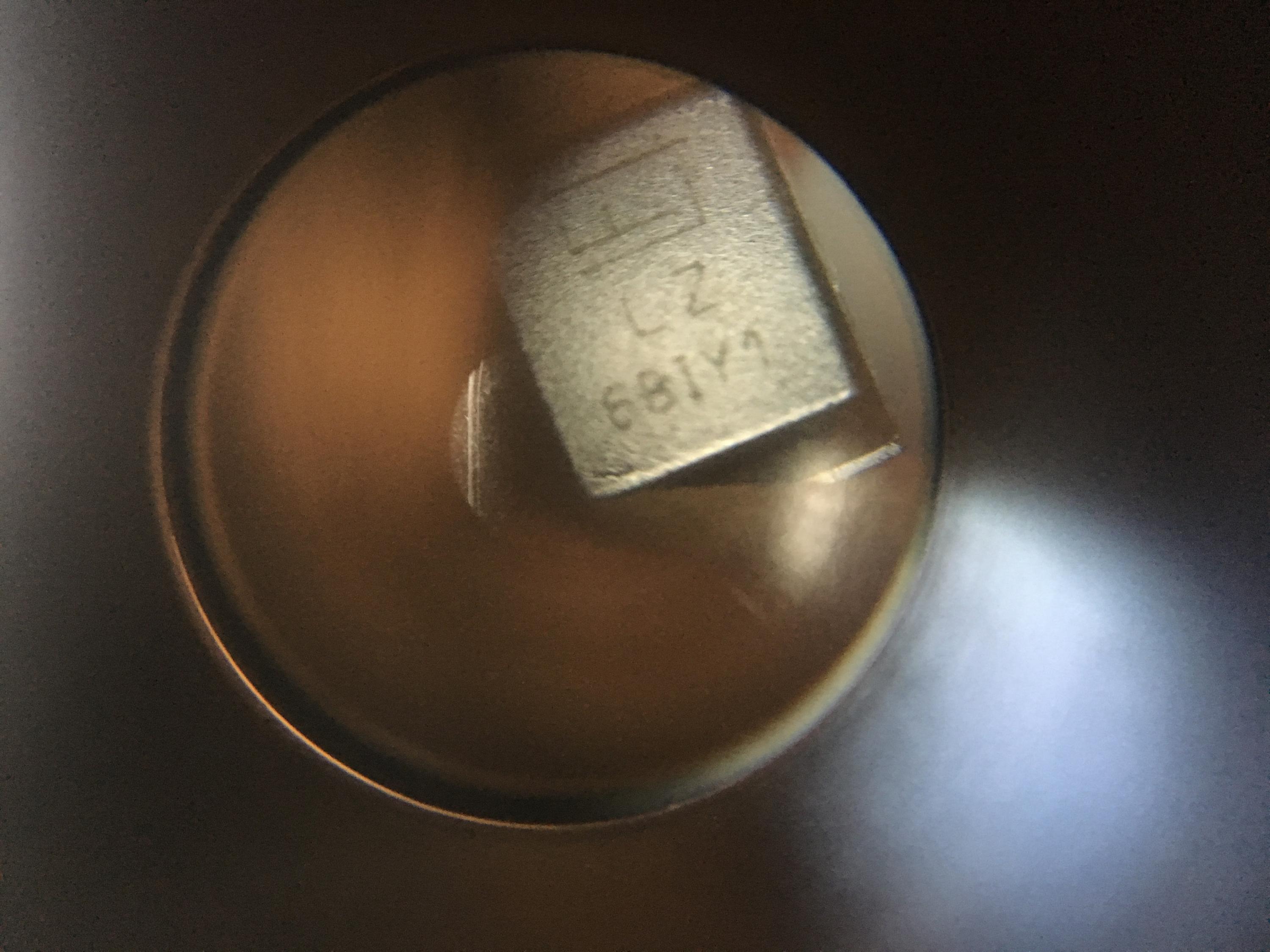

    i toasted my unifi ap lite by mistake.
    then i found out there is a diode build in to prevent the cirucuit from overvoltage. i soldered out the diode and the ap is working again.
    but i want to replace the burned diode and can't finde a replacement part.
    can anybody help?
    see attached foto for the component. thanks for any help
    • 31199
    Re: Unifi UC-AP-LITE recovering from 48V POE Mistake
    tvs diode - probably 24v
      Made by LittleFuse (LF marking)
      LZ: 24V UNI-DIRECTIONAL
      PDF page 45
