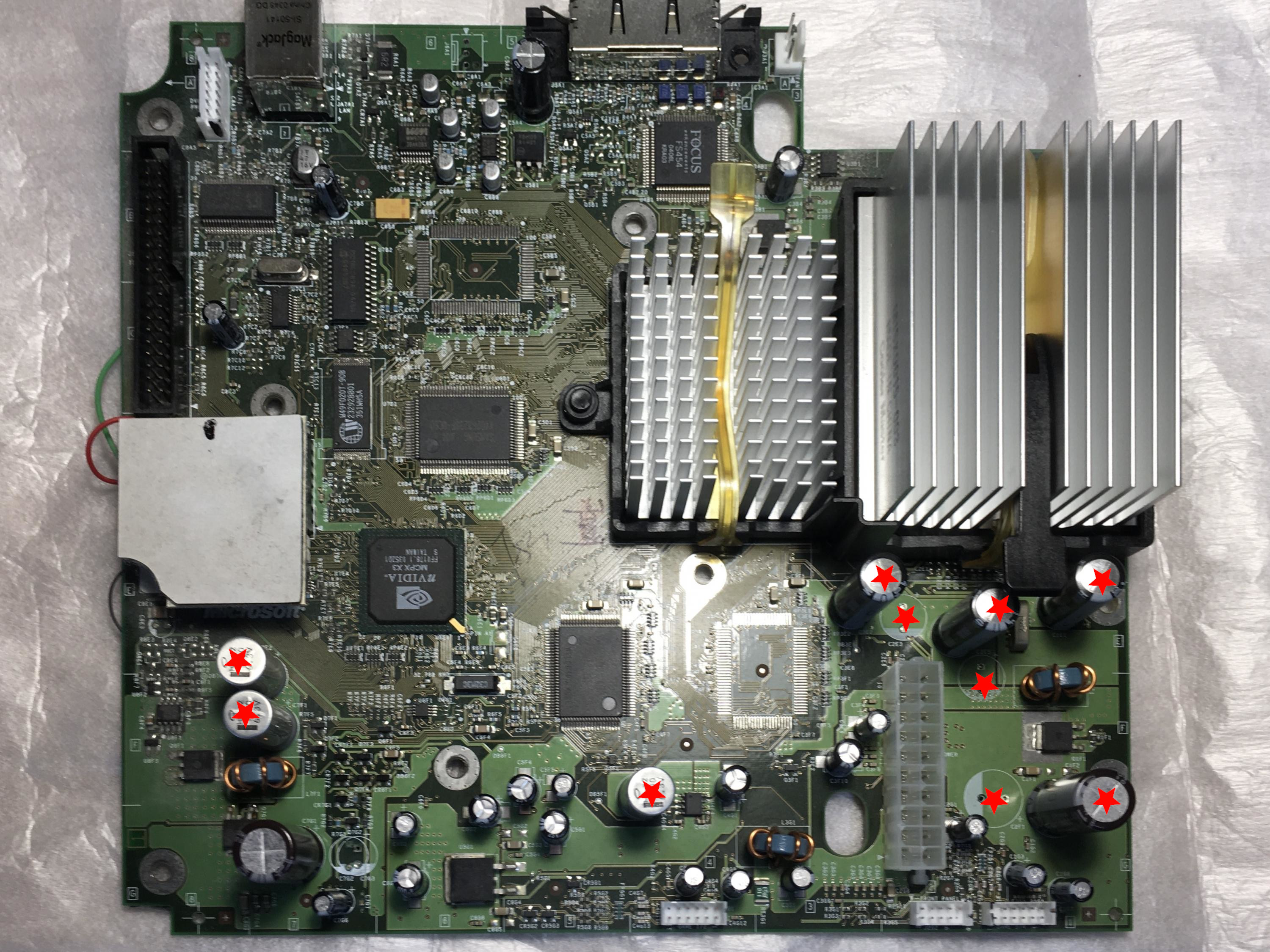

      Hi ya stj
      I've been having problems with the stability of the screen on my Xbox particularly when running XBMC and notice that the three next to the CPU are bad.
      I bought the ones in the link you posted and they have just arrived. I know very little about capacitors but I'm confident I can replace them. Could you help with a couple of questions please? I got ten of them in the package so can I use the excess capacitors on the board and where? And please just confirm for me their orientation.

        #103
        Re: Original Xbox Replacement Caps
        orientation, the long wire is positive,
        the painted bit is negative,
        so the painted bit goes to where the stripe was on the old cap.
        other question needs a pic of your board - there are 6 different ones

          #104
          Thanks for getting back to me, appreciate it.
          Here is a photo. Sorry not the best but I'm not anywhere my xbox at the mo. If this photo is not good enough i will have a better one tomorrow.

            #105
            Better photo.
              • 31137
              #106
              which polymers did you order, the 1500uf ones?

                #107
                Yes, that is correct.
                  • 31137
                  #108
                  then the picture in the last post is good to follow
                  soldering those boards needs skill btw.

                    #109
                    Thanks stj, I've already replaced the three by the CPU and the problems I had are now gone. Thanks so much, I hope I get another 10 yrs out of this classic console.
                      • 31137
                      #110
                      well remember to fill the 2 empty spaces - the cpu really needs 5

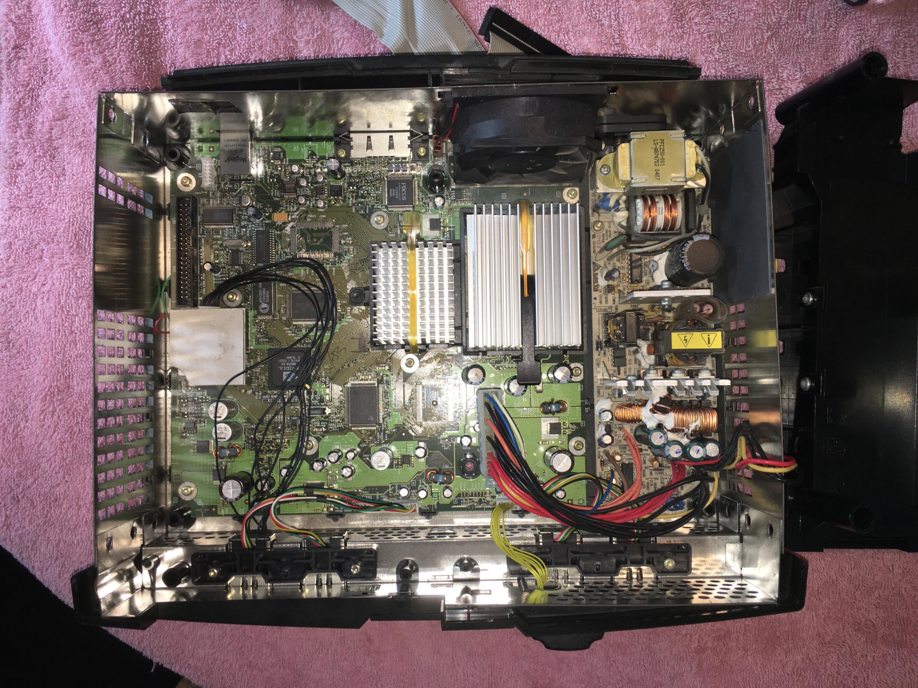

                                  • 31137
                                  #116
                                  the sanyo's are probably just a bit old - and with short legs.
                                  short legs is a good giveaway that they are surplus from a production line because they are fitted by robots.

                                      • 31137
                                      #118
                                      6.3v
                                      terrible lifespan!
                                      • jayjr1105
                                        • 281
                                        #119
                                        My power supply is a foxlink, should I replace the 4-5 teapo's in it? I think they are mostly 2200uf 10v
