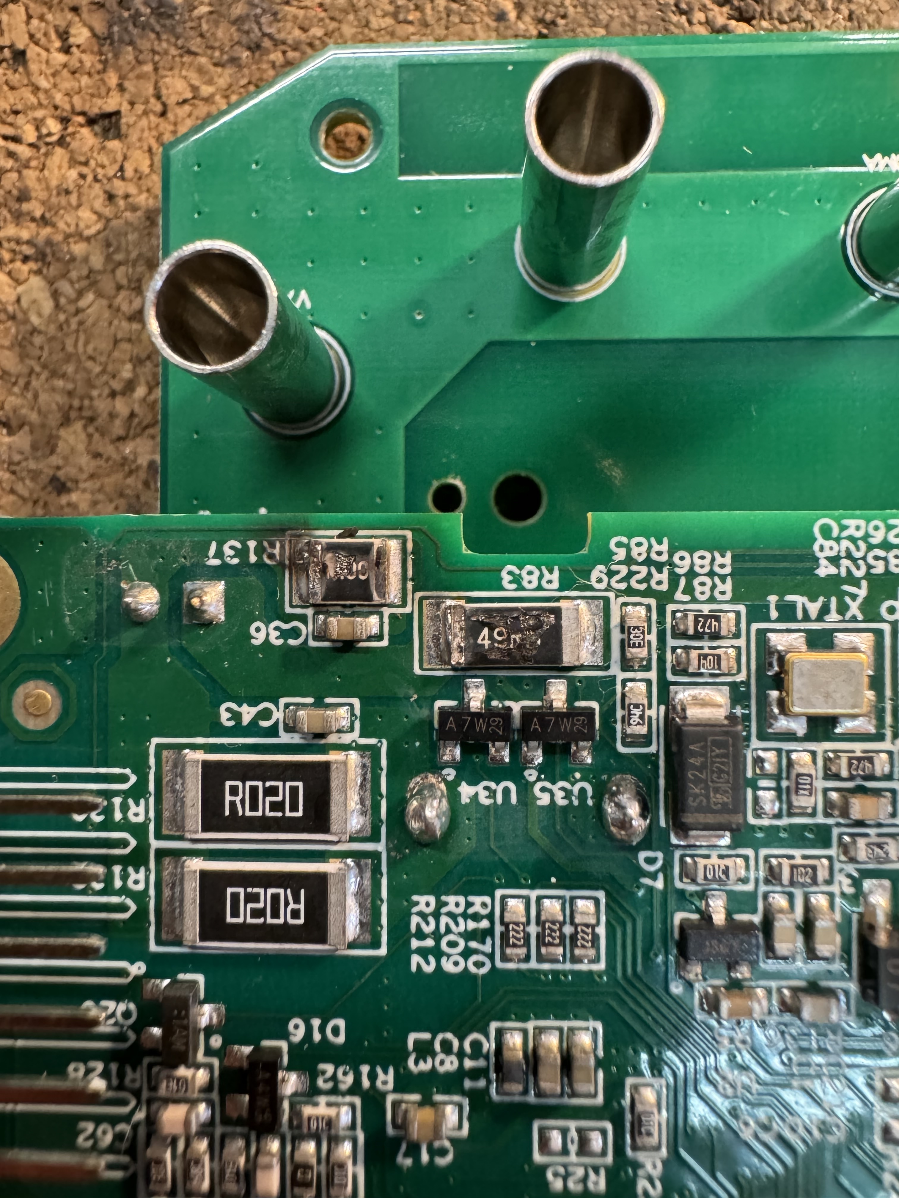

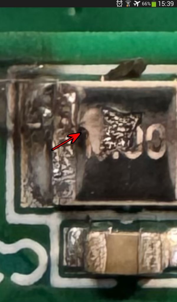

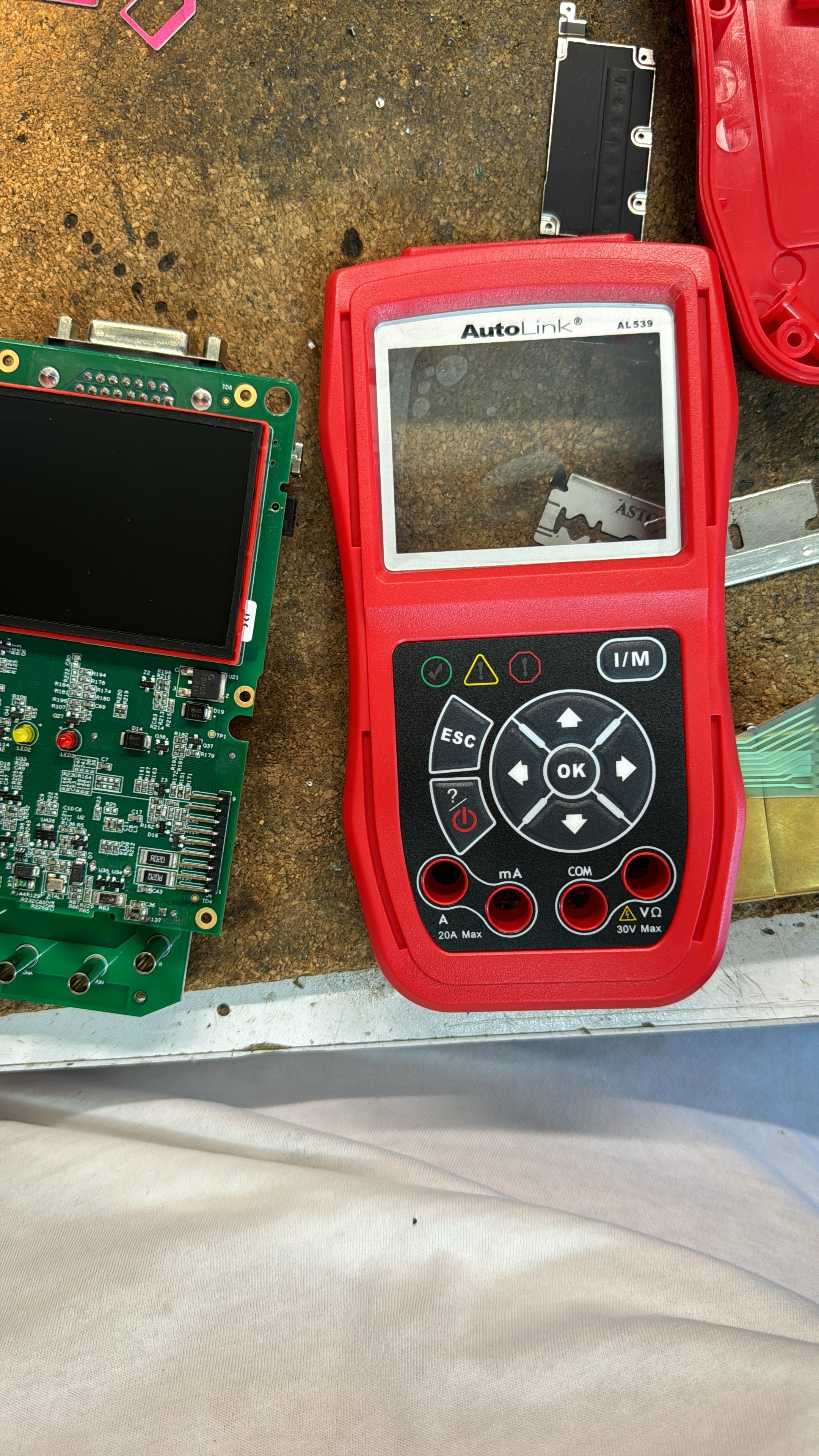

    Could someone help me identify the two rezistors burnt inside this AL539 device from Autel, i cannot find any dissembly pictures and there are a lot of these devices, i hope some of you have it 🙌

    One is probably something very low ohm like 0.1 Ohm because it is voltage supply and also acts as a fuse and the other is 49.something Ohm.

      Try to see as hard as you can get, if the first letter have "latch" like "1"... then very very carefuly and slightly gently whipe up once and see if it revial any more information. Be sure that burned paint is very fragile so on any attempt to clean it may go off. I will use first light brush with ipa, and future with more and more force. It may be 1R00 or R100 on it. The second resistor is 49R9 marking.

          sooooo.........
          why did it burn?

            Plugged into the OBD connector wrong?

              maybe set up for amps then connected across car battery

                I got it like that …
