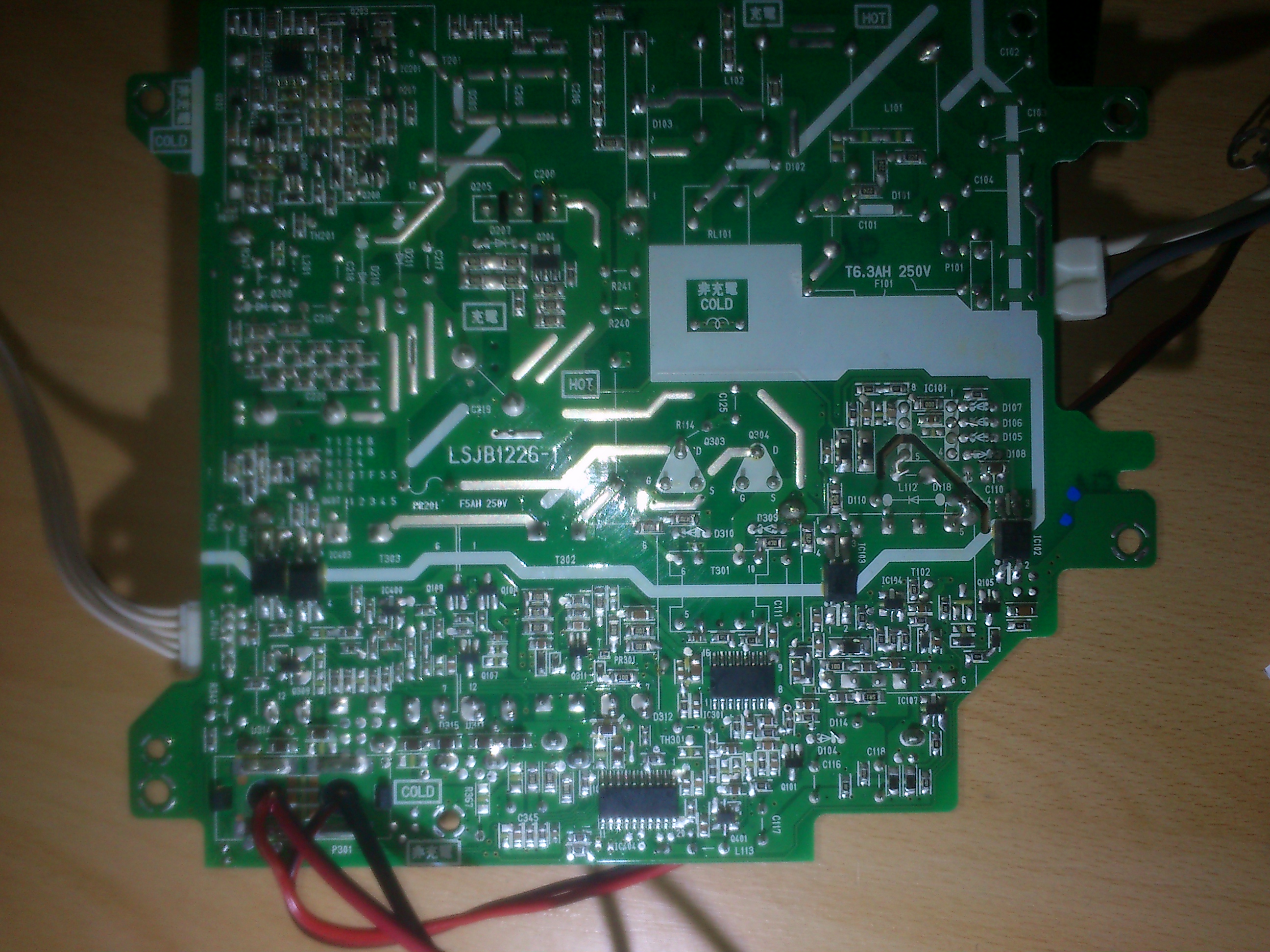

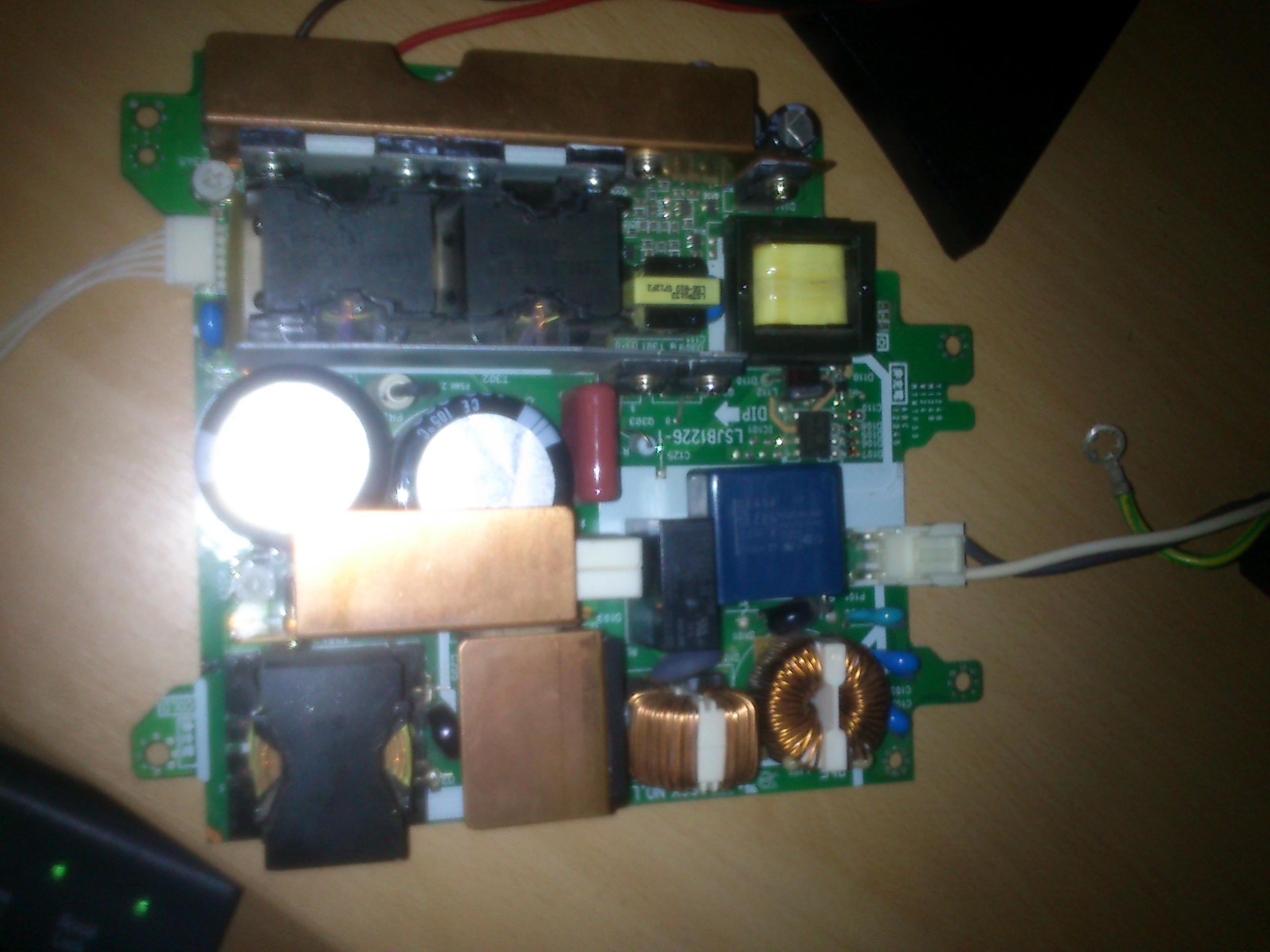

    I have another PS3 power supply LSEB1226B1 model.
    Some time ago, I have successfully modified output from 12V to 13.8V
    https://www.badcaps.net/forum/showthread.php?t=33197
    With help of members,it was really easy to do.
    This supply is a little bit different, there are four photocouplers just like APS-231, but I did not find three pin regulator which is connected to "12v reg" photocoupler like in APS-231 model before.
    Please see the pictures.

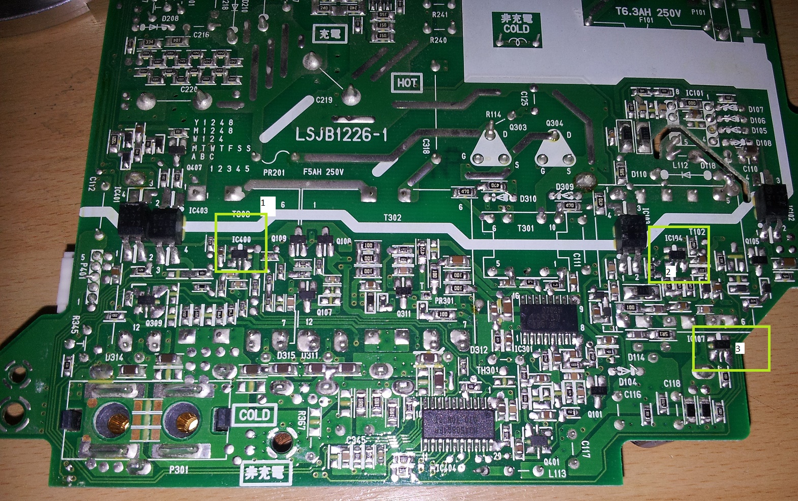

    Two chips are M34509G4 and LSSK87
    first one is SINGLE-CHIP 4-BIT CMOS MICROCOMPUTER,wtf?
    http://www.datasheetdir.com/M34509G4+download
    it seems that this is some kind of PWM..

          what's the ajuster in the top-left?
          • m111920
            • Nov 2013
            • 49
            • Croatia
            Re: Another PS3 PSU mod
            It does nothing
            Here is some update:
            IC markings;:
            1: TD
            2: TAIG
            3: 3418

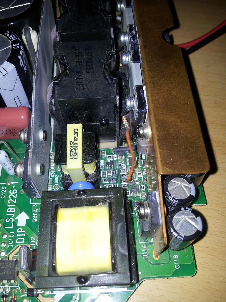

              Found it
              it's on top side of PCB, now from this point, we need huge resistor, more than 100K ohms and connect it between this point and ground, voltage will rise till about 15V then OVP kicks in.
