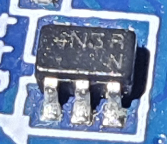

Hello, I'm repairing an old mini-PC Gigabyte Brix. I found a photocoupler wich seems dead. On the top of this SMD 6 pins component, there is wrote : 4N3R. I found 4N3 serie datasheet but I can't found what's mean « R » for find similar. Could you help me pls ?

Here two pictures of two components on the board. It's « R » but maybe should be read verticaly RN ? I found a lot of same chip 4N3 but nothing with R.Attached Filesif you find these attachements useful please consider making a small donation to the site

It is a PJ4N3KDW The "RN" is a date/mfg code It will be different between parts, (ie:47).
30V Dual N-Channel Enhancement Mode MOSFET - ESD ProtectedAttached Filesif you find these attachements useful please consider making a small donation to the site

Ha yes, you are right, it‘s this mosfet. I dont understood first what a photocoupler did on the board of this mini pc with Celeron and with a very small external 40W charger ? But I found AN4 photocoupler datasheet and pin 6 was unused and matched with the open line measured. Wrong way.
PJ4N3KDW is hard to find, I tryied to find equivalent onr. And I found 2N7002DW
https://cdn.badcaps-static.com/pdfs/...ff6e1b23aa.pdf
with same pins, same internal schematic and could you help for these specs pls, it's equivalent ?

It looks close, Can you get this: SSM6N15FUAttached Filesif you find these attachements useful please consider making a small donation to the site
