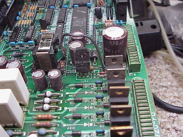

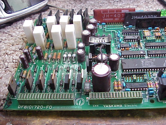

ncc lxf on yaskawa ac servo
  • kc8adu
    • Nov 2003
    • 8832
    • U.S.A!
    looks to be an isolated failure.
    not unusual to see all the towa caps high esr but these big beercans are usually ok.
    looks like this unit and the other 2 axis will get a total recap.
  • japlytic
    • Oct 2005
    • 2086
    Re: ncc lxf on yaskawa ac servo
    Towa is now owned by Fujitsu-Towa - Towa is Japanese, so it should be a good brand.
