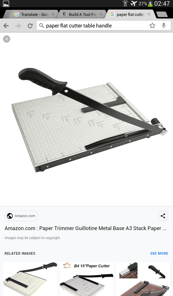

      Is there any reason to engage lots of electronics and fancy stuff to obtain just bare mehanical job?
      Design may follow same principes, with materials from scrapyards, but powered by pushing handle of that lever mechanism by hand... I dont get it... it will be even better because it is hand power cant discarge.
                The issue I have building a mechanical system is that first of all the starting point and stopping point would not be consistent enough for me and would be difficult to achieve with out a lot more time to design it and test it and you still have to make the sharp small blade width so that you do not damage the the heat shrink tubing that is on the battery cell which if does not starts just below the top of battery terminal and stops just before the bottom of the battery terminal then you are more likely to damage the heat shrink tubing but honestly I did not even consider doing mechanically until you mentioned it in your post that is why I did not comment about your post until now because I really thought about it and I appreciate your comment about it

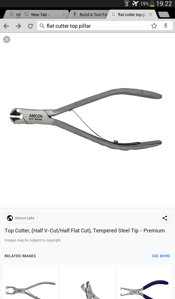

                    If you have jobs of large quantity the some machine is necesary, but if you have a couple bateries ocasionaly you can modify flat pliers with grinding away to needed shape and dimension.
                      • Jul 2011
                      • 6057
                      I will have to try this idea when I find a pair of this type of cutters again I have to remember where I saw this type of cutting pliers before
