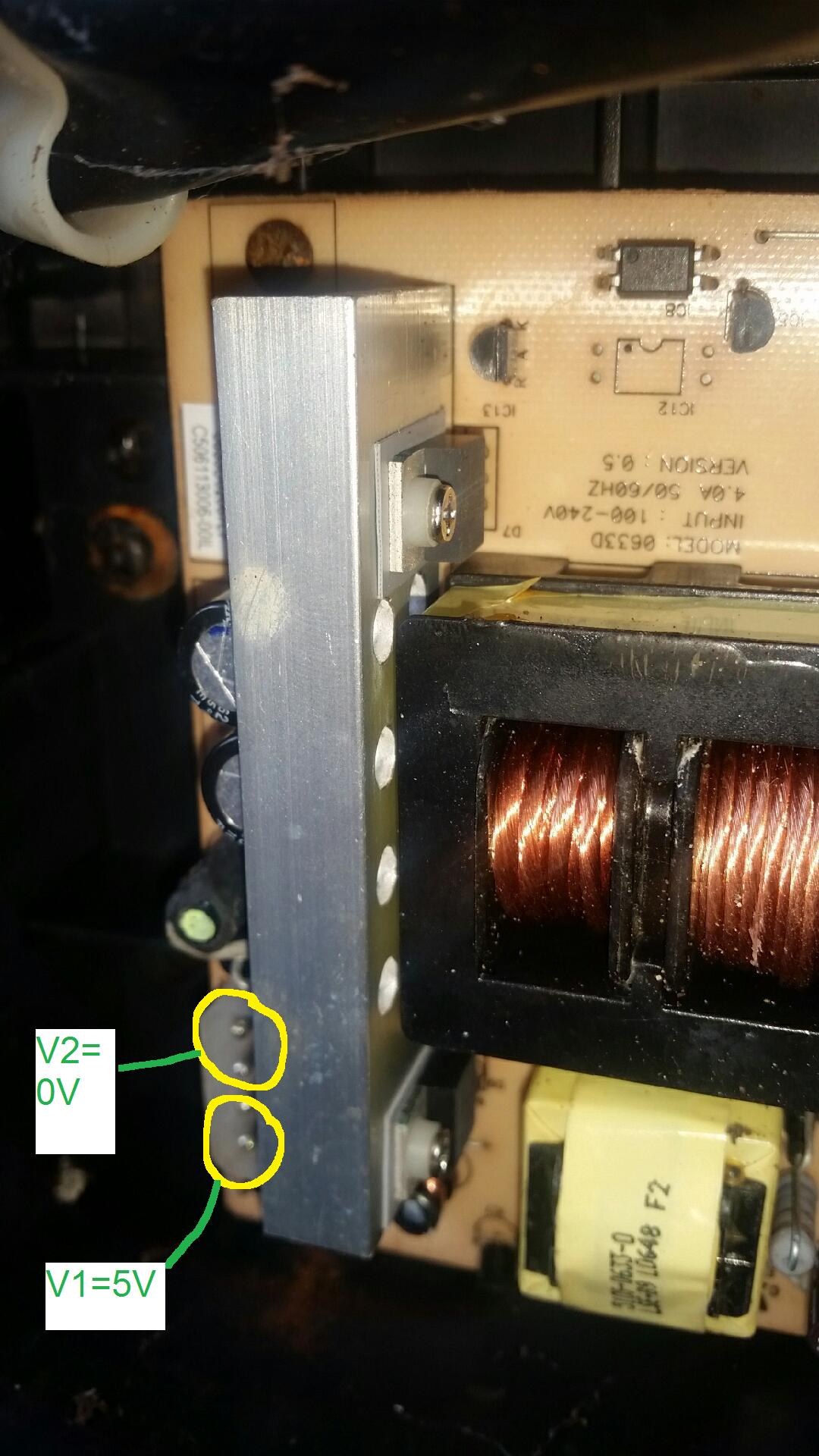

    hi
    i am troubleshooting an old carvewright cnc machine
    it powers on fine but when i test x y or z axis none of the axis will move and i just get axis stall fault
    the history of this machine is bad..it was stored in a shed for about 15 years..its in bad shape lots of rust
    i have been working on it mechanically for 2 days..li have gotten it all freed up and mechanically its all good
    as i said it power up fine .and everyhting seems to function fine other than the x y z axis servo motors not powering on at all......i have dont some narrowing down to it being a controller board signal or power issue
    today i think i narrowed it down to power issue...on the PS there is a output voltage harness with 2 diff outputs...V1 and V2
    V1 tests at 5V ..i assume that is the voltage that supplies the main board and lcd panel
    V2 tests at 0V...i beleive this is the servo motor power but not sure
    there is one more voltage output neat the 100v input and that goes to the cut motor...
    this is a proprietary board..not avail to buy anywhere..no schematics...carvewright company will not assist...this machine was made in 2006 however according to the hours used in menu option it only has 1hr and 20min use on it..
    im hoping someone can assist me why i have no voltage at V2 output
    the V1 and V2 both go to the the controller board.

    Re: Power supply board missing voltage
    wondering if it might use those corroded ground connections .

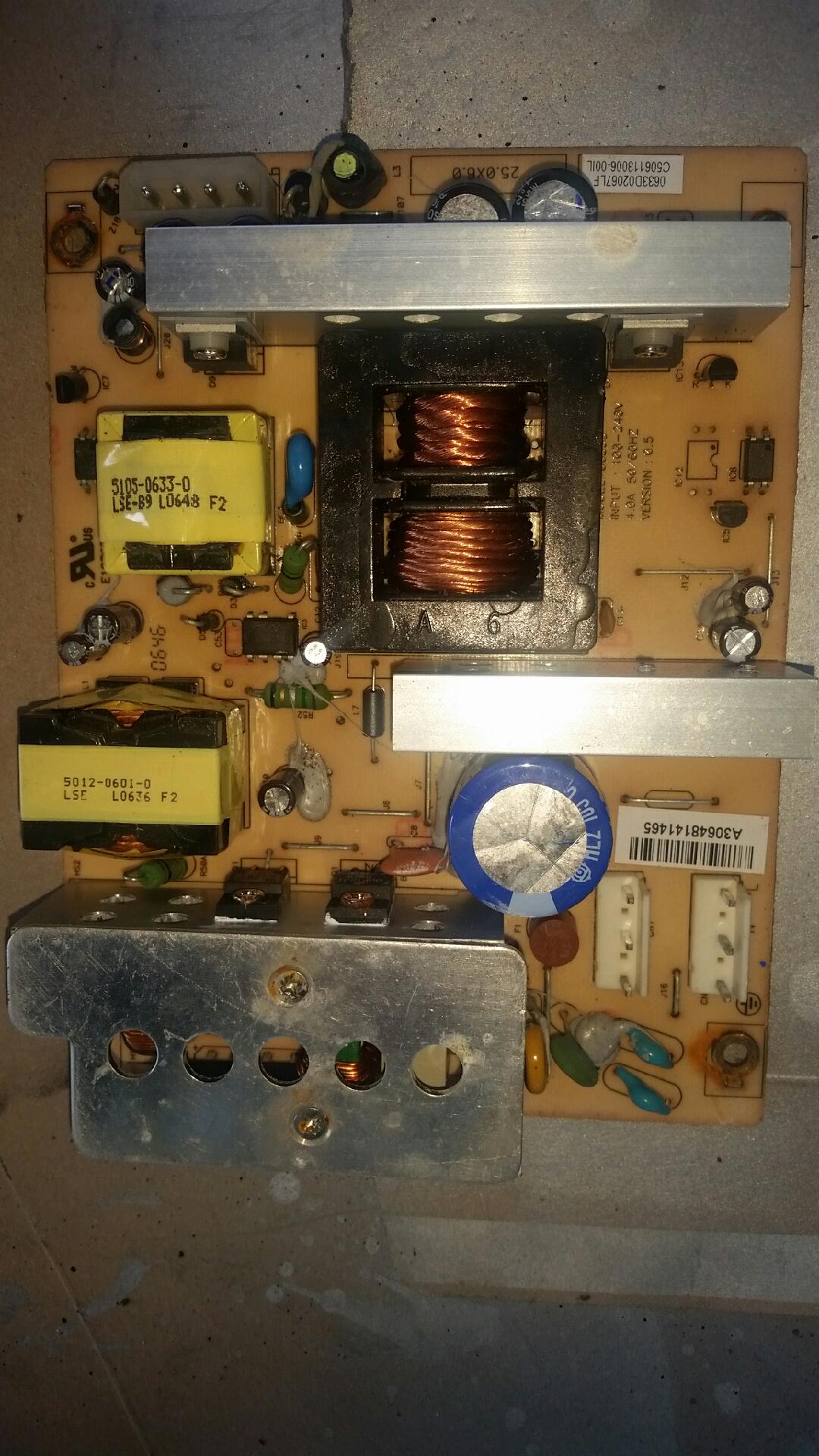

      More pics

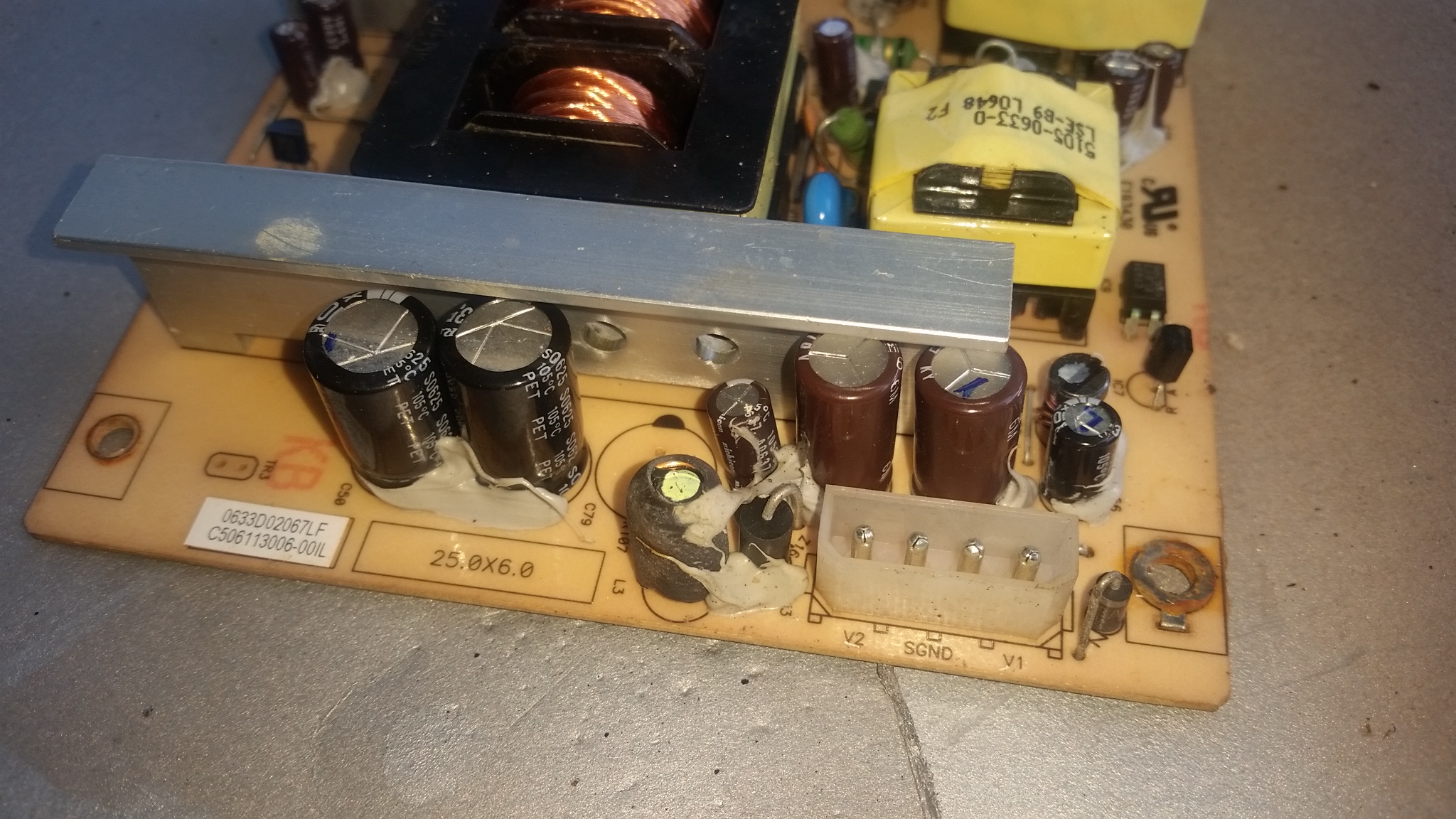

        i use isopropyl alchohol to clean it up best i could..and yes there are several corroded areas on the board...the board screw mounts just screw into plastic framing of the machine not metal.
        im thinking its something simple since the machine only has a little over 1hr run time on it...its old but was never used..just left out to rust to all heck,,,im trying to save it...
          • 31161
          change the small capacitors - anything 100uf or less.
            thanks..none are bulged and the power supply only has 1hr use on it so none of the components should be bad
            just wondering if corrosion or high humidity affected any components from sitting in shed for many many years
            the power supply is located on the bottom of the machine so its probably less than 3/4in from the ground..so its possible that when it was stored in was submersed in water at one time but thats just a guess
            the machine is pretty rusted at the bottom about 1in high
              Based on the rust that is on the screws, I would check all connections that also have rust, like the transformer pins themselves, the standby supply (5v) seems to be ok, it is the other separate supply driven by ic2 that is not working.
              Also check the voltage across the main filter cap, this power supply seems to have a pfc circuit, so this voltage should be around 160vdc in standby, 385vdc when working.

                  Ok I see a lot of pins on this board that have a rust color on them this is what I would highly recommend that if you are going to reconditioned these machines if we’re me I would first buy a Desoldering Gun something like this and learn how use it correctly before using on a board that is not replaceable
                  * https://www.mpja.com/Desoldering-Sta...info/19034+TL/
                  https://www.harborfreight.com/12v-li...nly-57735.html
                  https://www.harborfreight.com/1-in-s...kit-61562.html
                  I not trying to sell you something that you do need but if you going to keep rebuilding these old boards and do not want to keep using Disordering wick and possibly of tearing pads of your boards this is why I would highly recommend that you make an investment in one of these Desoldering Guns
                  This is what I would do first if I was repairing this board desolder every transformer on this board very carefully and clean every pin with a green scrubbing pad you can also get it in pad disk as well and then put them back on the board do them one at a time
                  Then I would replace every single capacitor that 100uf and less
                  I would desolder every pin on each device and look for rust if there is any clean it off very carefully and resolder them back on the board do only pins on one side of a device at a time unless you need to remove it to clean the pins on it
                  I have done this procedure several times on machine controller boards and have gotten back working correctly again but it very time consuming project and you have to have the right type of tools to do it
                  At a company that I use to work for they had battery operated magnet metal pick up for metal plates that became so bad that it would not power ON took it apart and found corrosion on every pin on every device on this board I removed every bit of solder from every pin on every device and put fresh solder on every pin
                  —>this project took about 8 to 10 hours to complete and this was with the tool that I was talking about earlier * this was the only tool that I had at the time I did not have the other tools that I also mentioned earlier
                  When I was finished and I reinstalled everything and turn on the battery charger it powered ON and functioned correctly and they used it for several more years until one of ic chips that was unavailable anymore from the manufacturer and could not be repaired correctly anymore

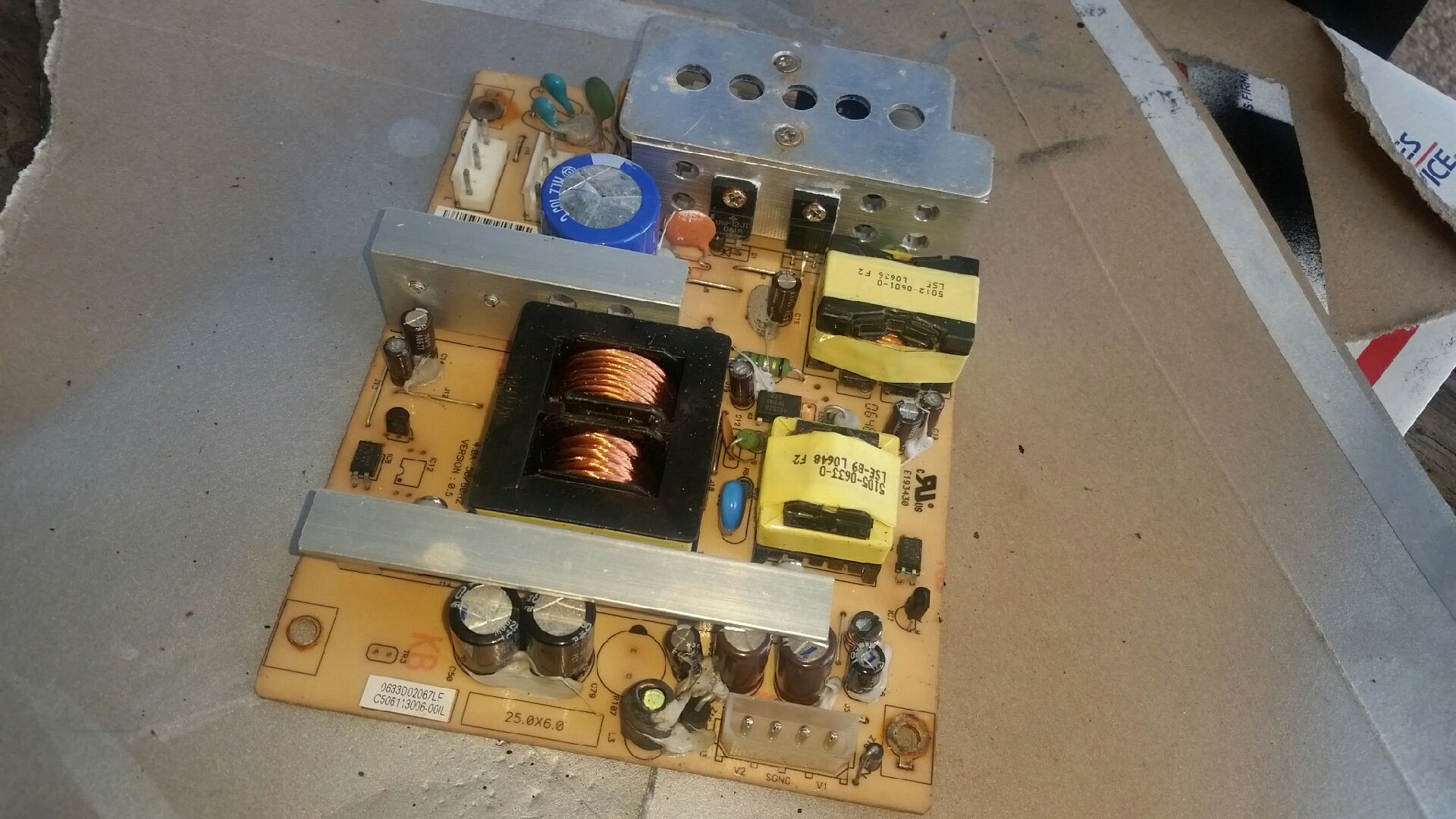

                      Hi samsam..thank you.for your good advice..you are correct thats very time consuming...the biggest issue is desoldering.
                      Im not an electronics guru...just a tinkerer...and for me desoldering lead free solder is a royal pain in the ass....i used to desolder lead solder with an old radio shack msnual bulb sucker and it did fine
                      That will not work on lead free solder and ive never had luck eith lead free solder
                      I do have a dedoldering station but have never used it...
                      Ill look at board over weekend.im only concerned with v2......as i said i do have v1= 5v for controller but v2 voltage is missing
                      If the manuf can tell me how many volts are needed for driver/servo motors i could then just buy a cheap power supply and feed direct to v2 wires.only...that vould be easiest...but i dont know specs of the proprietary servo motors.
                      Can you tell me which caps and transformer supply voltage to v2?...im sure i could trace the circuit...but maybe u can visually see it way easier than me....im assuming v2 is should output much higher than 5v since its supplying power for 3 tiny servo motors...i would guess the large transformer with all the copper exposed may be for v2.

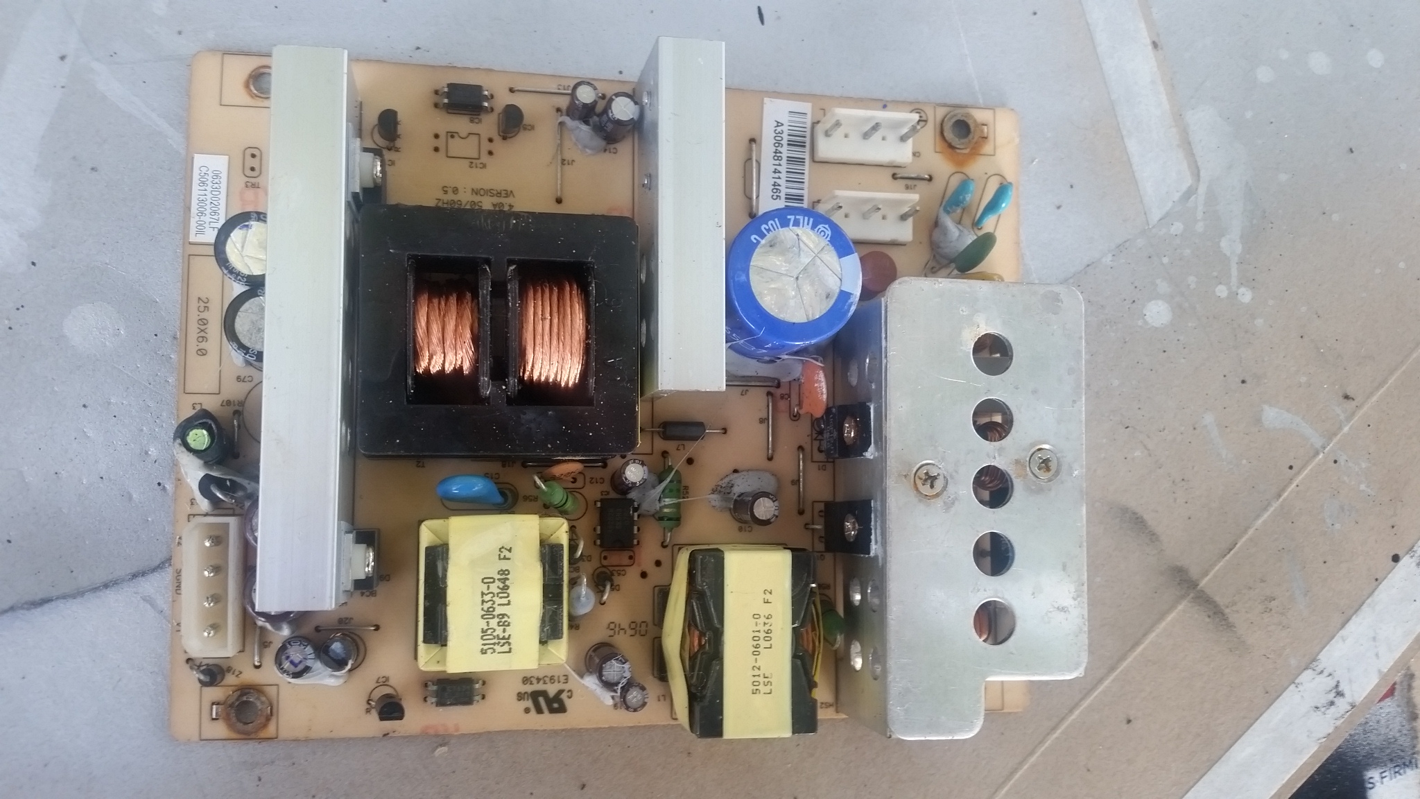

                          As far as why you have NO power to V2 you first need correct the rust issues with the soldering joints first once you have done this then we can try to figure this part later
                          I can tell you from past experience that when I see a board like this the first thing I do is make sure that bad soldering joints are not my issues because you are going to waste a lot of time running around in circles trust me when I tell you this
                          I am not trying to be little you but just wanting to take short cuts to think you are saving time getting it working again is saving time is wrong because it will not save you time in fact it cost you more time and more aggravation in the long run and if you were repairing this for someone it would be costing you money
                          Because I repair Servo Motor Controllers boards for a company that I done this for this company for about 10 years now and several times capacitors leaked out on the controller boards and had to replace all the capacitors and clean the solder traces on the boards and yes it can take hours to do it but once I have done this way I only once had it where it did not work completely correctly but it worked enough that it was useable because this machine had a bad Servo motor and was very expensive to get it repaired and they were not using that function anymore for the time being
                          For this machine to boot up it has to have all axis Servo Motor Controllers in place and power up to work correctly

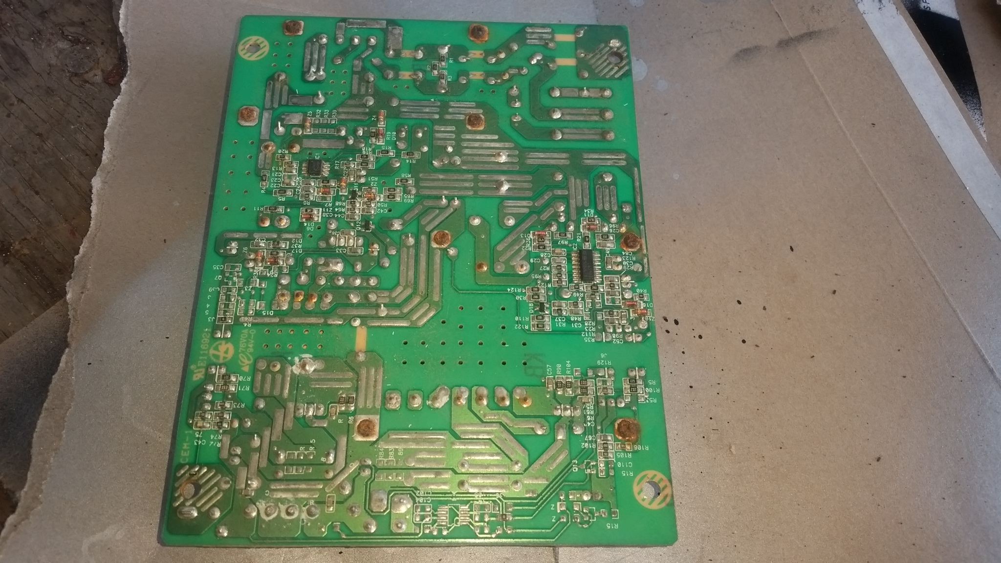

                                Just because you think a soldering look good with out looking through a magnifying glass and not looking very closely at the pins is going to be very misleading trust on this one as well
                                If you see the following redo the soldering joints
                                Cracking or dull soldering joints
                                Portion of pin or pins do not have solder around the hole pin or pins
                                Or you see flux residue on the bottom of the soldering joints or around the pin or pins redo them
                                Or you see white corrosion around the pins then you need redo the soldering joints
                                Or you see rust on the pins redo the soldering joints after cleaning the pins
                                I only do this as a last resort because things can go horrible wrong if not done correctly

                                      The machine has 9hrs power on mode per usage meter
                                      1hr spindle motor on
                                      I just confirmed its a ps ossue...i hooked up 24v directly to main board and now servo motors function
                                      I tried resoldering old ps...no change
                                      Im going to just mount a cheap 24v ps next to orig...its cheapest easiest solition
