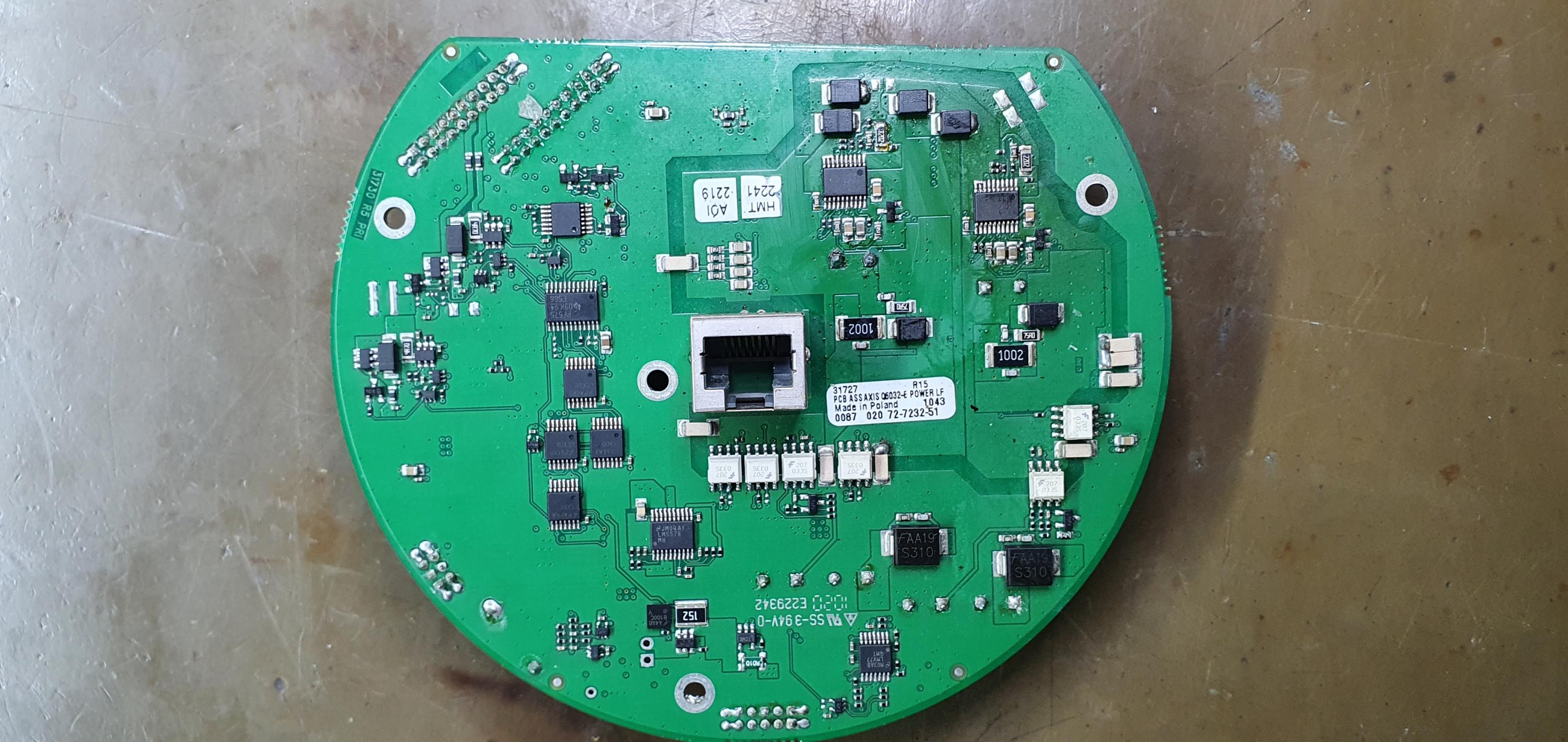

    Good day folks. A friend of mine scored a couple of these Axis speed dome cams which no longer work and asked me to have a look at them, see if I can get it going. He also grabbed 2 POE injectors that used to power them. He said he tried both of them with a functional camera and they work, so the problem is most likely the cameras.
    The problem: no power and no response from the cameras at all. The "activity" LED on the injector also blinks amber and according to the injector's manual, this means overload.

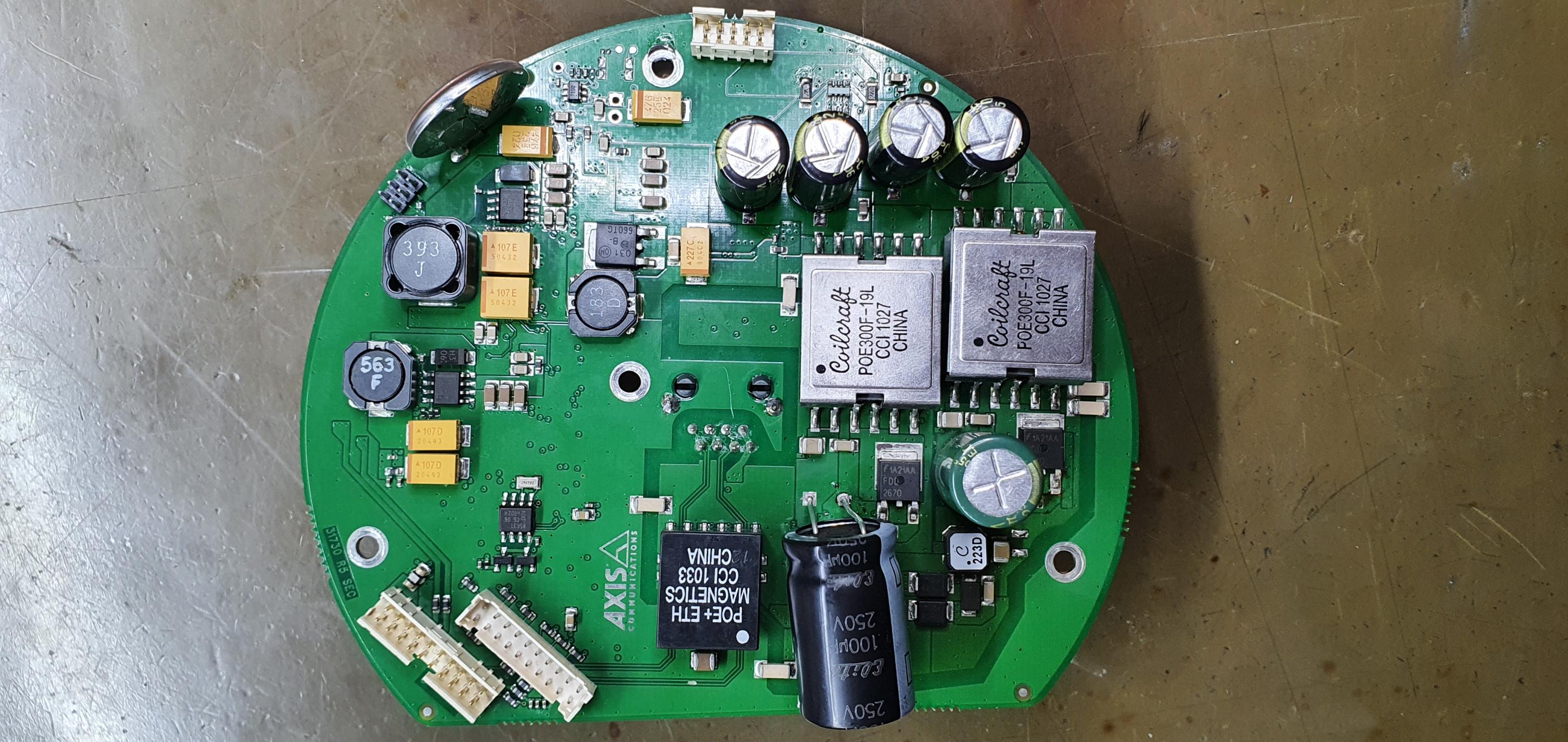

    To cut the story short, I opened up one of the cameras and extracted the board from the bottom. The same behaviour occurs even with all other connectors unplugged, so I THINK the problem is the POE part on this board. Measuring with a multimeter, I DO see power spiking to 50v for a very brief moment in some places, including directly on the RJ45 connector itself, but this quickly drops out. I checked for shorts but found none, at least not in "big" components.
    Sadly, it's also here I realised I have no idea how POE actually works and proceeded to doing some research, but came pretty stuck because it quickly went a bit over my head. I was able to identify two "building-block" DC-DC converters on the board there (large caps+"coilcraft" coils), but these too have no power on the output - just those bursts of 50v on those big input caps. If you're wondering, yes, out of curiosity, I pulled out one of the original caps, but it read perfectly fine on my ESR meter, even after all these years, yet I tried replacing it to see if it makes the least bit of difference - it didn't, so I didn't bother replacing the other one too until I figure out how it actually WORKS, which is the main point of this discussion really !

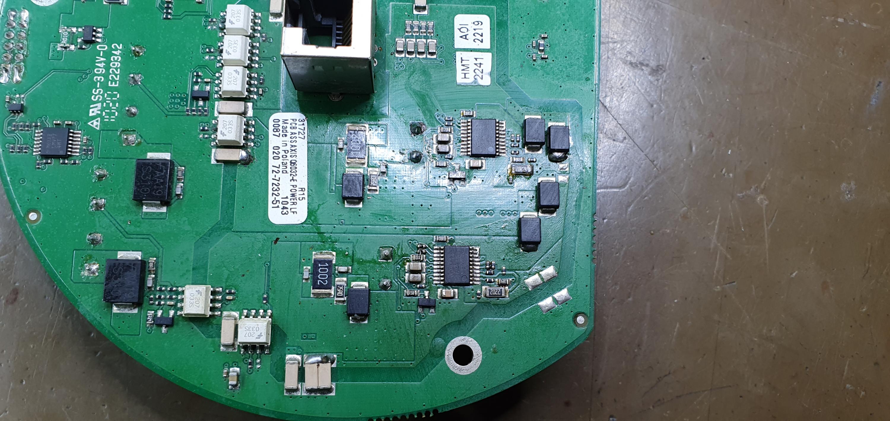

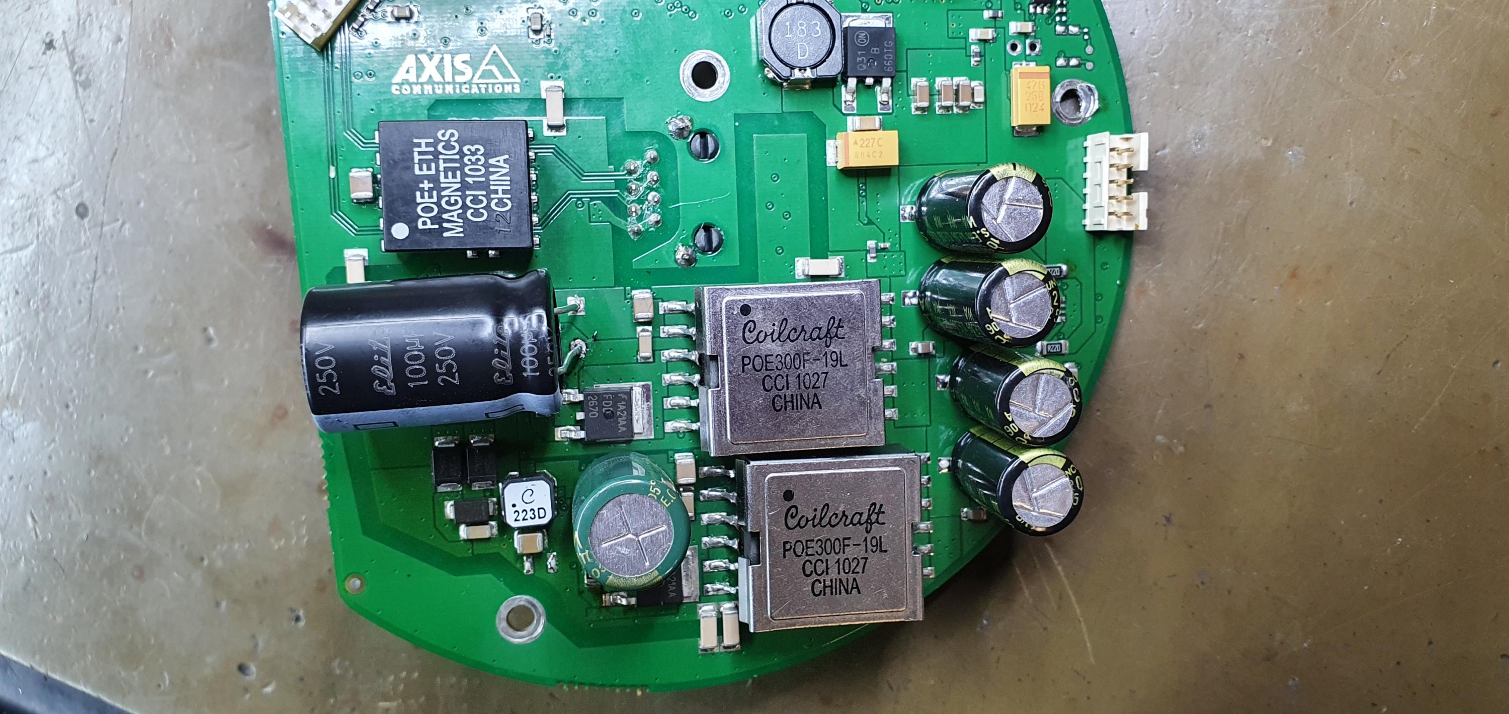

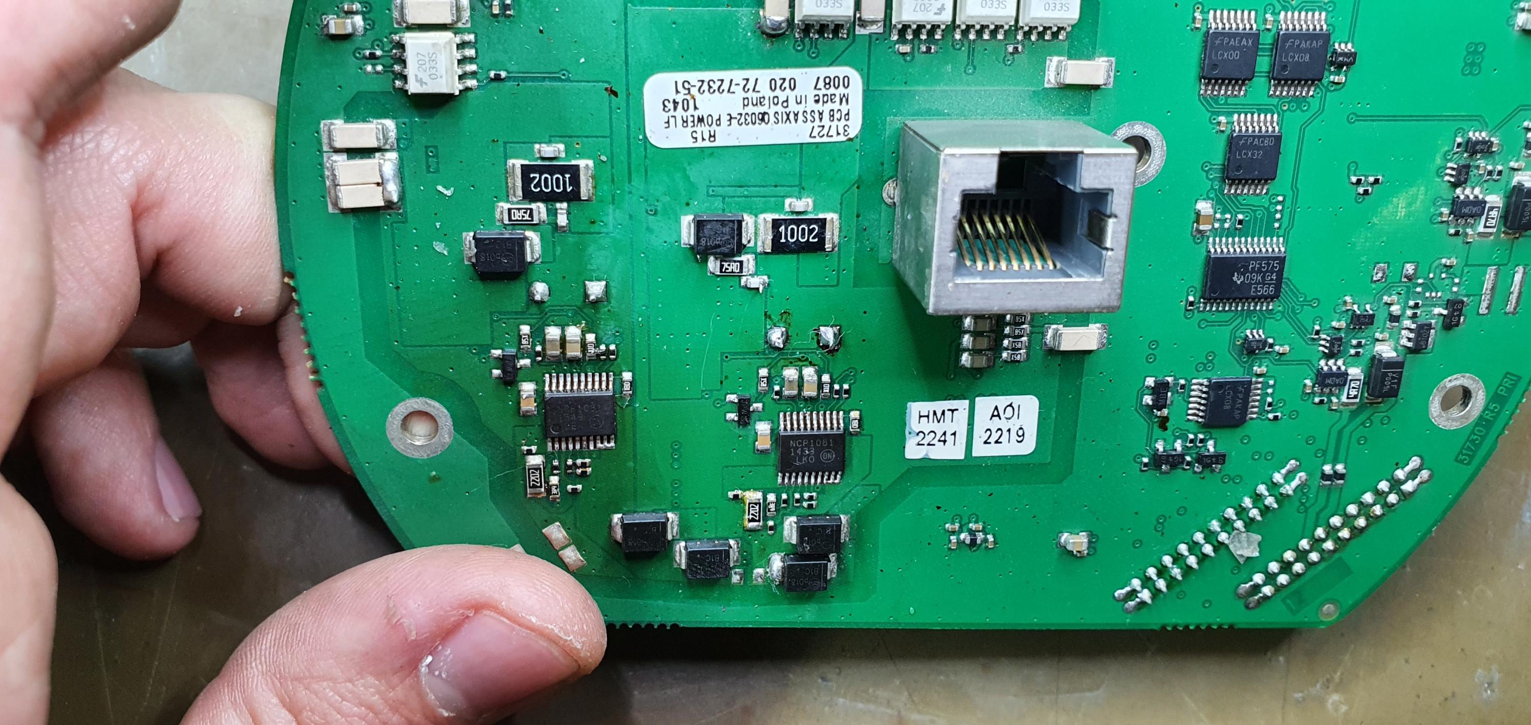

    From the RJ45 connector, I can clearly see 4 traces going to that black "poe+ETH" box thing, which I presume is a transformer like on all NICs/laptops, whatever. From there, the 2 pairs continue to the connector that goes to the moving head, so I assume those are for data and that's where the actual "NIC" of this thing is in the head - not down here on this board. What about power then ? It's not very clear on the photos I've taken, but I see 2 pins directly shorted together (the first ones, depending on your orientation). I assume they are pins 7-8, so I'm expecting 4-5 to ALSO be shorted together, just not visible from underneath (forgot if I actually measured this).
    The two ICs that seem to run the whole show are those NCP1081. All the application schematics there show pins 4-5 and 7-8 shorted together, which would confirm what I found above. I doubt this camera uses Gigabit Ethernet, so it leaves the 2 "data" pairs alone (green and orange) and directly shorts the remaining 2 (blue and brown) to carry power.....ALTHOUGH, it could be the black box has center taps on those data lines, so those TOO could "extract" power from the data pins themselves, just so the camera is compatible with both A and B standards, which I read is a requirement (???) There's probably something signaling the injector to stop, not necessarily a short....again, I'm not entirely sure what conditions must be met for it to keep supplying power, besides the transmission itself...Any ideas what I should check ? Should I just replace the NCP chips or try a different injector, despite the guy claiming both of these work ???
    The injectors output 55v (label says so), so I was hesitant to connect them to a known good 48v Hikvision camera to it to see if that "port" LED behaves differently or if it's unable to sustain the load and the problem has been on the injector side and not the camera side this whole time !

    Check resistance to ground on all of the buck/boost circuits. I see 3 inductors that are possibly used for power conversion (not counting the Coilcraft ones or the POE+ETH one.) If any of these inductors show a very low resistance to ground, chances are the main IC(s) may have been hit by a lightning or other similar surge. Also check the associated MOSFETs and diodes on those power rails for short-circuit. If the POE injector is indeed shutting down and indicating a power overload, then very likely that is what's happening - something, somewhere, is shorted on a DC power rail.

        My first go to would be caps, buck converters and magnetics. Could be also the main IC’s being bad. I’d look at spec sheets, then measure voltages and keep isolating the problem. Maybe it’s just a bad SMD cap… who knows.

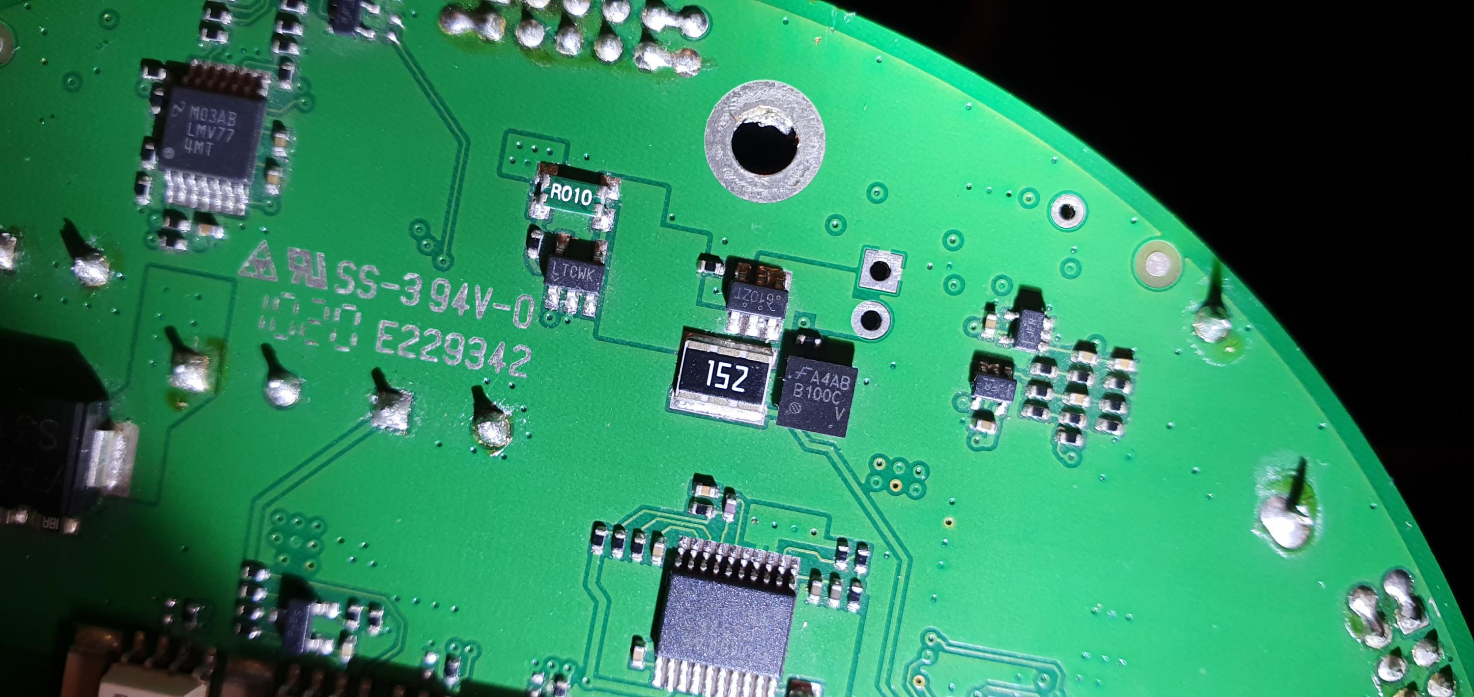

                    Today I tried powering the board after the caps as previously planned. By accident, I came across a post on EEVBlog where a chap was having an almost identical issue with an almost identical camera. His symptoms were exactly the same, so I was REALLY curious if he managed to get it going, but sadly the thread died half-way through and it was never solved. I replied anyway just to see if there will be a follow-up, but I doubt it.
                    However, I did get one interesting piece of info out of it: the guy had the same idea and powered the camera after the PoE part by applying power directly to the output caps. He said he tried 19v and the camera started, so I did the same. I wasn't as lucky though: mine does nothing....well, almost nothing: the tiny fan on the dome itself spins briefly then stops....that's it. Sh!t - I was afraid I may have more problems in the head itself, but I decided to stay calm and not throw in the towel just yet. See, it could be one of the downstream converters IS indeed faulty, despite having no shorts that I could find outright, which tells me something must be failing when powered, like an IC getting "stuck on", but ONLY when power is applied. I decided it's time to reverse-engineer this thing a bit and focus on the rest of the board, not just on the PoE section, as much as I hoped I wouldn't have to, because it's multi-layer, so it's not fun to work with...
                    I wanted to see how "VIN" (B+ so to say) actually goes INTO the converters, but I wasn't getting a direct connection between the positive leg of those small output caps and the input pins of the ICs (there's 3 switching converters, so 3 ICs, 1 of which is different to the rest - THIS one, an LM5576).
                    Turns out VIN must first go through a transistor before getting to the converters: it's this SOT23 transistor near this large "152" resistor in the picture. It's labeled 610ZT and I couldn't find anything about this part right away. Google however, based on my search, somehow DID stumble upon an Ali listing for a part that looks identical, so I looked up the datasheet for that one and although it could very well be a different part entirely, the pinout seems to match: you've got the Gate pin where the small black resistor is, 4 Drain pins to the right (2 on both sides, which act as the "output" ) and 1 Source pin (bottom left from "R010" current sense resistor there, which acts as the "input").
                    There's also the current sense resistor and that LTCWK part: the LTCWK is THISso if my theory is correct, VIN arrives through the CS resistor, through the transistor's S and finally out through D to the 3 converters. Since there's a fault somewhere after the resistor, the LTCWK IC detects overcurrent and shuts off the transistor, hence why the fan briefly spins then stops and I get no boot. The next step is to:
                    A) gently inject power from my bench supply even deeper into the board. In fact, directly into those 2 solder joints in the picture which by the way correspond to GND and VIN AFTER the transistor, connected to the D pins, so the "output" of the transistor so to say.
                    B) check to see what/IF the 3 converters output anything (provided I can sustain power) or what goes pop if I start pumping some amps there. This being after the CS resistor, LTCWK has no way of stopping that now and I can at least blow up what's at fault I think I'm getting close to cracking it
