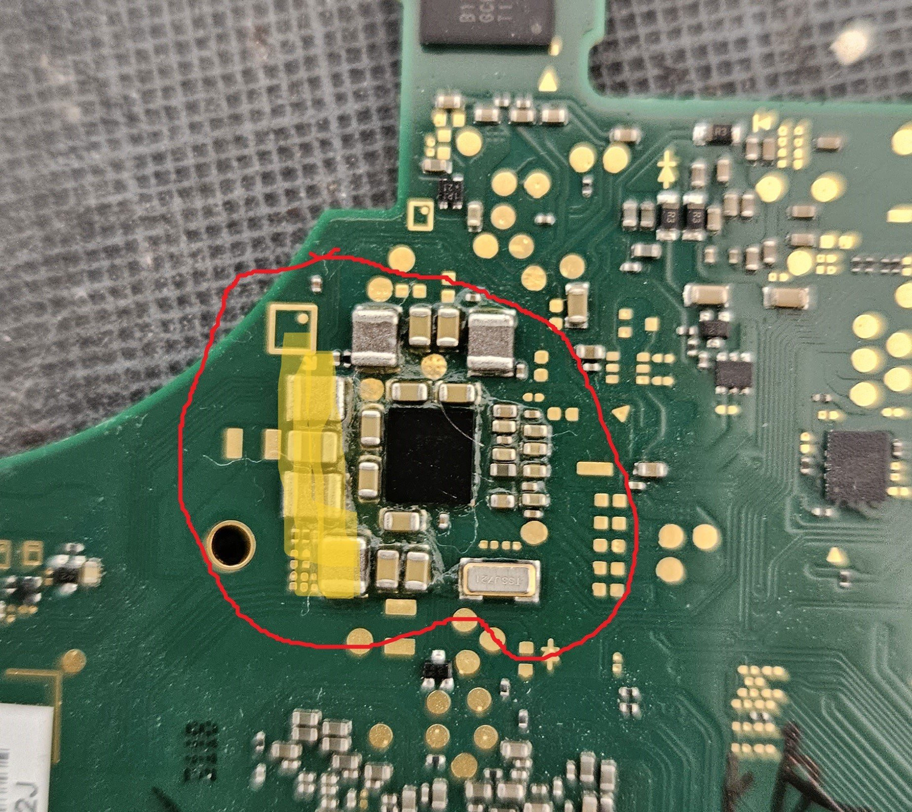

    I'm taking out my old switch that had a blue screen, I wanted to reball my CPU but I realized that the battery was not charging.
    When I was looking for it I saw that the following capacitors were heating up a lot (in yellow on the picture)
    https://www.badcaps.net/forum/attach...1&d=1677962667
    so I removed them and my battery is charging (I don't know if it has anything to do with it). But when I disconnected the battery from the motherboard I still have a consumption of 0.192A.
    Nothing heats up and nothing seems to be defective
    Do you have any idea where I can get replacement capacitors?

    if caps are shorting....the chip is faulty.....also check caps near charging port..if shorted also change chip

      Thanks for your answer,
      The fuse at the output of the charging port looks like it is broken.
      Should I change the capacitors or only the chip?
      I'm a bit lost.

        But if there is consumption the gun must not be burned ....

          if caps are shorted around chips.......the chip needs changing.......desolder chip and test caps again..to see if short goes away
