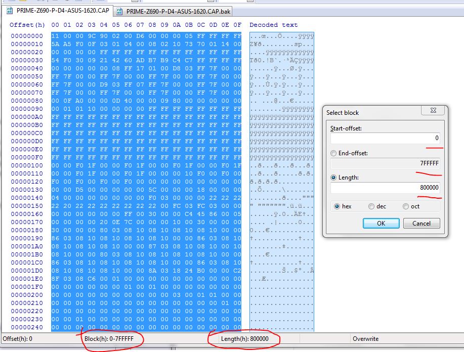

    The bios is available at the support site
    https://www.asus.com/Motherboards-Co...HelpDesk_BIOS/

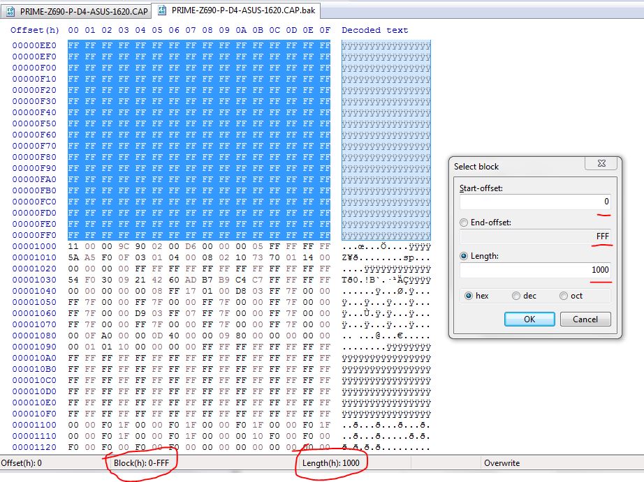

    The bios has a CAPsule header that needs deleting,and the 8 and 16MB are joined together as one file,so it will need editing and splitting with a hex editor: https://mh-nexus.de/en/hxd/
    Open the downloaded bios with HxD.Select "Edit" -> "Select Block" and enter 0 as the "Start-offset" and "FFF" as the "End-offset" ,or set the "Start-offset" as 0 and enter 1000 as the "Length" .Select "Edit" -> "Delete" or press the Del/Delete key on your keyboard.
    Next,select "Edit" -> "Select block" again,enter 0 as the "Start-offset" and 800000 as the length (8 hundred thousand is 8MB) .

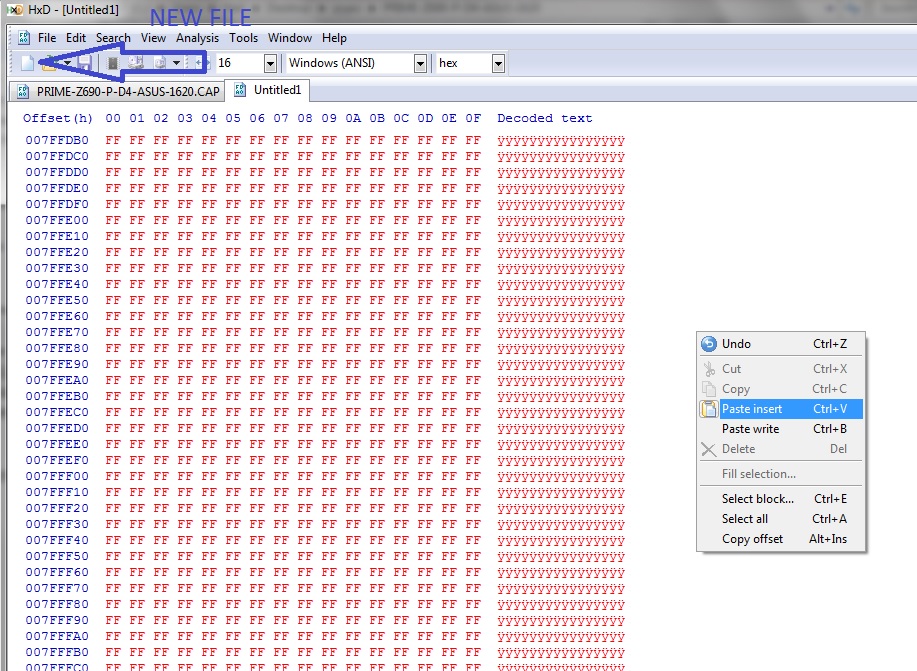

    Select "Edit" -> "Cut" . Click on "New" then select "Edit" -> "Paste-insert" or you can right click and select "Paste-insert" .
    Save the file as 8MB.bin and close the tab.Save the remaining 16MB bios (the length of the file is 1 million, 16MB) and rename the file with a *.bin or *.rom file extension

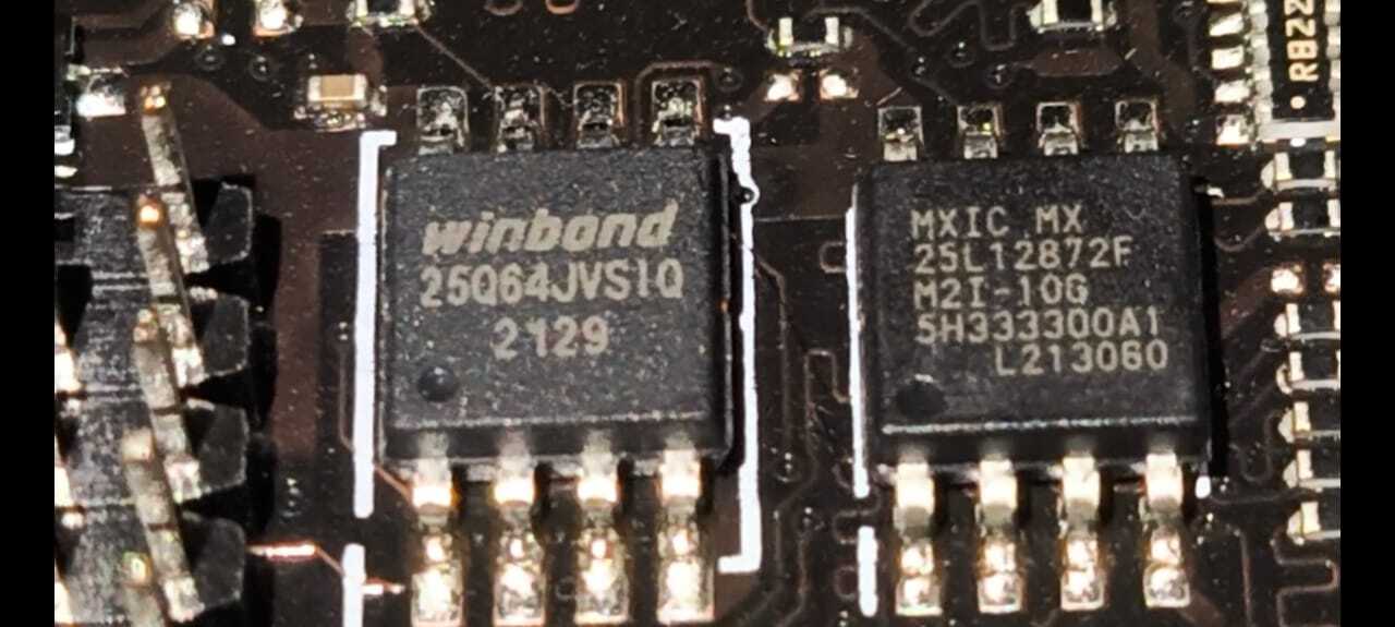

                      I have the ASUS PRIME Z690-P WIFI D4 board and in the image I describe the corresponding chips, what software I can use for those 2 chips and I have the CH341A programmer.
                      The PC turns on and doesn't give me an image and the fans sound loudly and then slowly, seeming like it wants to start but it continues in that loop.​
