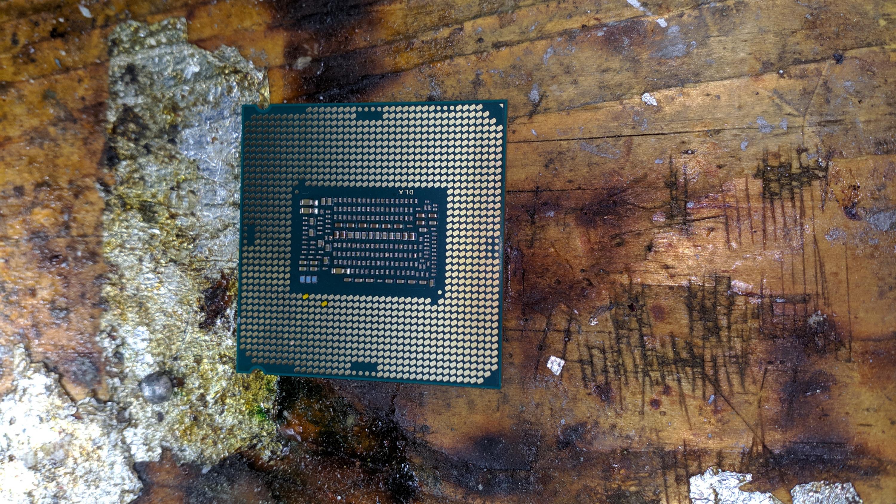

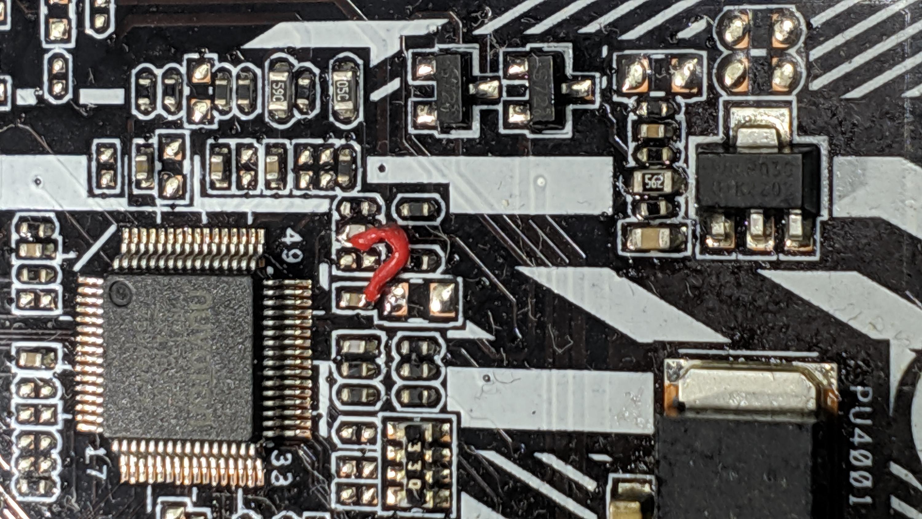

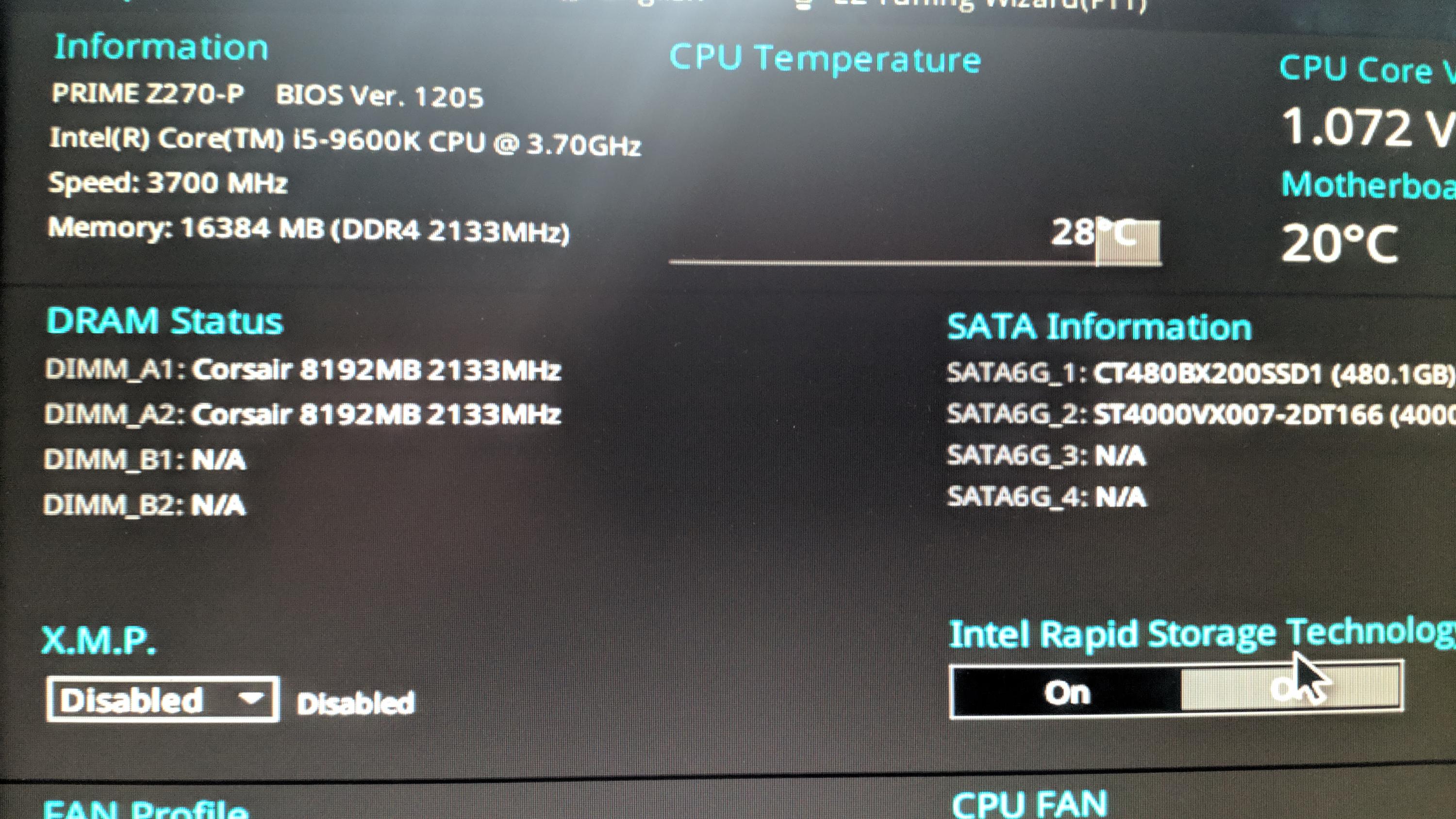

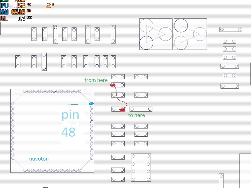

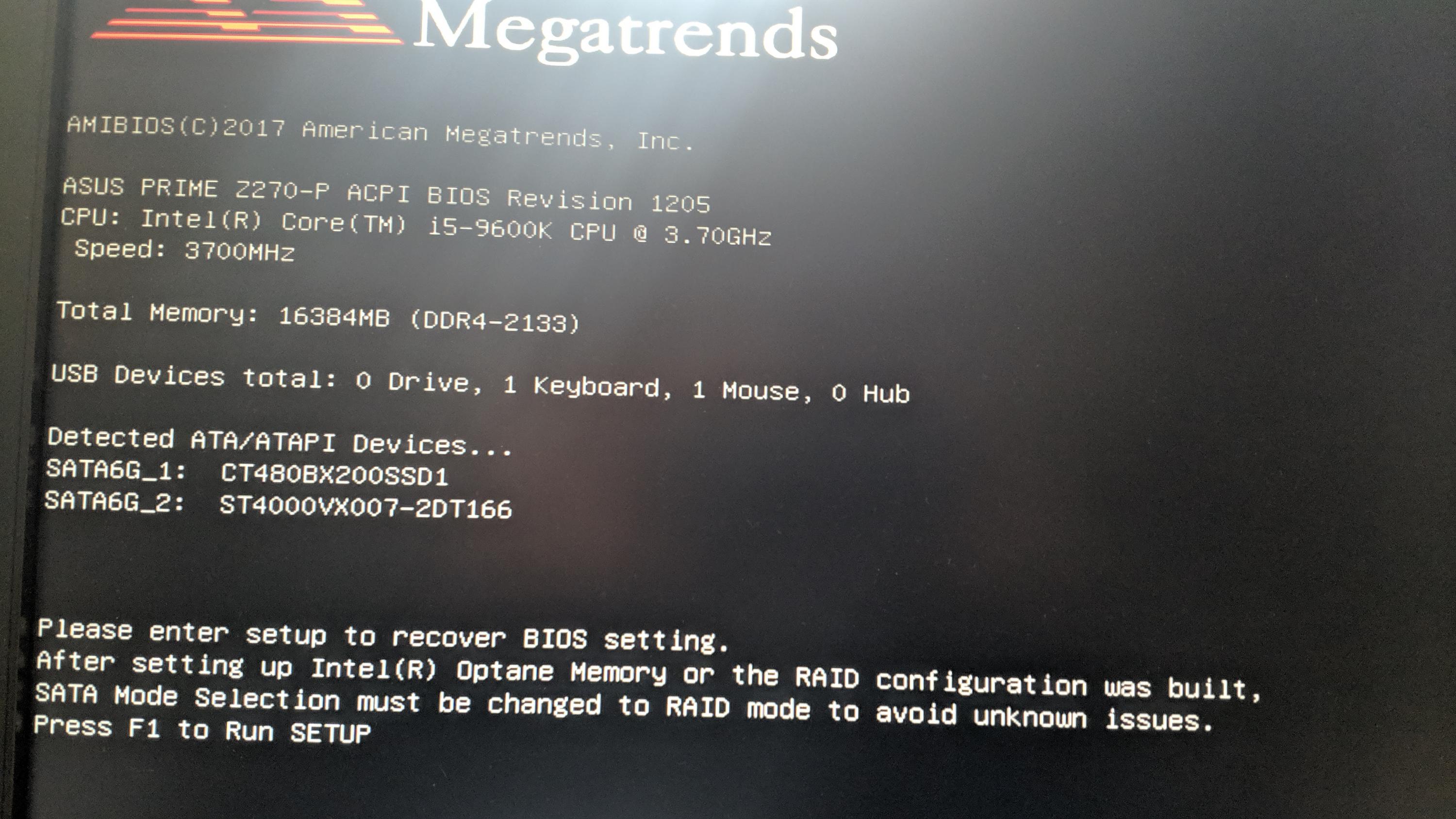

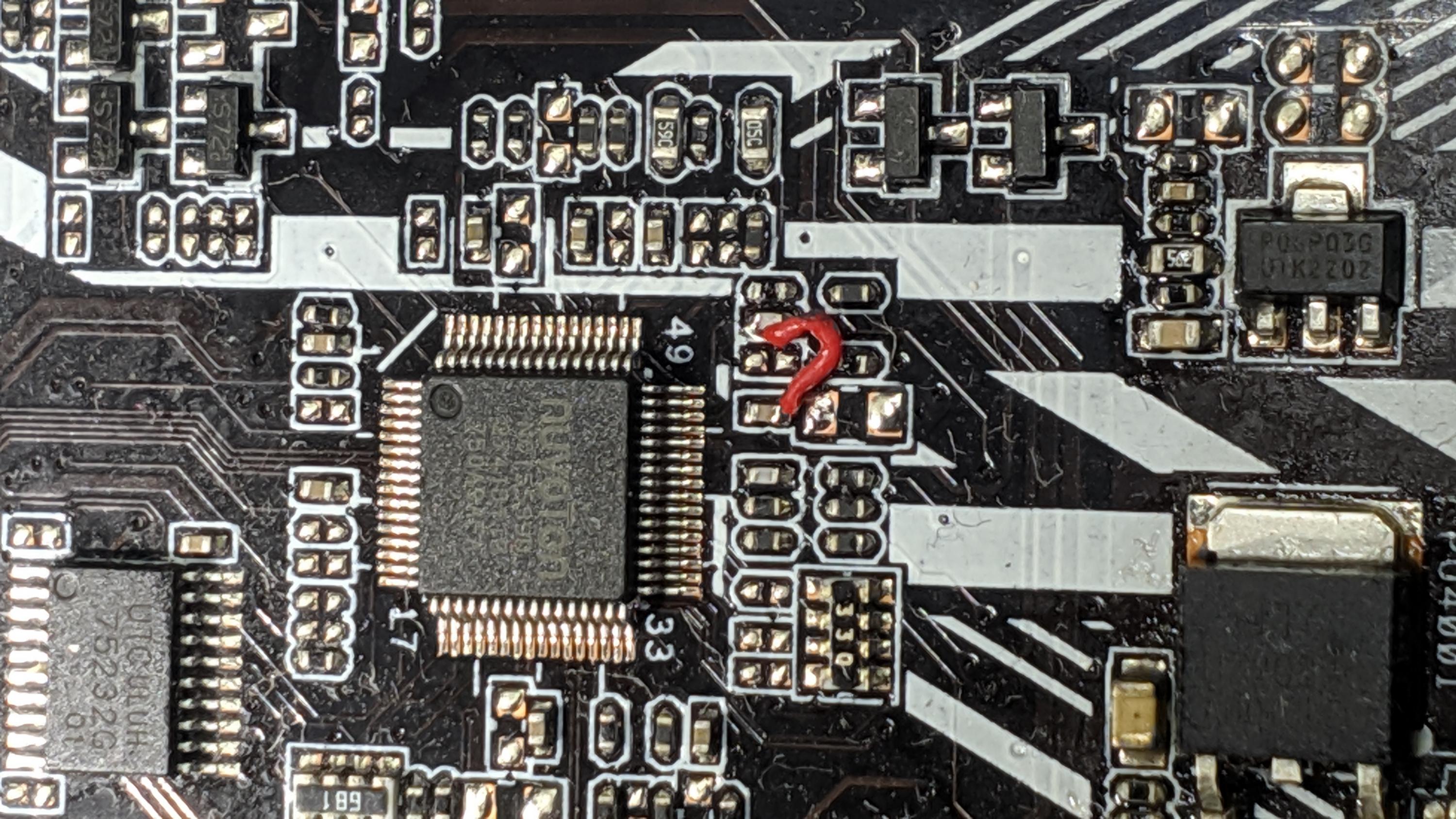

    success!!!
    tnx to the brd file i had no need to joint the 2 cpu pins to make cpu detected. ofcourse i needed to isolate 2 pins to prevent them to get burned.
    modified the cpu detection by shorting it to gnd. power consumption on rtc is the same .... almost omah.
    post picture of the jumper wire, and my bios with all serial deleted. u can use FD44Editor.exe to restore system uid, s/n and mac adress.
    easy way is to dump yyour original bios, open it with FD44Editor.exe and save on the coffee lake bios i have posted here.
    have fun
