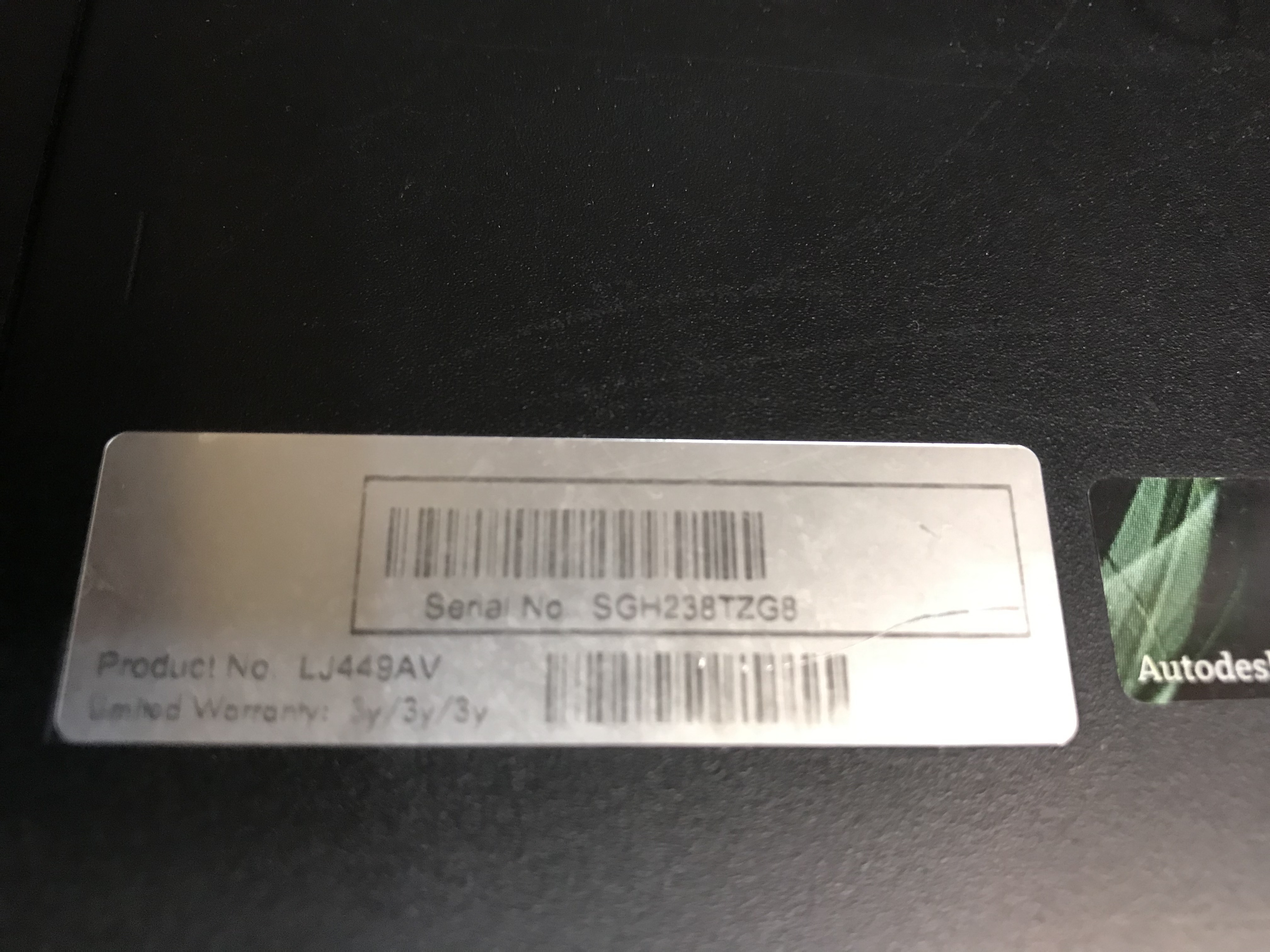

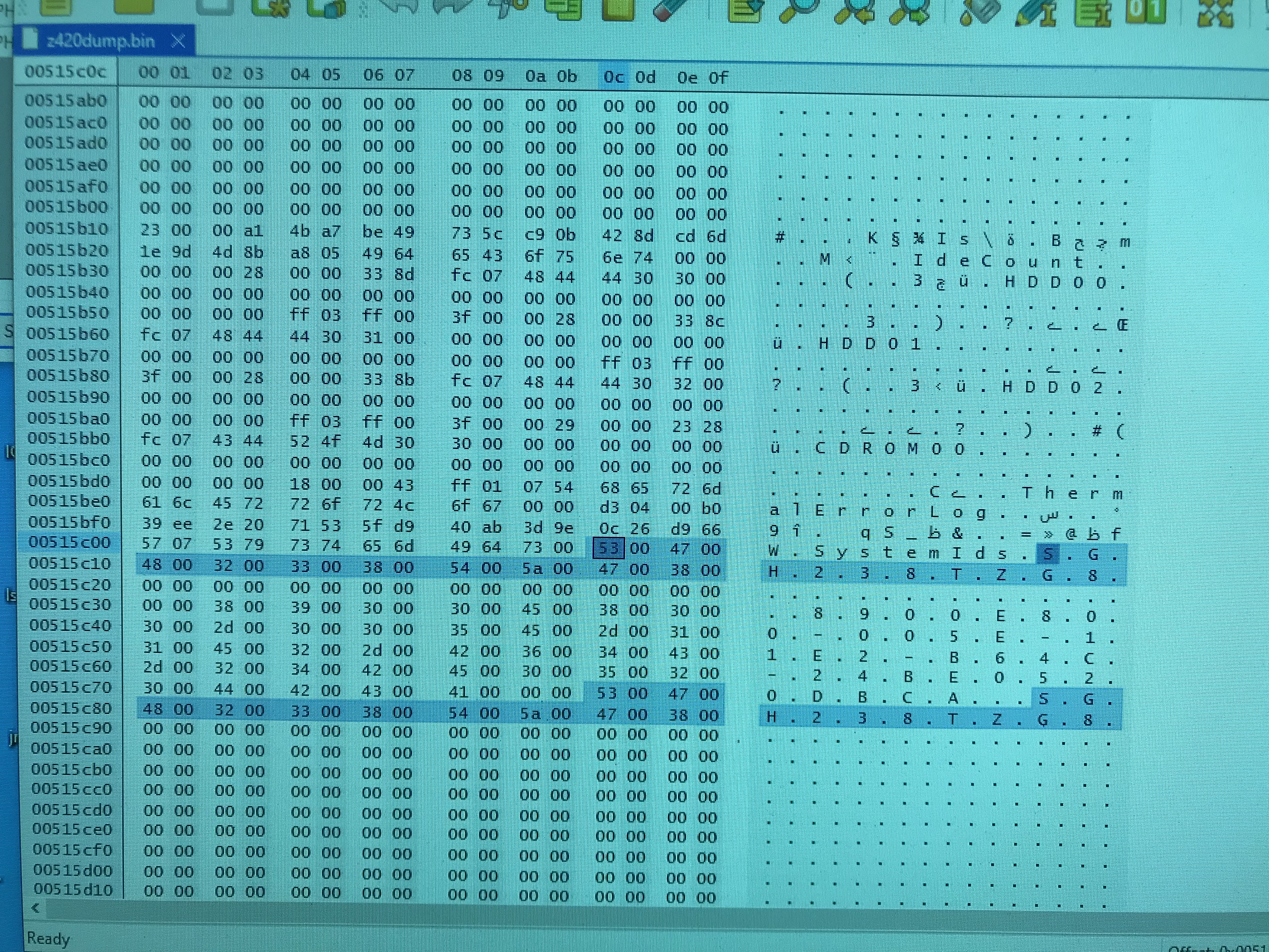

      hi my z420 has freeze at hp logo, re flashed by that file you uploaded and now its ok but i have Invalid electronic serial nomber,i think i should have the serial number from old bios dump and i have the old one but i dont khow how to fine and inject to the new bios,i will upload my old dump in down of this post thanks full if you can help me
    • alijoon30
      • Sep 2017
      • 10
      • iran
      serial number : SGH238TZG8
      Thanx

          Originally posted by alijoon30
          bump
          Serial number is not real, check again.
            Click image for larger version Name:	2024-07-28 19_03_01-Official HP® Desktop Drivers and Software Download _ HP® Support.png Views:	0 Size:	71.2 KB ID:	3317798
            hi my friend,thanx for your attention,that is right but this is write on the case and even inside my old bios dump
              • 21841
              Search by product number instead. LJ449AV
                Thank you , SMDFlea !
                HP Z420 Base Model Workstation
                  in new bios i put serial number manually, thanxxx for your big help
