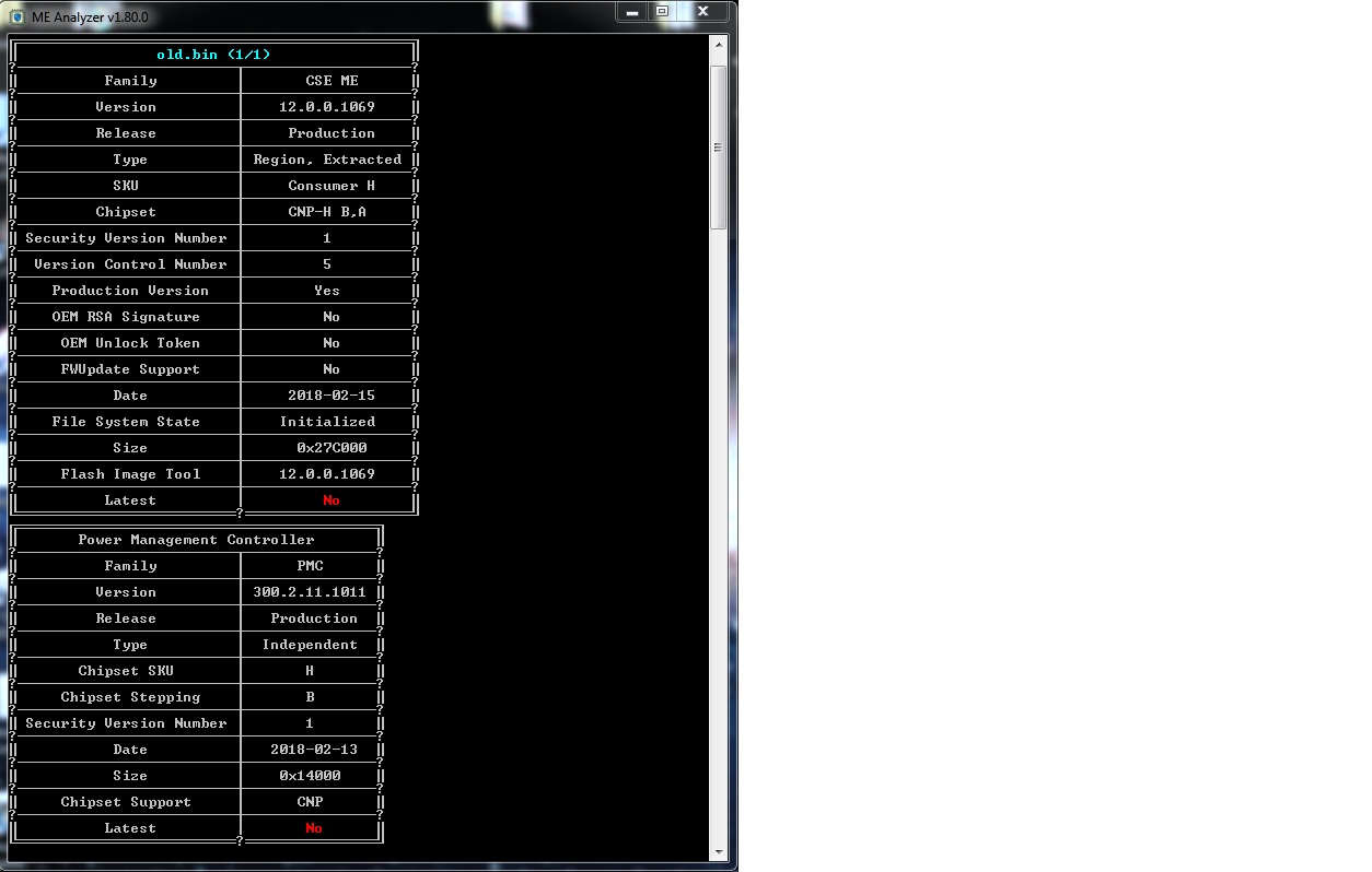

      here is original bios and i tried clear ME but intel ME/TXE injector does not work.

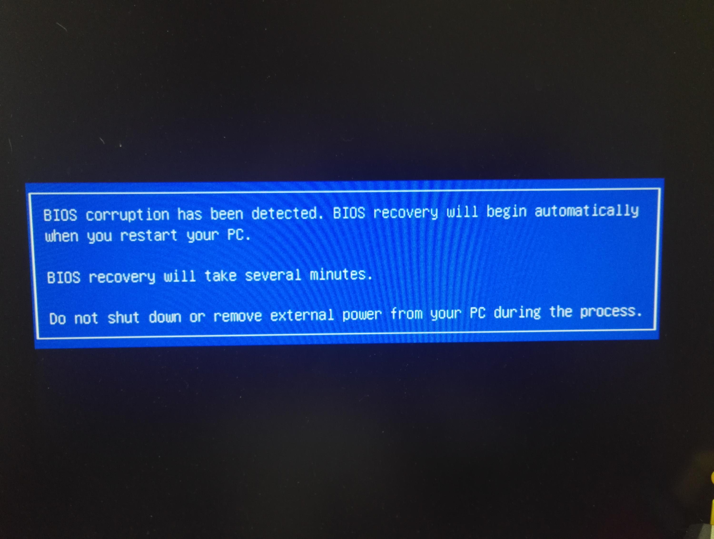

          Same thing , motherboard powers up and shuts down after few seconds.
          i also tried move onboard jumper to BBR#, after that i get blinking led on
          power button , 2 long 2 short , according to HP codes thats bios failure.

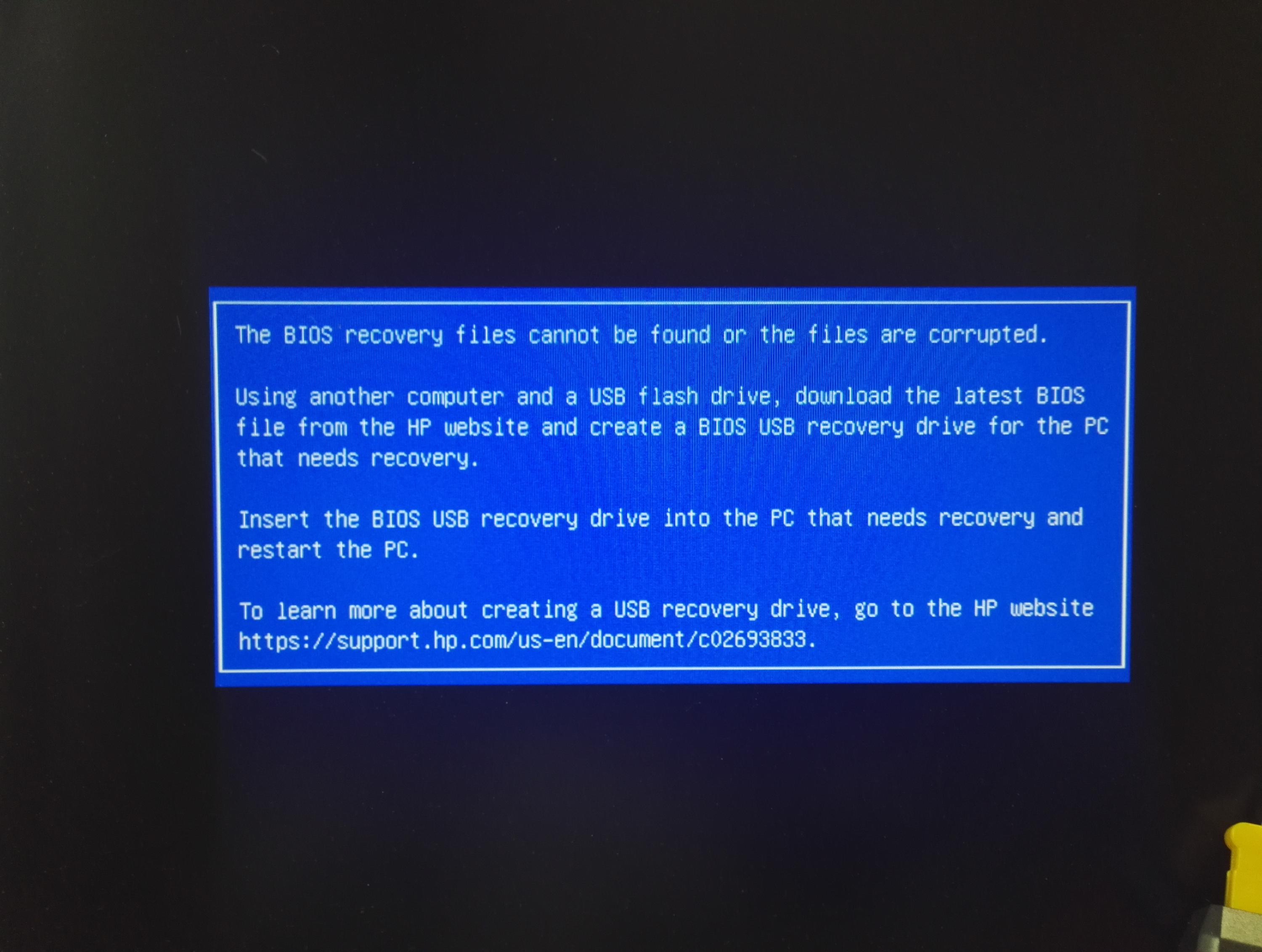

                What else could be problem , motherboard boots in recovery mode but
                it seems cant recognize recovery usb created from original bios update.
