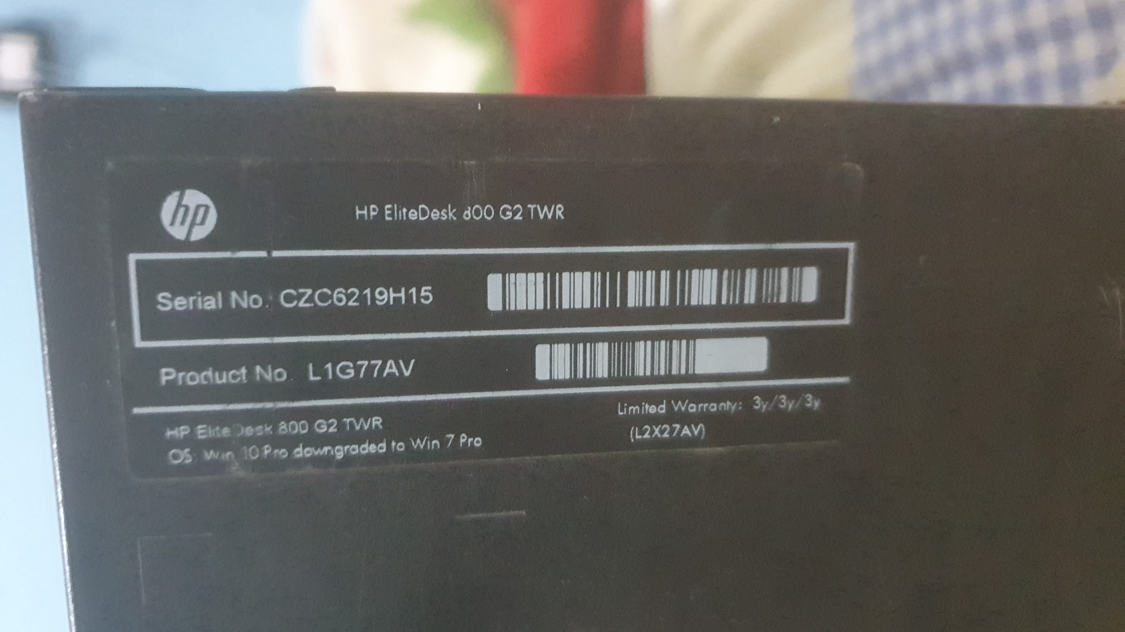

                        • beast4ever
                          • Feb 2015
                          • 174
                          • egypt
                          #112
                          I need to fix the file, friends
                          • beast4ever
                            • Feb 2015
                            • 174
                            • egypt
                            #113
                            UP
                            • hoaca388
                              Badcaps
                              • Jan 2022
                              • 12262
                              #114
                              UP
                              Next time you have to write down the serial number directly, do not take a photo.
                              HP EliteDesk 800 G2 Base Model Tower PC
