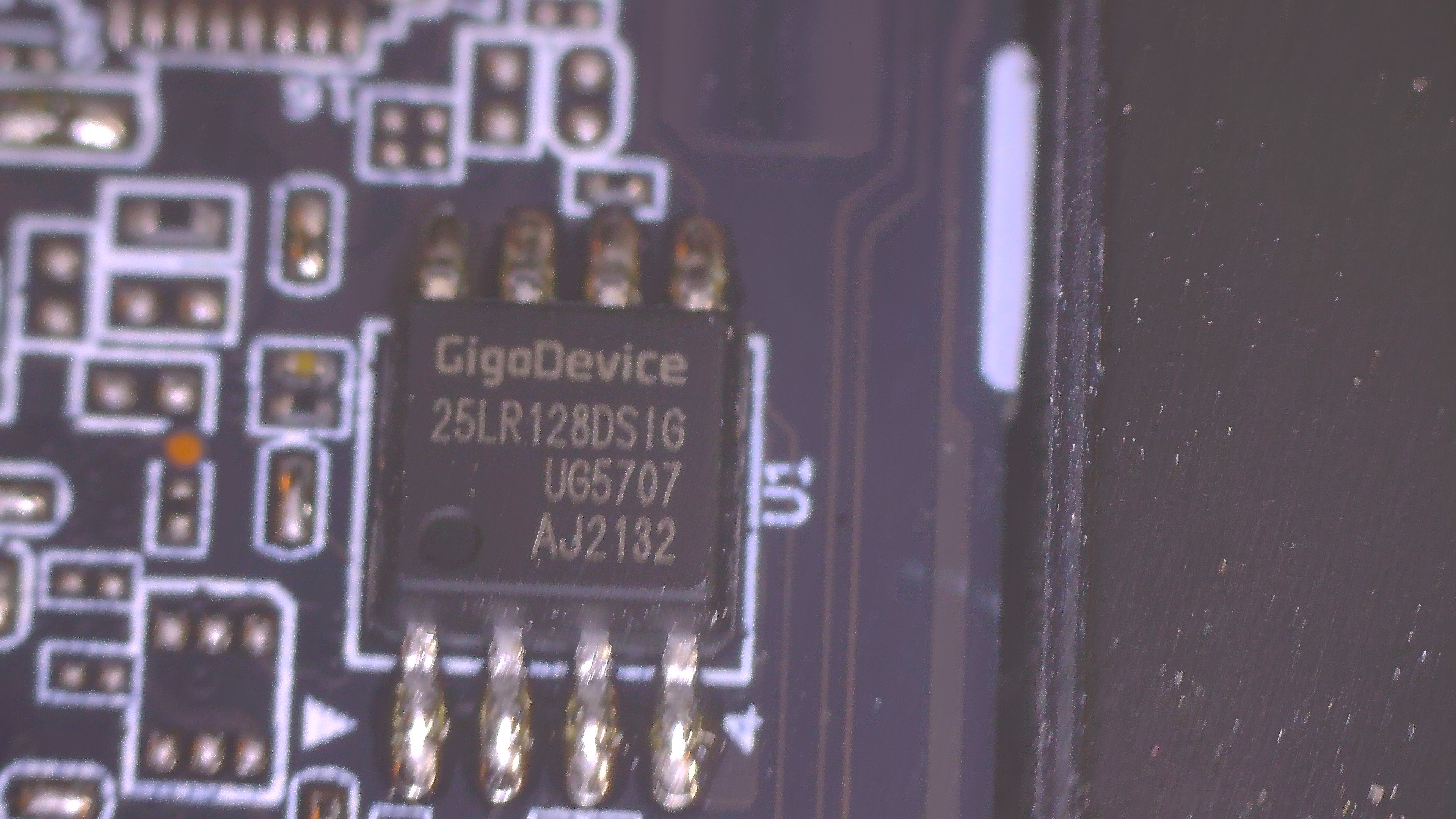

    I have a Lenovo Legion S7 15ACH6 that was interrupted during a BIOS update and is now bricked. Symptoms: fans spin, RGB keyboard lights up, but no display/POST.
    The BIOS chip is a Gigadevice GD25LR128. I’m using a CH341A with a 1.8 V adapter. In AsProgrammer I selected GD25Q128 (since GD25LR128 isn’t listed) and successfully made a dump (BiosDump2_pf3eg12j.rar).
    My understanding is that I’ll need a known good BIOS dump for this exact model, ideally matched to my laptop’s serial number (PF3EG12J), and that the Windows license key/serial should also be preserved.
    Can anyone guide me through the proper process of rebuilding or flashing the BIOS for this machine?
    Thanks in advance!

    BIOS extracted from Lenovo website, DMI inserted (serial/win key)
    Legion S7-15ACH6 Laptop (Lenovo) - Type 82K8
    S/N PF3EG12J
    MTM 82K80083US
    BIOS ver. HACN46WW
    DMI 62B000-62CFFF

        m1ch43lzm, thank you for all the help! I wanted to learn more about the process that you undertook to get the end result of the proper bios for my machine. Can you point me to resources I could look at to learn more. Thanks again!
        • m1ch43lzm
          • Mar 2019
          • 1022
          • Peru
          How to extract BIOS update from Lenovo (Phoenix BIOS)
          https://www.badcaps.net/forum/troubl...oenix-tdk-bios
          And check post 46 for an easier way of doing it https://www.badcaps.net/forum/troubl...51#post3733751
          For the DMI (serial/model/MTM), and Win key, it's encrypted on this model, search for LENV with hex editor, it will appear 2 times, from the first LENV (at 62B000h) select 2000h, that covers both LENV blocks, copy/paste write that to the clean extracted BIOS, make sure you don't add extra bytes to the file
          I noted the range you have to copy from the old BIOS to the new one, 62B000-62CFFF
