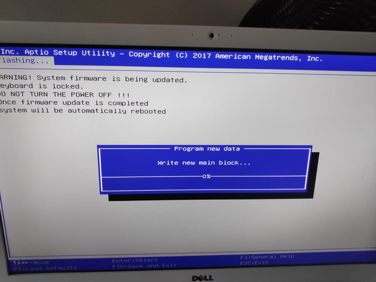

                    Thanks. The bios backup is gone.
                    After a failed bios update, the machine rebooted into a 3x3 (red and green) beep pattern.
                    A technician soldered a new IC and flashed the one without password, but the AIO now has no activity (no fans, beeps, dead).

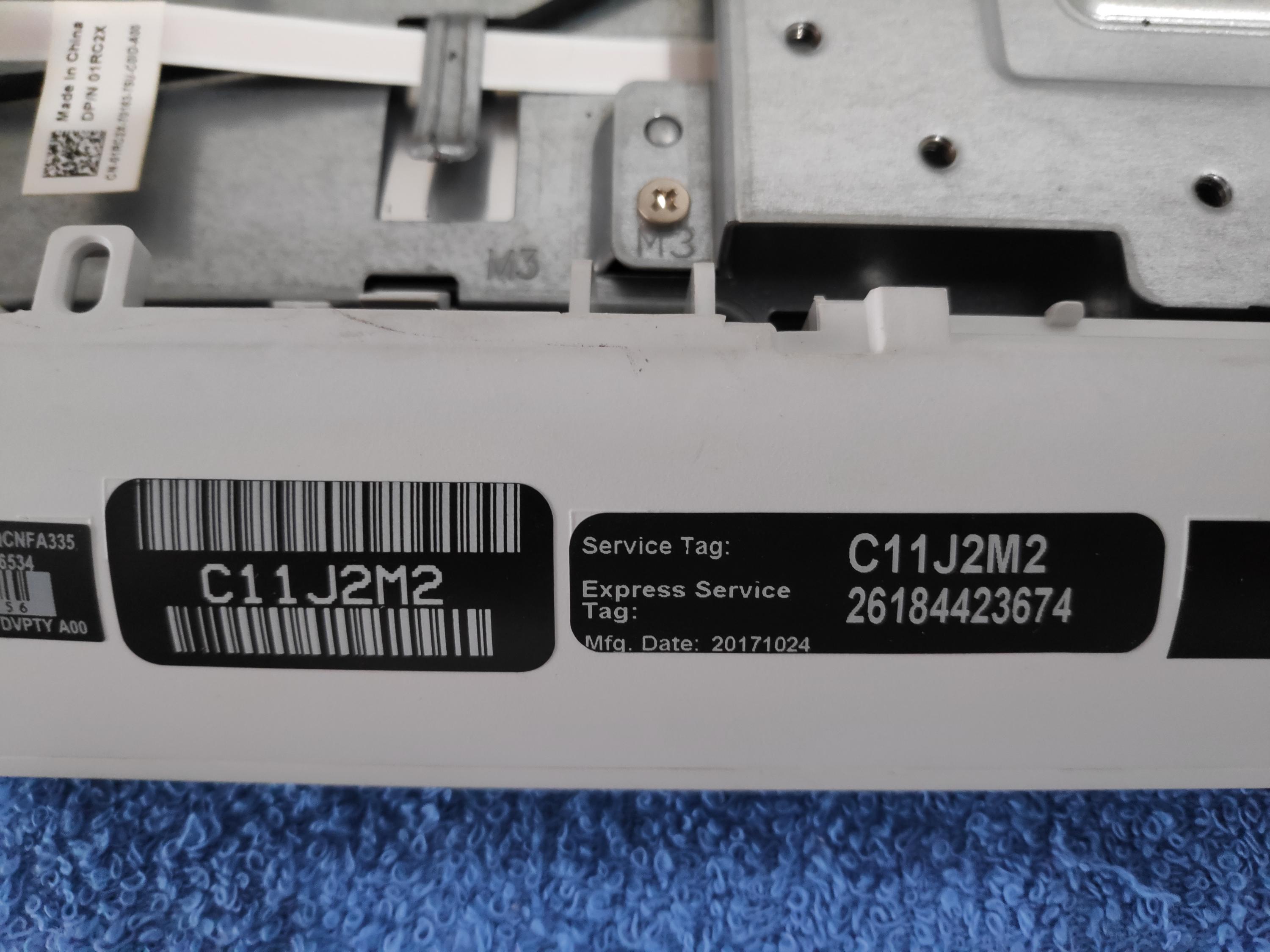

                      Re: Dell Inspiron 3264 AIO - Bad BIOS?
                      Post your service tag number .
                      • Cygnus2
                        • Dec 2020
                        • 7
                        • Brazil

                          The problem started after freezing (for hours) during this step.

                            If you have any leads or questions, I can forward them to the technician.
                              • 22151
                              Check the bios chip is Winbond W25Q128FV , Macronix MX25L12805/12835/12845. I don`t know what else to suggest .
                                The new chip is a Winbond W25Q128BV.
                                The older one is another model.
                                Thanks for the help BTW!
