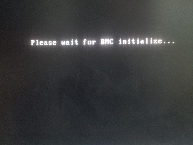

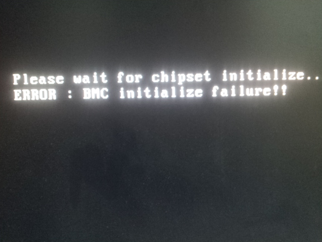

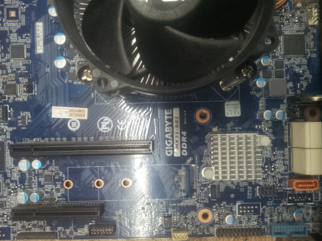

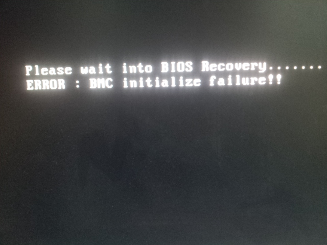

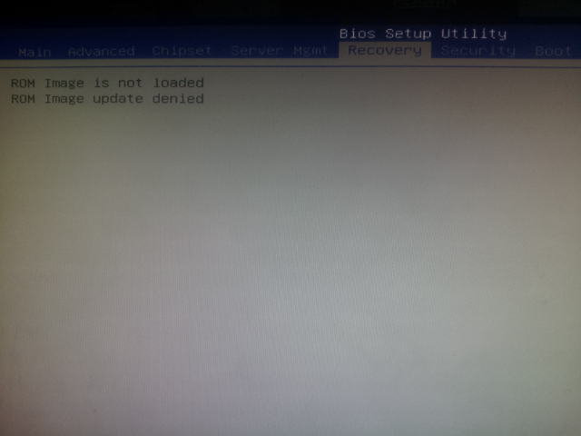

    Bios corrupted after a failed bios update attempt. I searched on the net but didn't find any update/ support for MX31-BS1. I tried MX31-BS0 bios from gigabyte and it worked but now the board is giving the following error. It repeats two times and after the restart, goes to bios setup showing the recovery page. If I shut down/ restart then the error appears again. Kindly provide the original bios of Gigabyte MX31-BS1 or help to solve this issue. Thanks.

      Try to update the BMC firmware
      https://vmexplorer.com/2017/03/22/gi...d-motherboard/
      https://www.gigabyte.com/Enterprise/...pport-Firmware
