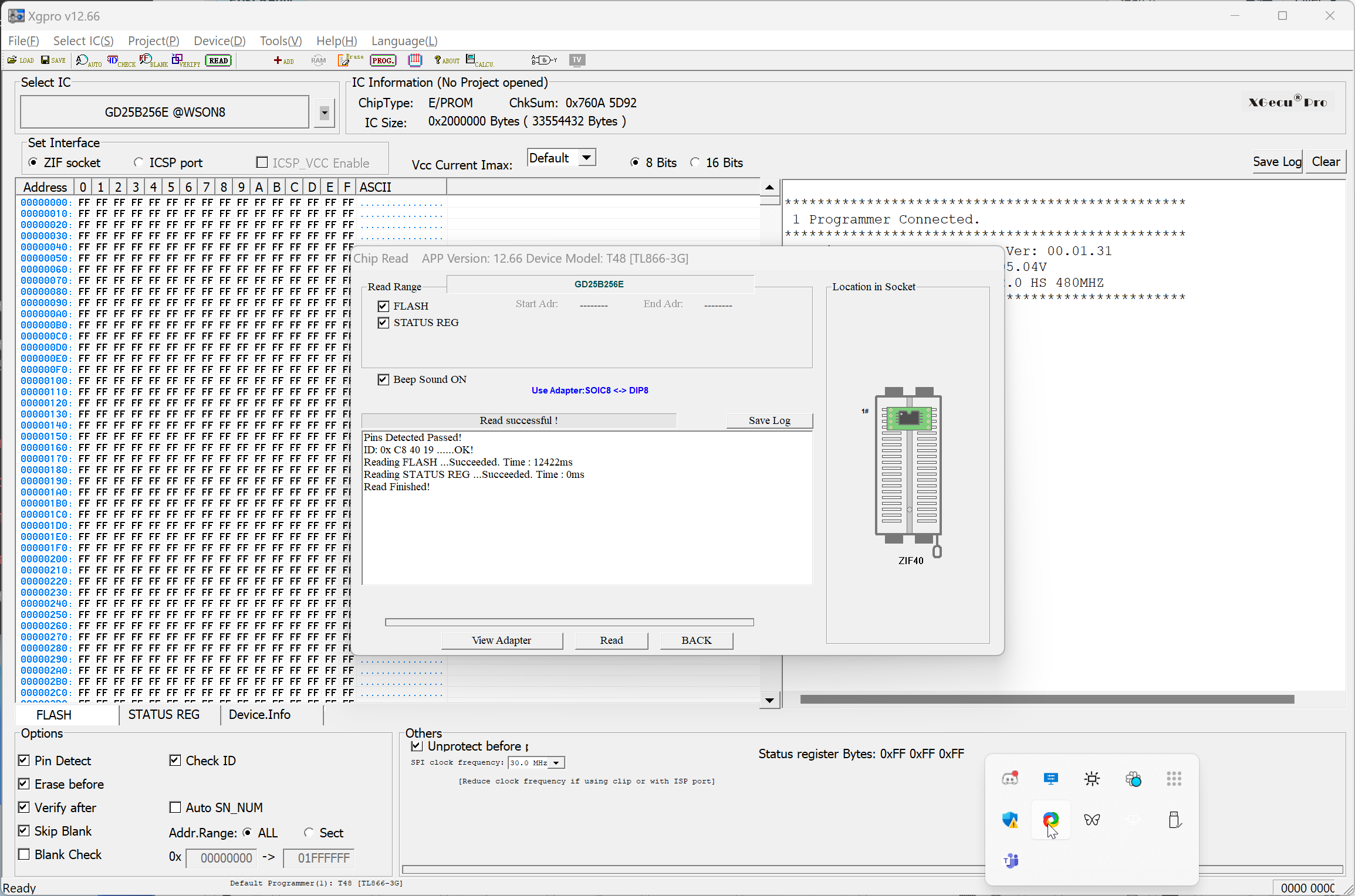

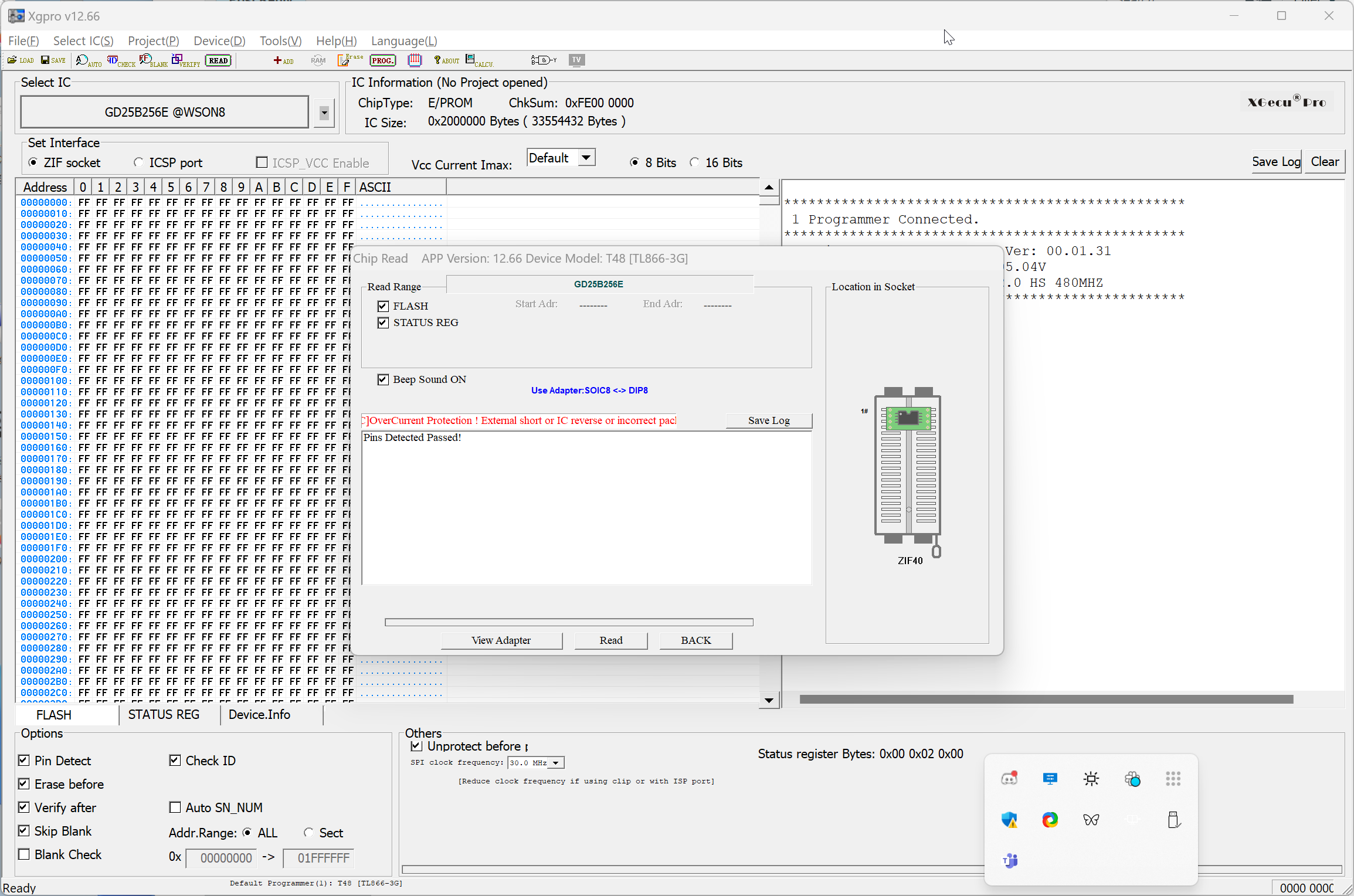

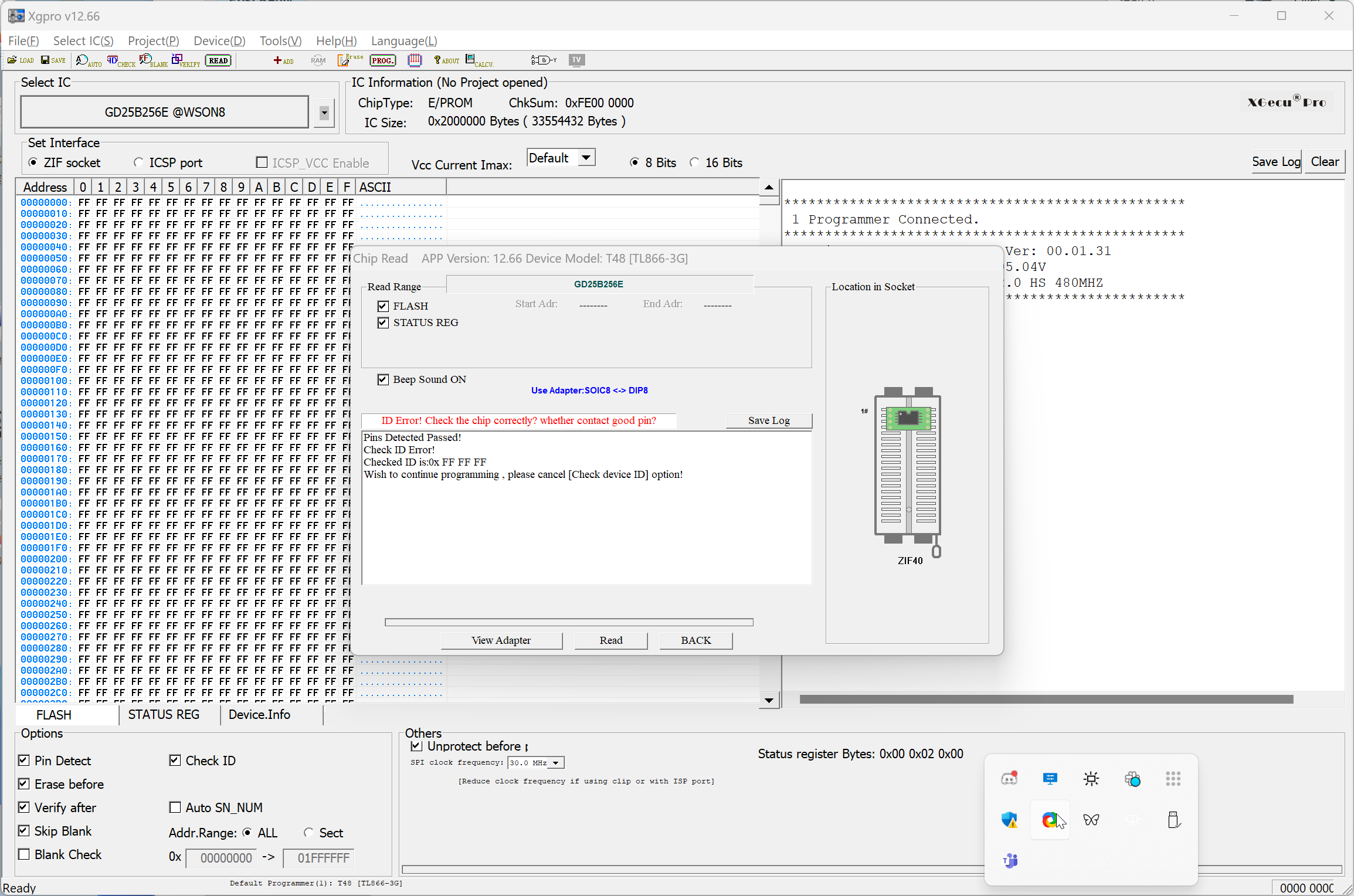

                    I've just picked up a locked 800 G9 mini from eBay planning to give this a shot, but I'm not sure the T48 even supports these two chips, yet. I selected the closest sounding one in Xgpro, the GD25B256E @WSON8 but couldn't get it to read. Could also be that the WSON8 probe / pogo adapter is much more difficult to use than the SOIC clips, I'll admit I'm a complete amateur at this.

                      Actually I hit retry enough times and got it to read the GigaDevice in between warnings about pin mismatches and overcurrent protection. Unfortunately all four reads resulted in different files. I might finally have to learn to solder.
