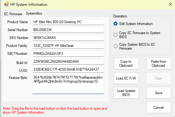

    HP Elite mini 800 G9 corrupted bios, can any one provide a working bios or provide details how to rebuild the corrupted bios to a working one. Thanks in advance for any help provided
    Serial Number: 8CC3252CMF

    attached also the EC chip dump
      Click image for larger version Name:	image.png Views:	6 Size:	42.9 KB ID:	3581972
      I dont know maybe you are using a clip or bios is totally damaged descriptor reg, bios reg, me reg is broken
      try this am not sure uar ec is also is ok or not (my download limit is finished for today so cant chk your EC backup )

          Can someone help to rebuild a corrupted HP elite mini 800 G9 bios any help will be much appreciated
          Product Name: HP Elite Mini 800 G9 Desktop PC.
          SKU Number: 8B7V0EC#ABU
          Product Family: 103C_53307F HP EliteDesk
          SB/CT Number: PQYXK0B8JI7212
          Build ID: 22WWQ6CZ601#SABU#DABU
          UUID: 6582FA8F-D080-4803-9230-130EBFD0BA7C
          Feature Byte: 3E476J6S6b7B7H7M7Q7T7W7maBapaqaubhcAfPguhKhZjhk8mEn7nVngnupDpVpnpqpr.f2
          Kindly refer to the previous attached bios files above post

                    Originally posted by vilmar27@hotmail.com
                    Please, could any help me to unlock the MPM to edit BIOS serial number for this unit?
                    HP Elite 800 G9 Mini PC
                    BRJ350COK
                    9R5K1LC
                    Best Regards,
                    Vilmar
                    Try with the following tool:-HP MPM UNLOCK TOOLS | Unlock manufacture programming mode - Indiafix
                      Hello, dg01!
                      Thanks a lot, but this HP MPM Unlock Tools is very old and not works for new model of Desktops and Laptos. This tools works only for units very old....

                        Originally posted by Originally posted by [B
                        vilmar27@hotmail.com[/B] View Post
                        BRJ350COK
                        9R5K1LC
                        Best Regards,
                        Vilmar
                        Bios file updated with requested serial number BRJ350COK

                          Today manage to recover my Elite mini 800 G9, ended up that my PC bios chip, a winbond w25q256jven was defective, thus got a new chip from aliexpress and reprogrammed with the image file provided .
                          A special THANKS to qayyum786, hoaca388 and vilmar27 for joining and providing support to this post.
                          Note DMI information was updated in image file prior programming the new chip.
                          PC passed power-on self-test (POST)​ and boot correctly without major issues, just PC requested confirmation on a few screen at first boot since bios image was changed thus auto restarted a few times to recover and worked
                          Thanks again
