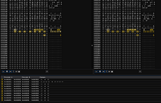

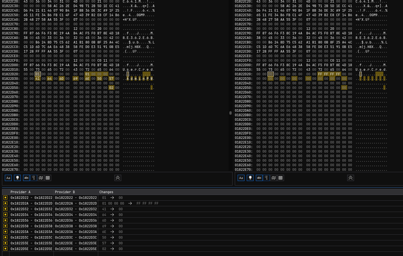

I have a HP Prodesk 400 G6 Mini, there is a password, could you help me remove it ?
I've dumped the bios using flashrom on a raspberry pi using the spi interface.
I've made three dumps and two are identical using diff and can be opened with UEFITool and password confirmed at the "UserCred" location.
Model : HP Prodesk 400 G6 Mini
Serial No: 8CC1241JNS
Product No: 294W6EA#ABF
Also if using a raspberry is not reliable i have a CH341A coming in a few days (and will wait for it in order to flash)
Thanks and have a nice day !
