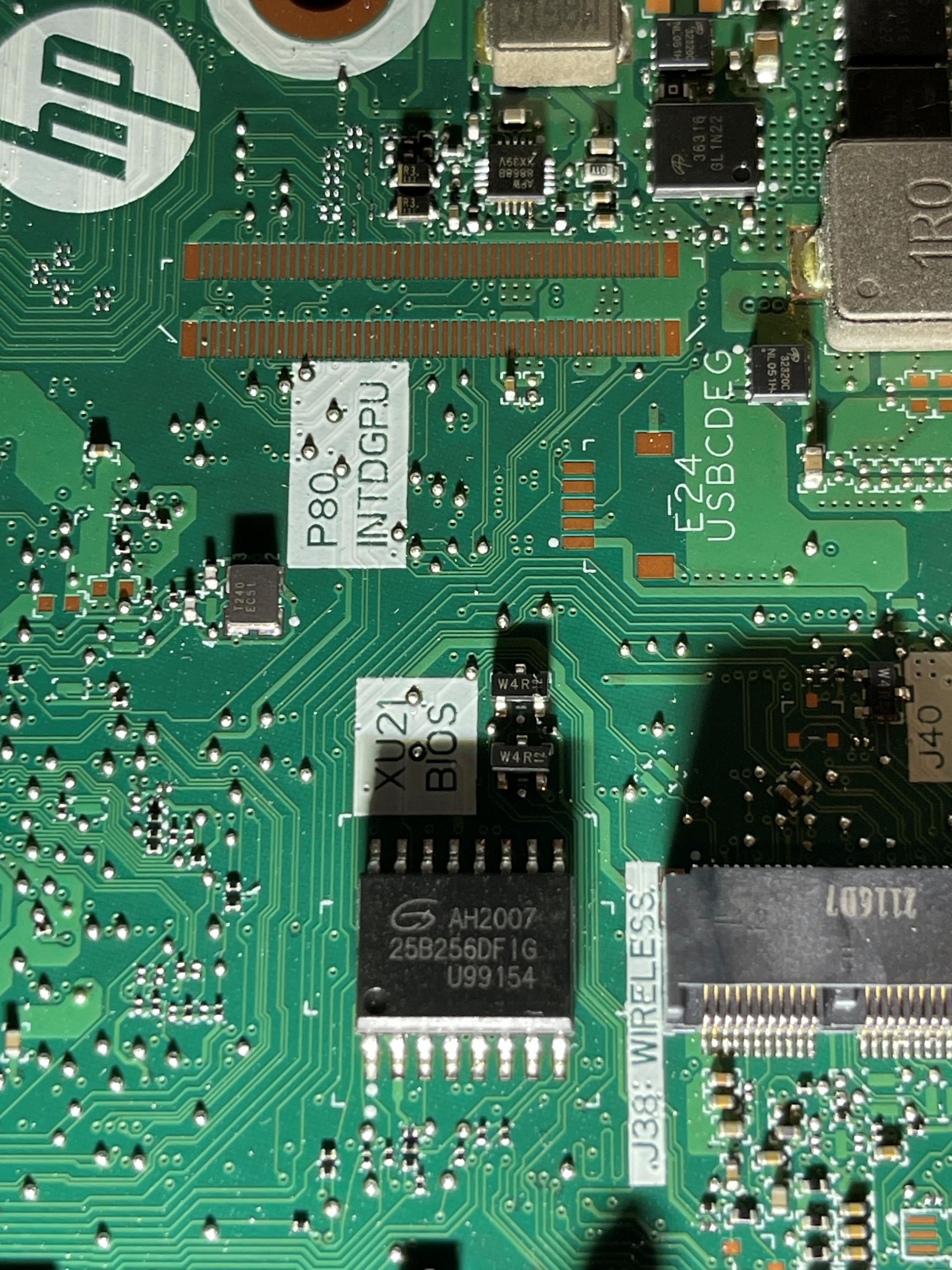

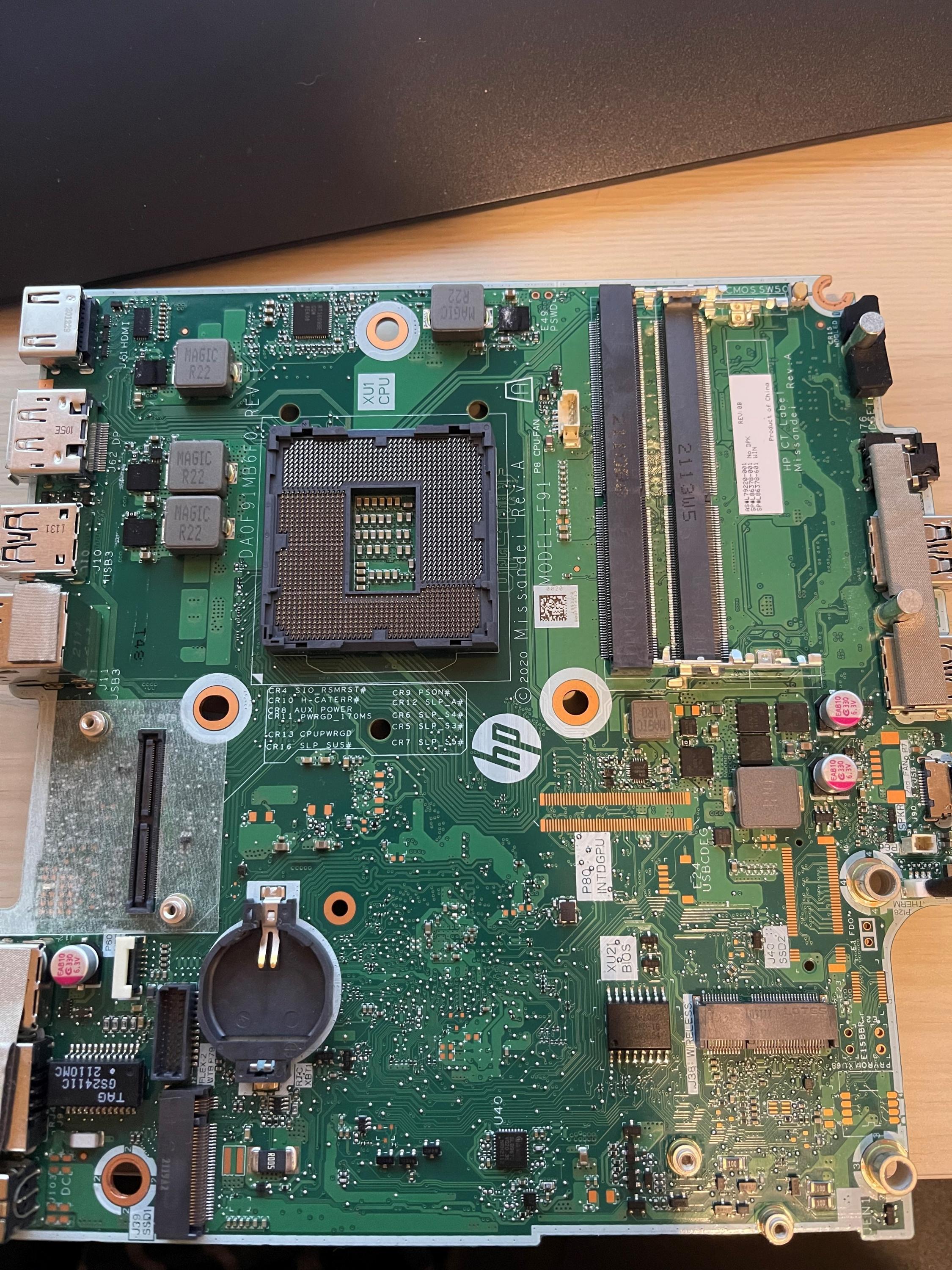

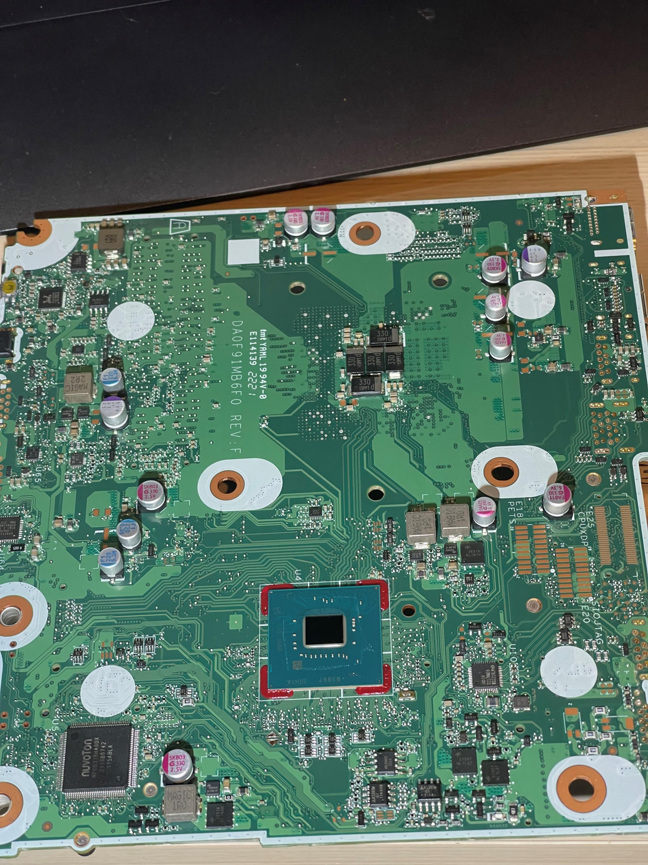

          HP ProDesk 400 G6 Desktop Mini PC BIOS Password Help
          Hi Guys,
          Newbie here so I apologise if I have missed the obvious. I have a HP ProDesk 400 G6 Desktop Mini PC in for repair where the owner has purchased second hand with a BIOS Password enabled. SN: 8CC12804BP
          I have a TL866II Plus and CH341a programmer, I have not used RCUnlocker before and I am looking to learn. I am a bit confused because there is only 1 chip on the board (GigaDevice GD25B256D) which is a SOP16 chip. I am trying to read the chip using both NeoProgrammer and Xgpro, but I can't seem to find an exact match for this chip so I am reading in NeoProgrammer using Chip ID GD25Q256.
          This doesn't seem to be a 16MB chip, and I can't see on both sides of the motherboard a second chip. I am sure I am missing something really basic here, and ill end up kicking myself but can someone just put me on the right track?
          I have attached a picture of the BIOS chip, and 2 pictures of the motherboard.
          Kind regards
          James

            Re: HP ProDesk 400 G6 Desktop Mini PC BIOS Password Help
            Post reading results here.
                Attached the DUMP from NeoProgrammer

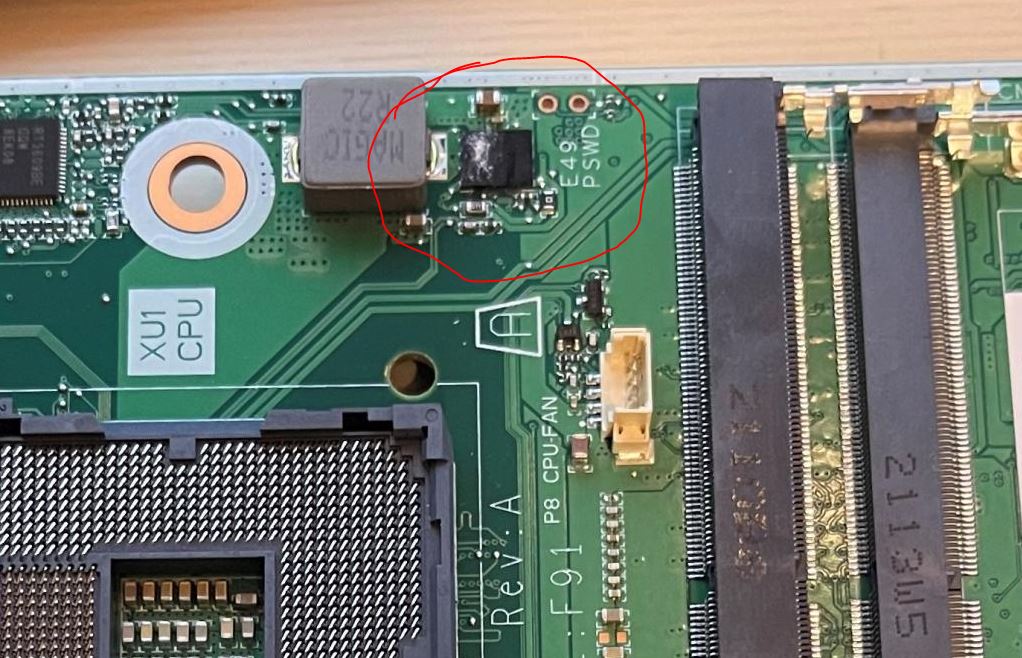

                  Originally posted by techpointhull
                  Hi Guys,Newbie here so I apologise if I have missed the obvious. I have a HP ProDesk 400 G6 Desktop Mini PC in for repair where the owner has purchased second hand with a BIOS Password enabled
                  Did you try shorting the 2 vias at E49 PSWD
                    I did indeed, I shorted for 10 seconds with the Power Off, and also with the Power On as well as trying CMOS reset after, password still remains.
                      Here is your Unlocked BIOS, try it.
                        Thank you so much sir, this worked a treat! May I ask for future as a learning curve, what do I need to do with RCUnlocker in order for it to recognise a file larger than 16MB?
                          You're welcome.
                          RCUnlocker is designed to deal with 16MB files not 32MB files. If you want to do it by yourself, you have to compare between locked and unlocked files till you learn. Otherwise you can upload the file in a proper thread, and someone will try to help you.
