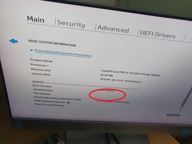

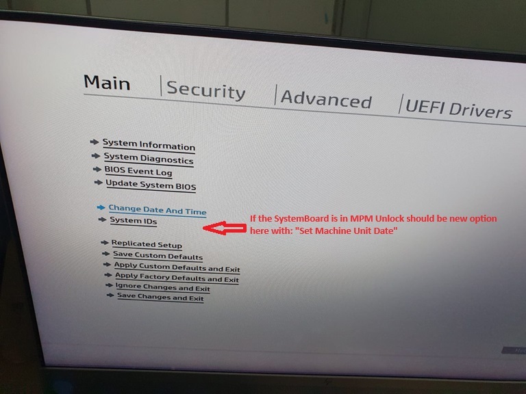

              This BIN file removed the BIOS information as Serial, SKU, Feature Byte, Build ID, but not turn on the MPM and I cannot edit the informations.
              Manufacturing Programming Mode
              Unlock
              *Lock
              Could you help me?

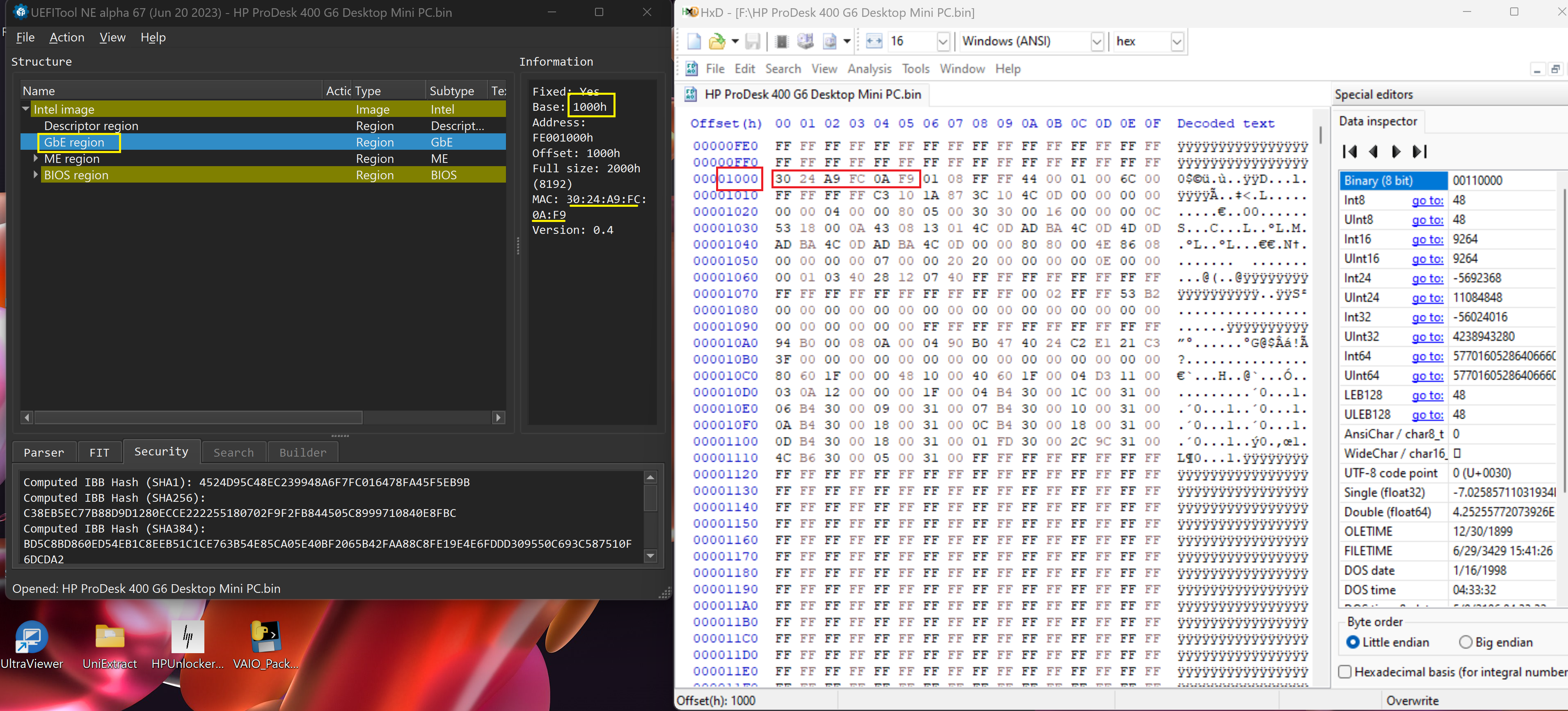

              And also is posible edit the MAC Address for each unit to avoid have 3 units in same network with same MAC Address that can cause mac conflit.
              I really appreciate if you help to find these two below information in the BIN file that I can edit with information of each machine?
              Integrated MAC Address 1
              30-24-A9-FC-0A-F9
              MS Digital Marker
              010000000000000001000000000000001D000000504E3743562D594B37514A2D504D5744572D56504238382D47564B4354

                          Now worked fine and the MPM is unlocked.
                          Thanks a million for help. You is the BEST!
                          Please, could you help me with more these information?
                          I need to replicate this BIN file to other two below units that are with corrupted bios and not complete the POST, but I want to save the original MAC Address and MS Digital Marker befoure apply this BIN file in these units. (It is to avoid network conflit if replicate same MAC Address in more units in same enviorement....).
                          Serial with corrupted BIOS: BRJ2412YRJ & BRJ2412X4M
                          Part: 6Z772LP
                          It posible read these two information from bad bios units and replicate this information in this BIN file that you changed? Similar of below information.
                          30-24-A9-FC-0A-F9
                          MS Digital Marker

                            Look th picture

                                  I want find this below information in the BIN file do save from bad BIN and apply in the new BIN file to avoid issues to active Windows after I replicate the BIN file to other two units.
                                  MS Digital Marker
                                  010000000000000001000000000000001D000000504E3743562D594B37514A2D504D5744572D56504238382D47564B4354​
                                  I tried to found in the BIN file, but I not located this information....
