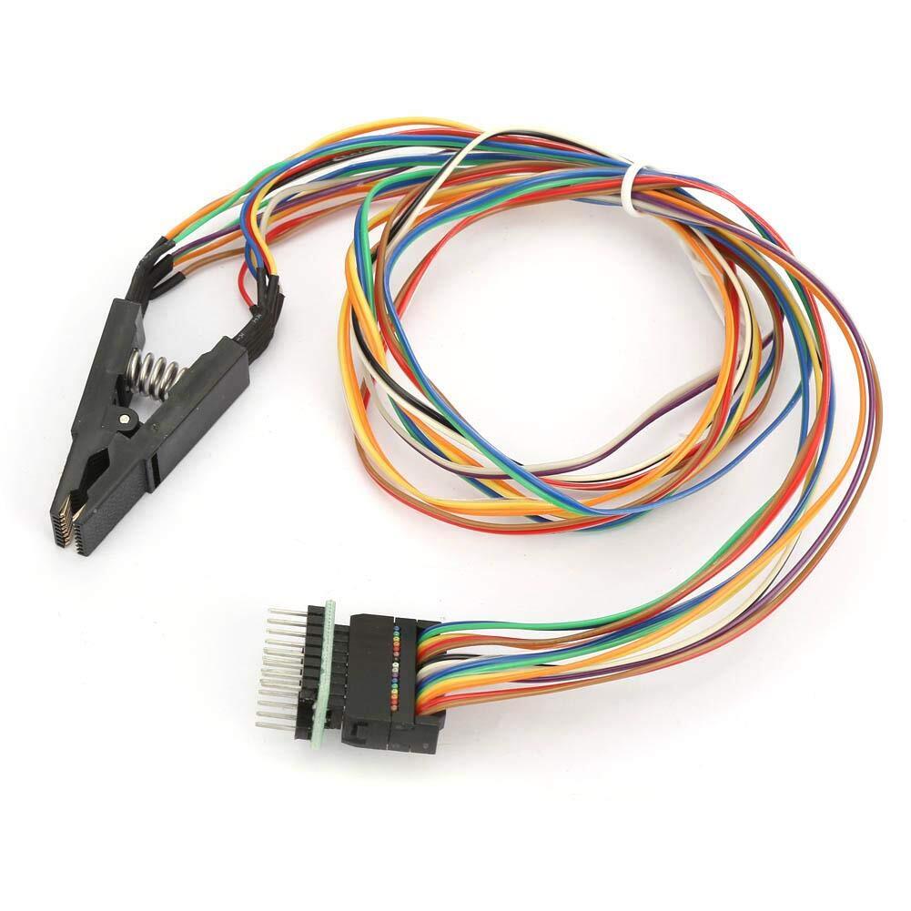

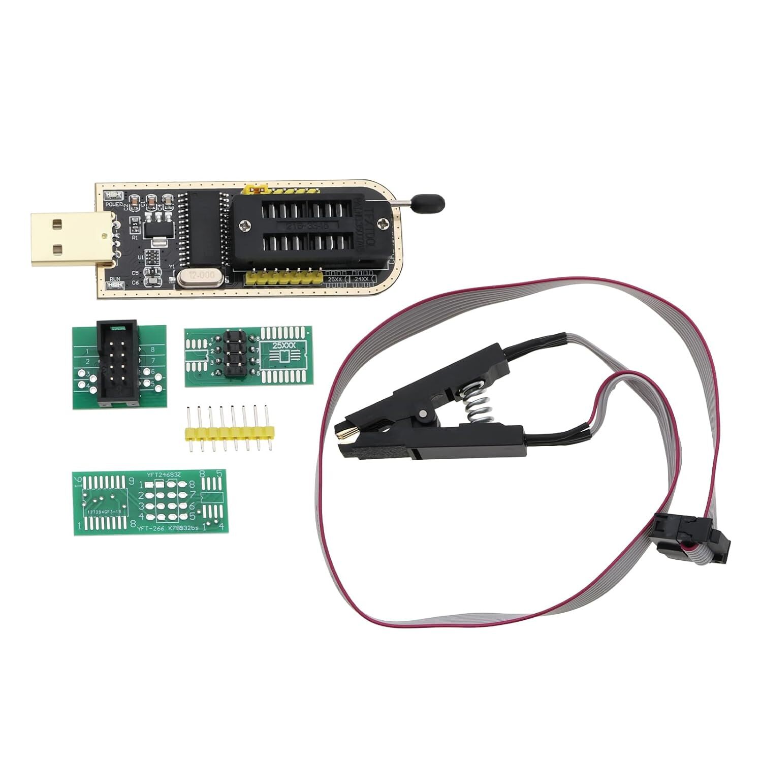

          here are the steps that worked for me:
          1- CH341A with SOP8 adapter for the 25series chips(bought on amazon) & SOP16 clip (bought on amazon). Check if the jumper on the CH341A is in "programmer mode" (jumper betweeen pin1-2)

          2 - Check the pinout of the SOP16 clip with a multimeter to find out the PIN no 1 (set the multimeter in ohm measure or continuity)

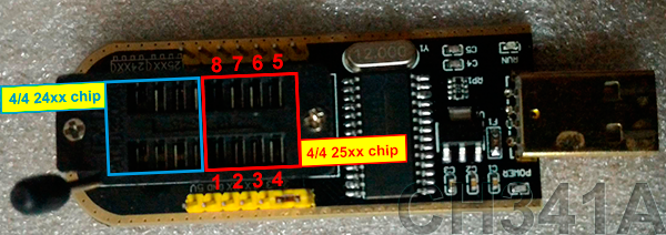

          3- Connect the SOP16 clip to the SOP8 adapter (i used dupont wires) to the corresponding pin:
          8 PIN CH341 programmer -> 16 PIN SOP Testing Clip
          1 -> 7 (CS)
          2 -> 8 (MISO)
          3 -> 9 (WP)
          4 -> 10 (VSS)
          5 -> 15 (MOSI)
          6 -> 16 (SCK)
          7 -> 1 (HOLD)
          8 -> 2 (VCC)​
          Connect the SOP8 adapter to the CH341A. The 25 series pins are the 8's closest to the USB connector:

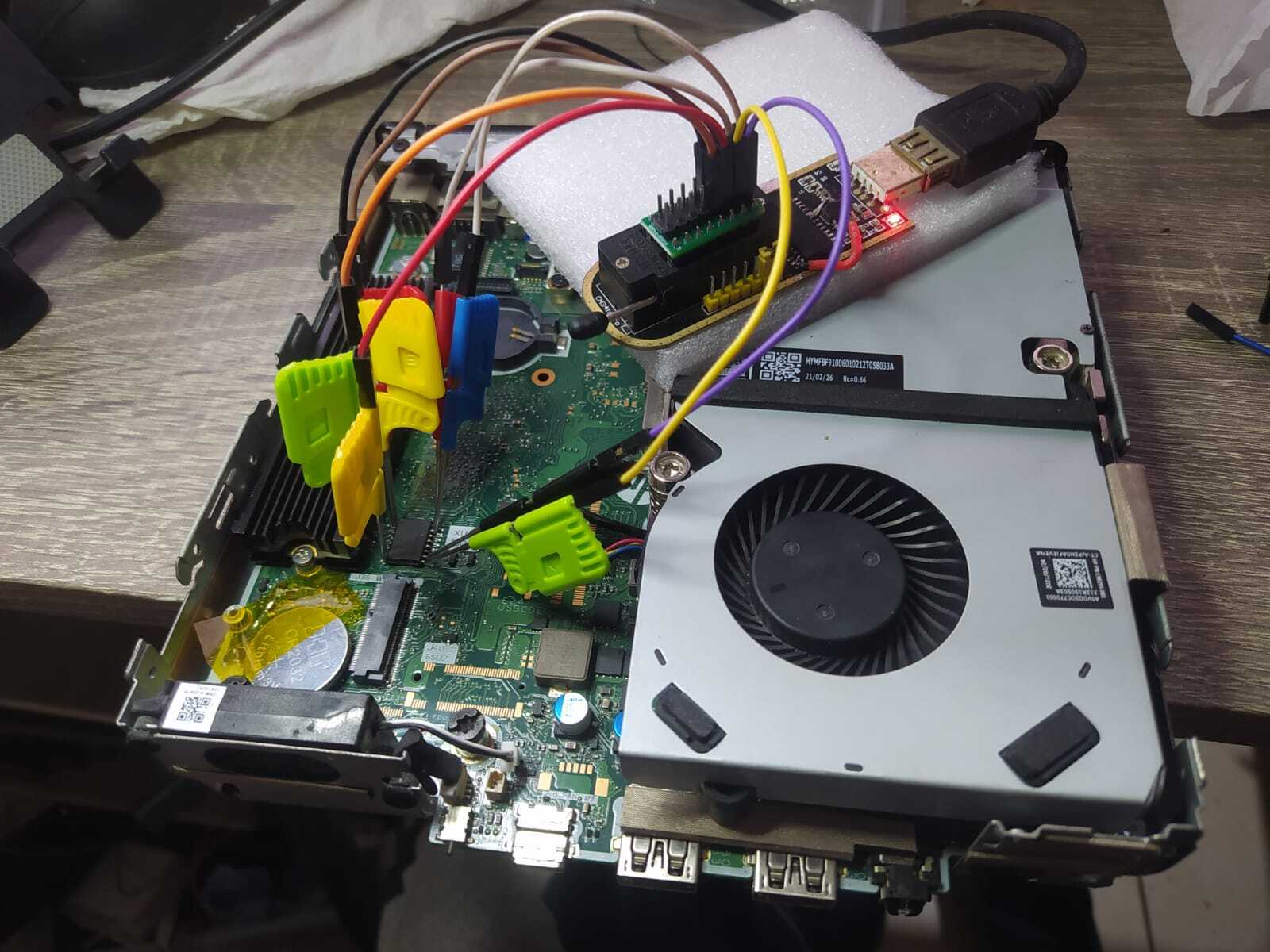

            hello everyone
            thank you very much for the steps raffa555, helped me a lot but unfortunately the tweezers did not work for me,
            i buy both versions,the one with all the connections and the 16 to 8, luckily i ordered some mini tweezers as a last resource and it worked, i could extract the bios
            can you help me to remove the password?, i bought without asking if had a password, i already tried rcunlocker but tells me "wrong chip"
            thank you very much for your time
            serial no. 8CC11026R5
            product no. 359P8LS#ABM​

                it works!!!
                thank you very much hoaca388​ , after hours of trying to flash it and with errors, was achieved
                I dont know how they do it, but they are the best!!
