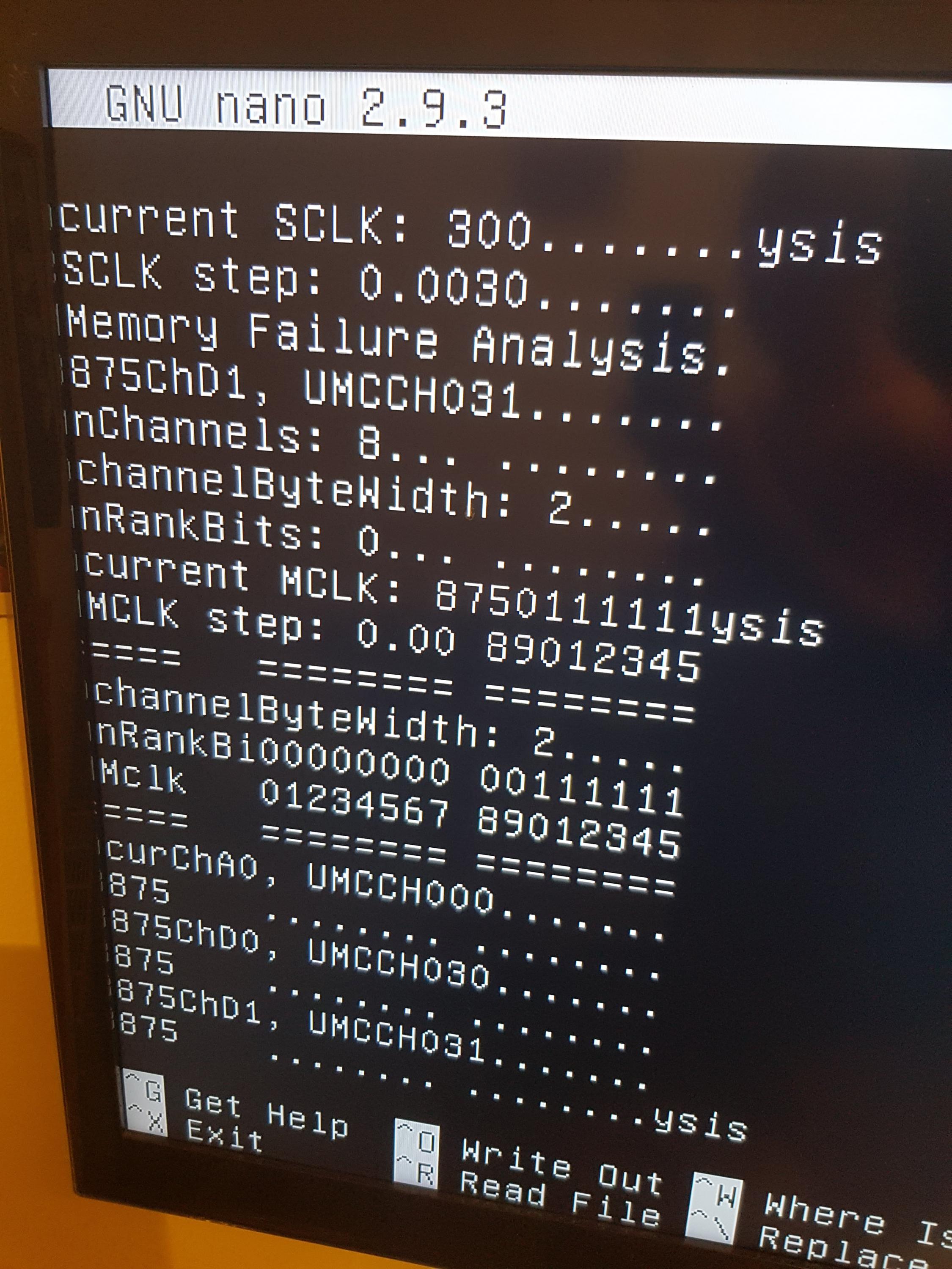

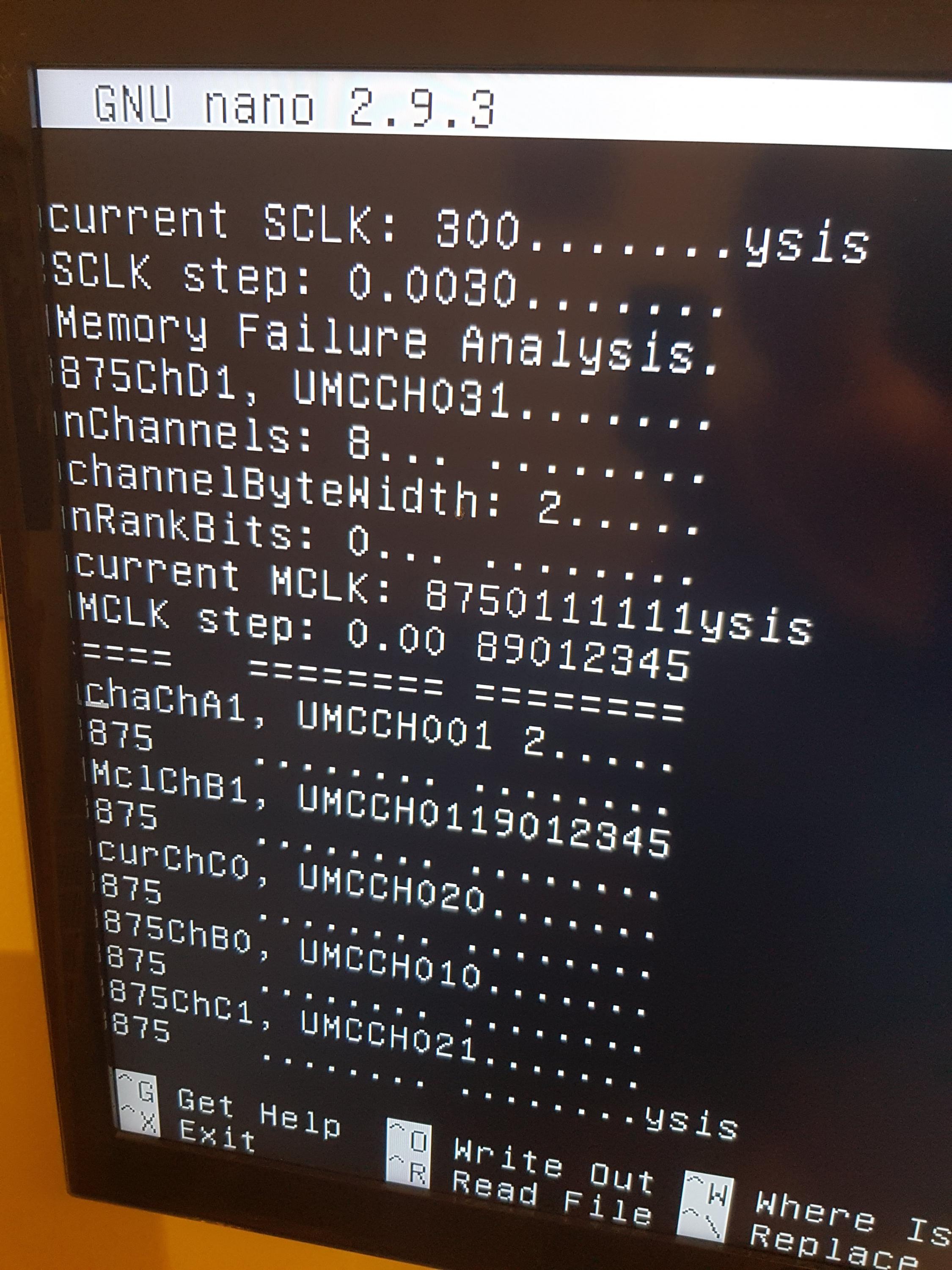

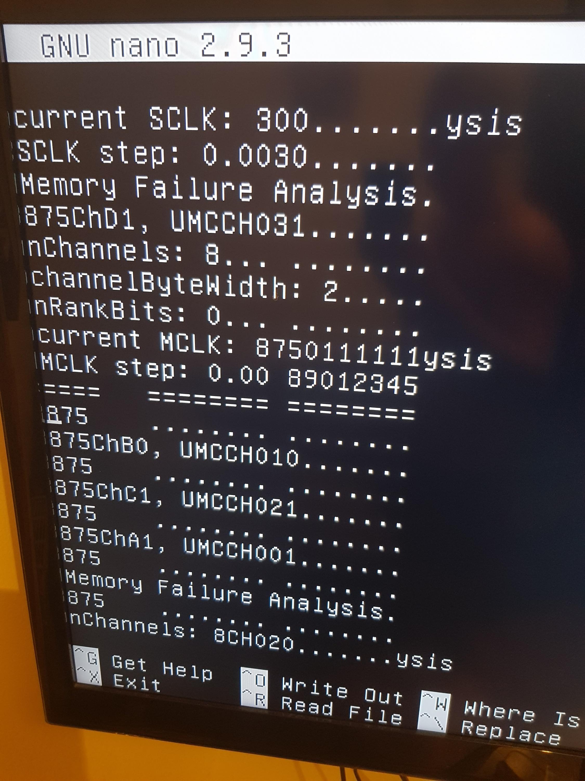

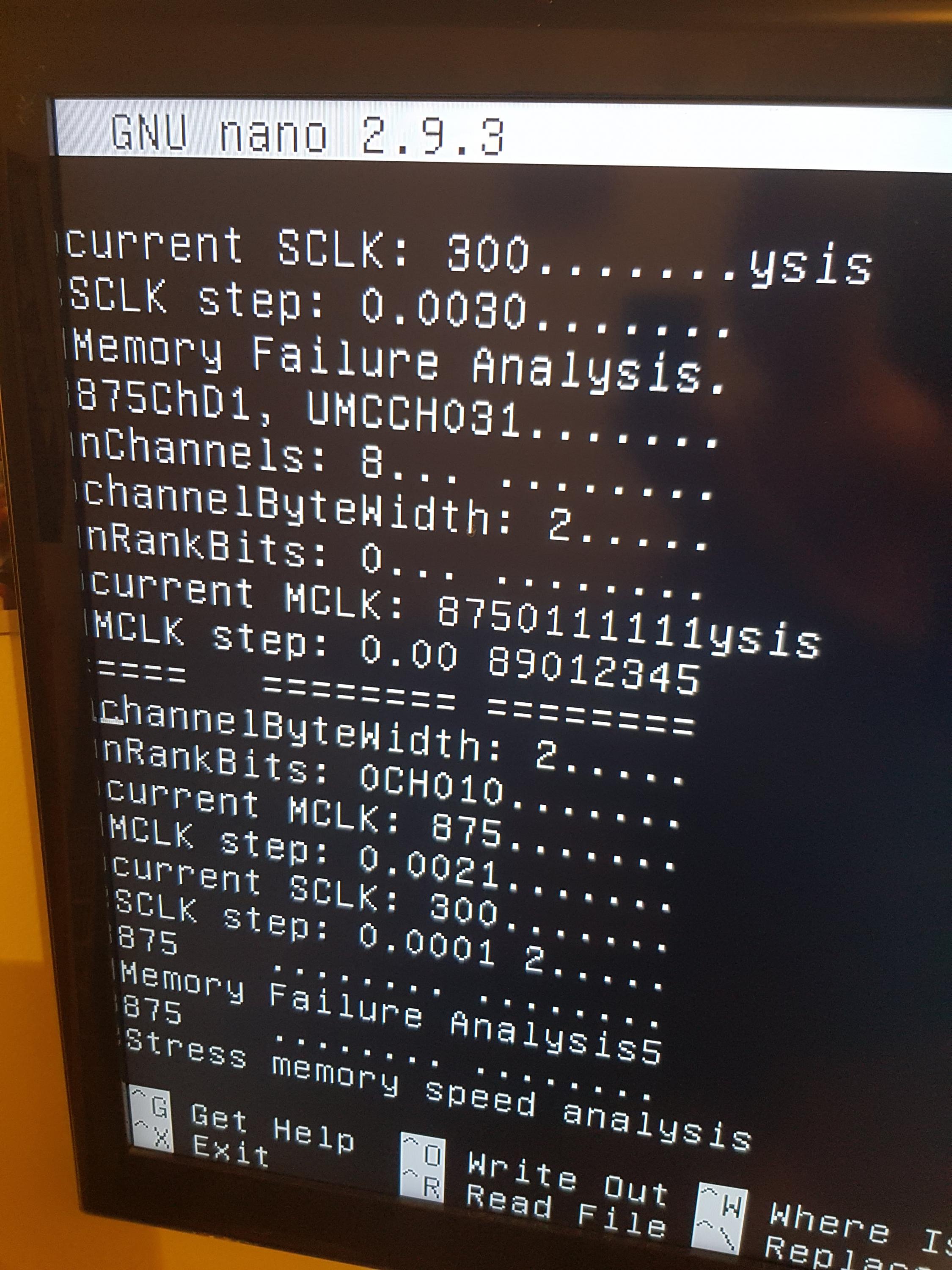

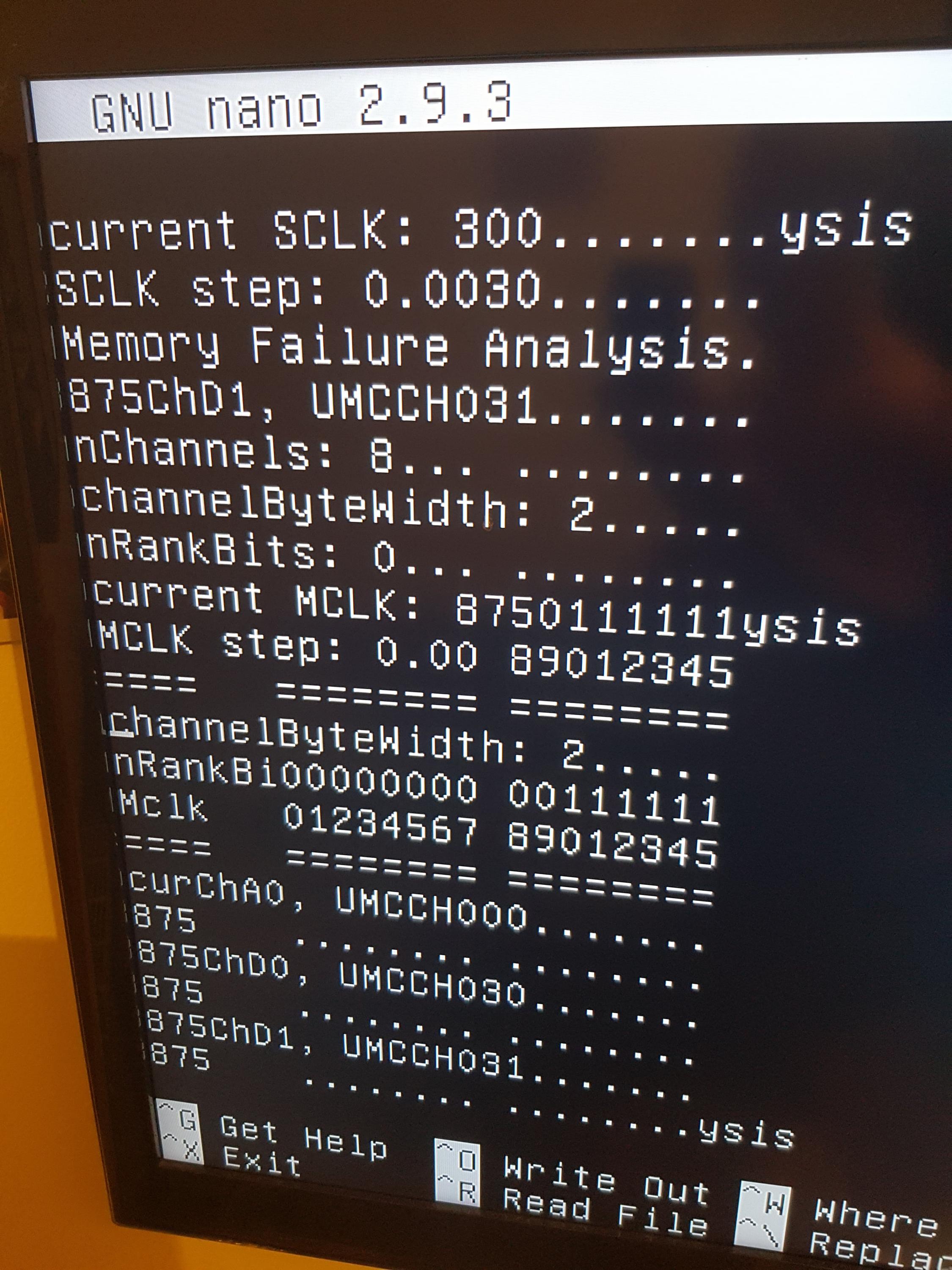

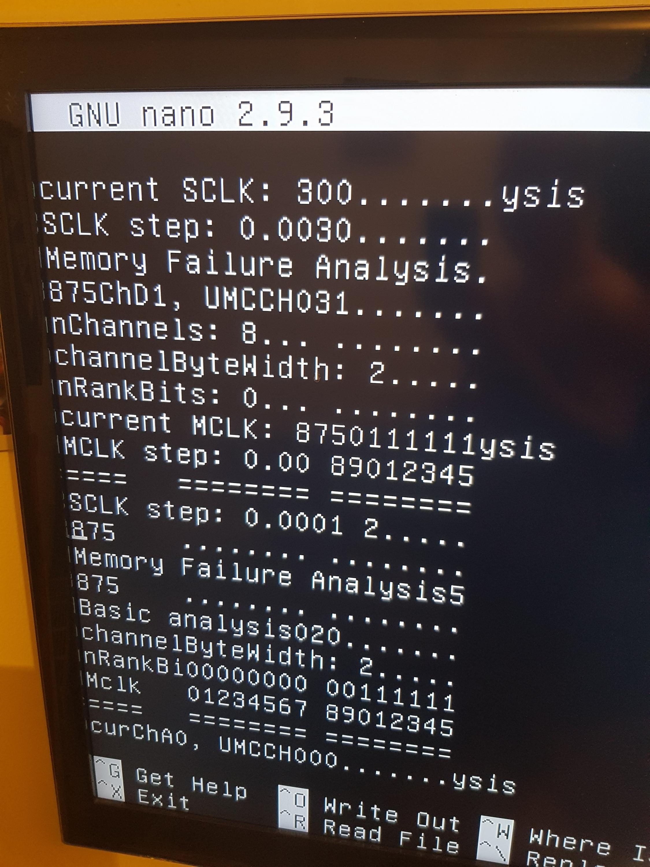

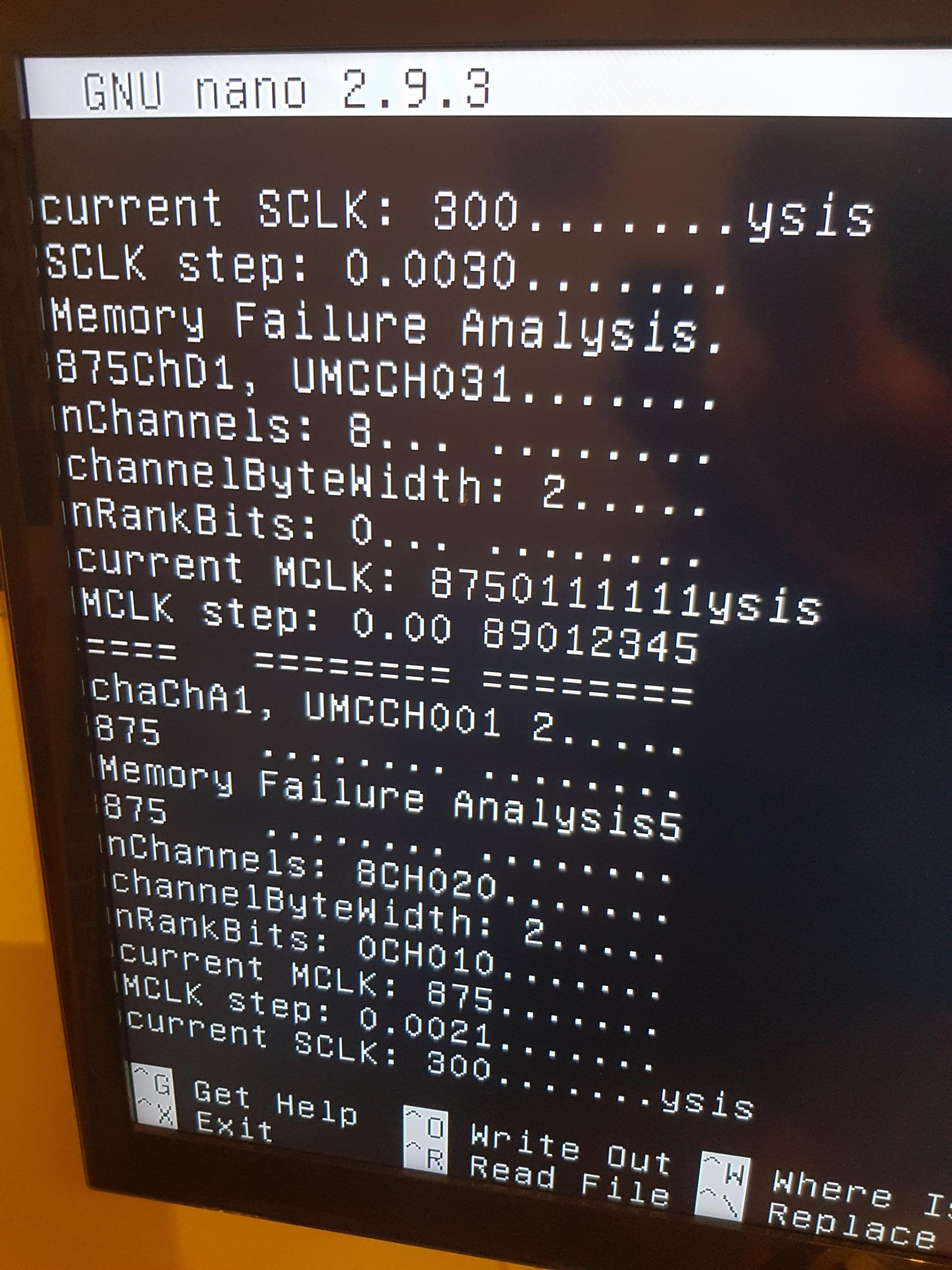

    I got the gpu RX5500Xt 8GB from my brother to fix it, it always crashes when the drivers load. I've now done a memory test with Tserver, but I'm too stupid to understand it properly if anyone thanks

    Re: Interpret Rx5500xt Faulty Ramtest Tserver
    it is just badly formated.
    try less viever
    less report.txt
    u have bad chip on positio B1
