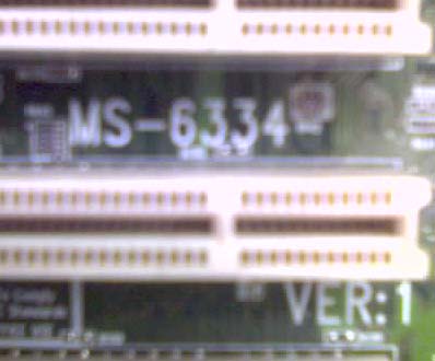

    Hi all!
    Mainboard MSI MS-6334 bad cap EC4, EC5, EC11->19.
    I desolded for long time and now I don't know which value for each one.
    Pls check and show me value!!!!!

    Re: MS-6334 need help!!!!!
    Originally posted by kids
    Hi all!
    Are you sure about that board number? I've been to MSI's website, and they don't list that as a product. There was, however, a MS-6330, MS-6337, and MS-6339.

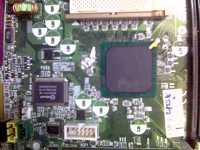

        • kids
          • Oct 2005
          • 13
          Re: MS-6334 need help!!!!! -Pics
          Here my Pics but it's so bad!!!

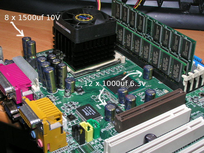

            the ms-6337 which is also an 815 chipset board used 8 x 1500uf 10V in region of the cpu and 10 x 1000uf 6.3V in other places. Here is a pic. The rest of the caps were very small

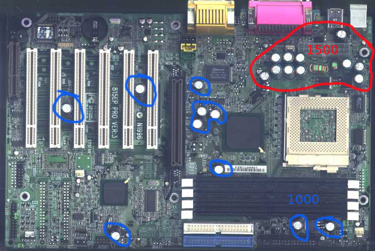

              so if you dont get better assistance on this board then i would say to recap all caps between the CPU and the ports with 1500uf 10V and the rest with 1000 6.3V.
              there would probably have been a few caps near the cpu which were actually 1000uf 6.3 but it is safer to replace them with 1500uf 10v because we are not sure of their positions. there would be no problem with the higher values.
              check the below diagram for an example using the ms-6337
              post a pic of your board like that for final checking
                Thanks for your help!!! I'm trying. Hope it's working.
                Here my way:
                EC11->EC19 : caps 1000uF-10V (10x20mm)
                EC4, EC5: 1500UF-10V (8X23mm)
                OK???
