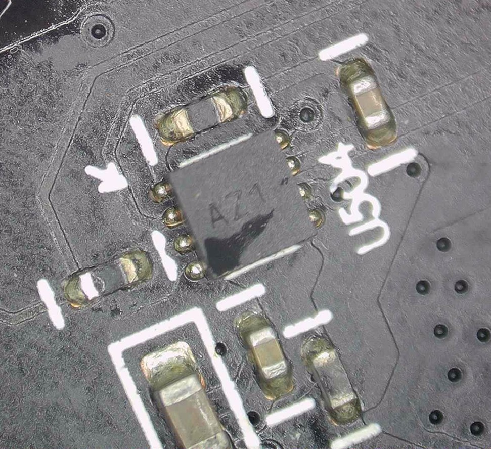

    Hi all
    Trying to identify this mosfet driver ic on my XFX RX470 8gb. I don't have the schematics or boardview to assist. The markings on the IC are AZ1. See picture.
    If anyone has the schematic or board view I would much appreciate it if you shared it! 🤞
    Failing that, is there anyone who can help identify this component?

    It might be a NCP5901B ?

      Edit; R_J got it

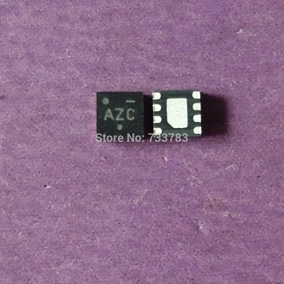

      It might be an onsemi NCP5901B .Can you put some IPA on the chip and look for the other markings like in the picture https://ae01.alicdn.com/kf/HTB13swaL...ET-Drivers.jpg
      https://www.badcaps.net/forum/showpo...37&postcount=7

        Perfect! Thanks all! ��
        Great link to the code also! ��
