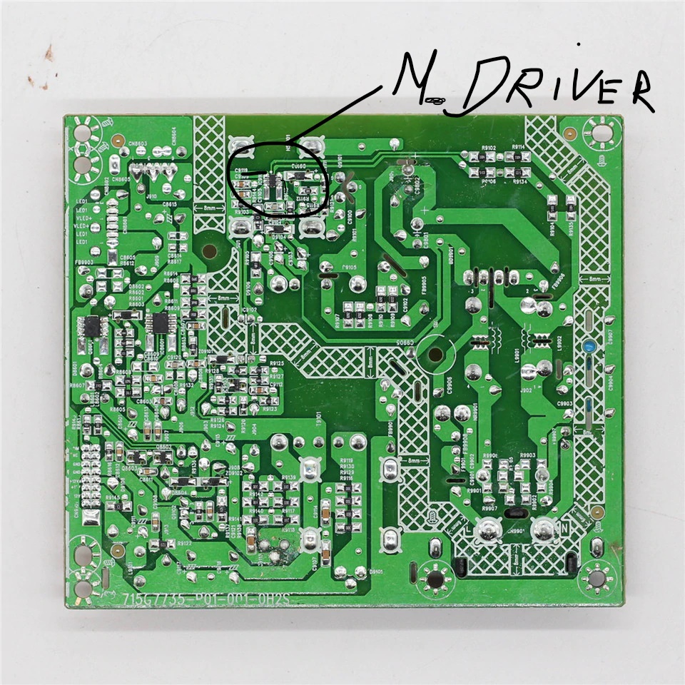

    So this is not the first time i find a mosfet driver shorted. I am talking about the mains to DC conversion circuits. In this case its a TV , I found a shorted mosfet , shorted safety capacitor and the power resistor was open. I replaced all of those but later found that two of the pins in mosfet driver were shorted aswell. Now this is a big road block for me , as people are no willing to wait for a month for a specific IC to get shipped from china to repair their TV , Is there another solution to fixing this problem? I have some other mosfet drivers laying around and what are the chances of them being interchangable? Assuming they are made for same purpose(which they are , i found another TV power board).
    In this case i have a 6005a Driver which doesnt have any datasheet online as far as i know. They can be bought on aliexpress but as i said its not really an option. Also i saw a video online that a driver can be replaced with 2 transistors in a circuit designed to switch them on and off. But i dont really have the knowledge of doing that properly also i do not want to waste too much time on a repair job that will grant me 20$.

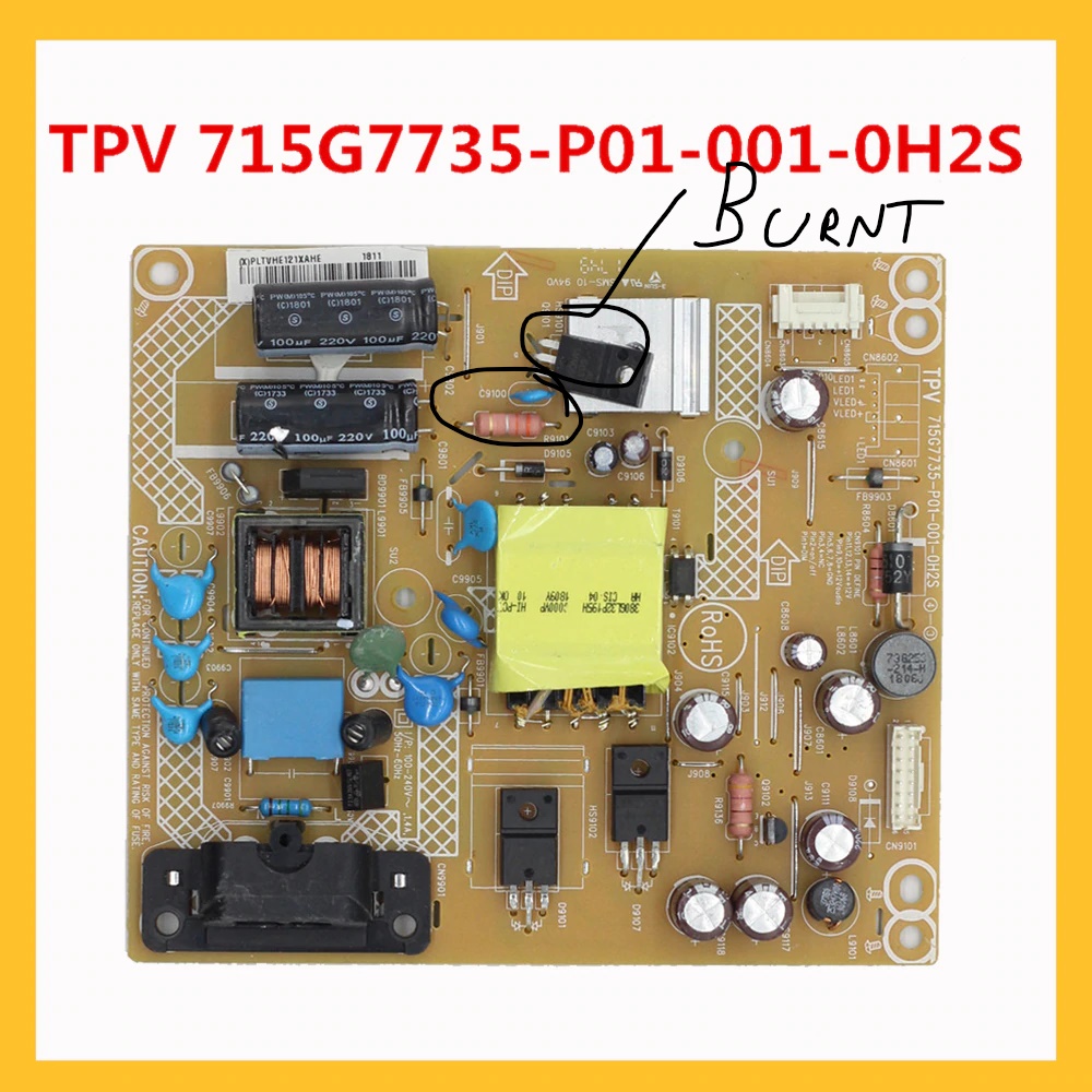

        Re: Mosfet driver trouble replacing 6005A
        so here it is ... i marked what was burnt on the board... i Do have a power board from another different TV that has a driver on it , so i was thinking of just puting that in place .. i know its a slim chance that it would work but worth a shot.
          PF6005AG
          and some guy says "the pwm driver is "PF6005AG". I replace it with "PF6003AG" which has more driver capabilities."
          https://www.eevblog.com/forum/repair...lcd-tv-repair/
            Unbelivable STJ , i have found a schematic , and i also found a local seller selling it for 5 bucks with name 6003AG ... Absolutely amazing .. You might just have saved this TV STJ... Props to you man really... i ordered them immediately
