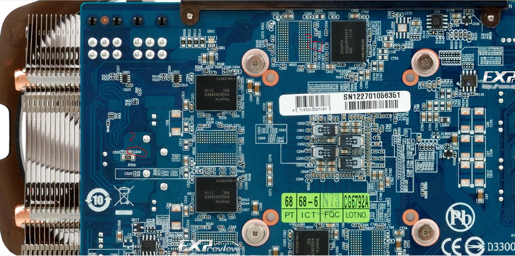

    Hi Guys!
    I have a Gigabyte GTX 670 2GB vga and this GPU dont show picture when pc is booting.
    If I start the pc with integrated vga, windows detect this card as GTX 690 and I can install the nvidia driver. After that the GPU is working with issues.
    I tried to flashing bios to original version but nvflash got error message: PCI subsystem mismatch.
    After that I put the bios file via eeprom writer but nothing changed.
    Have anybody some suggestion for this?

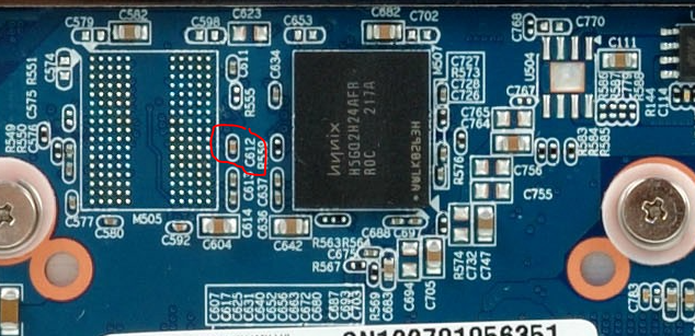

      I read in another topic (https://www.badcaps.net/forum/showthread.php?t=102811) that the reason for the incorrect recognition was a missing capacitor.
      So I was check my panel and I found one problem: C612 is broken.
      Anybody knows which is the correct value of this part?

          I found one more missing capacitor. This is C854.
          What should we use instead?

              I replaced the missing part and now it looks like GTX 670.
              But there is a problem, the GPUz can't see the vram. (0MB)
              And MATS crashes (freezing) when I run it with this gpu.
              I think this is memory fault but I don't know which module wrong is.

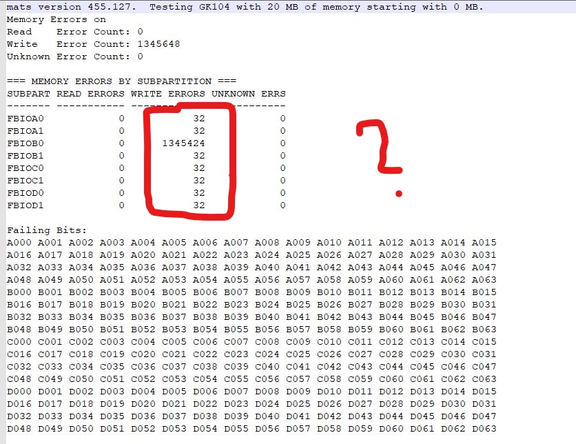

                I resoldered some parts and then I got image with artifacts and I run MATS.
                Can I get some help for understanding the results?

                  For me it looks like two separate problems. One memory chip seems to be failing, the other errors not likely to be memory issues, but some general issue, eg. proper voltage supply for memory or memory controller (may be caused by partially broken vrm chip, look with a scope for the mosfet driving signals, if they are clear / rectangular, also the output of the mosfets). Would first exchange the one memory chip, and test again. Could be that the other low error number problems on the other mem chips will disappear after exchanging the mem chip. If not, the other issue could also be a partially broken or corrupted bios chip. Even if working and there is some traffic on the bios chip lines, I'd try to exchange it. I had one card with errors on all chips, and this helped. Both cases are described somewhere on this forum. Look also this video: https://www.youtube.com/watch?v=9M2K...ist=LL&index=5
                  Regarding the identification of the physical mem chip you have to count the chips counterclockwise, and consider, that the chips on the PCB are always in pairs (High/...1 and Low/...0), but the first chip is the High one, and the second is the low one - exactly contrary to the sequence in the Mats table, where the first is the Low one and second the High one, the third is High again, and so on.

                    Correction: ...where the first is the Low one and second the High one, the third is Low again, and so on
