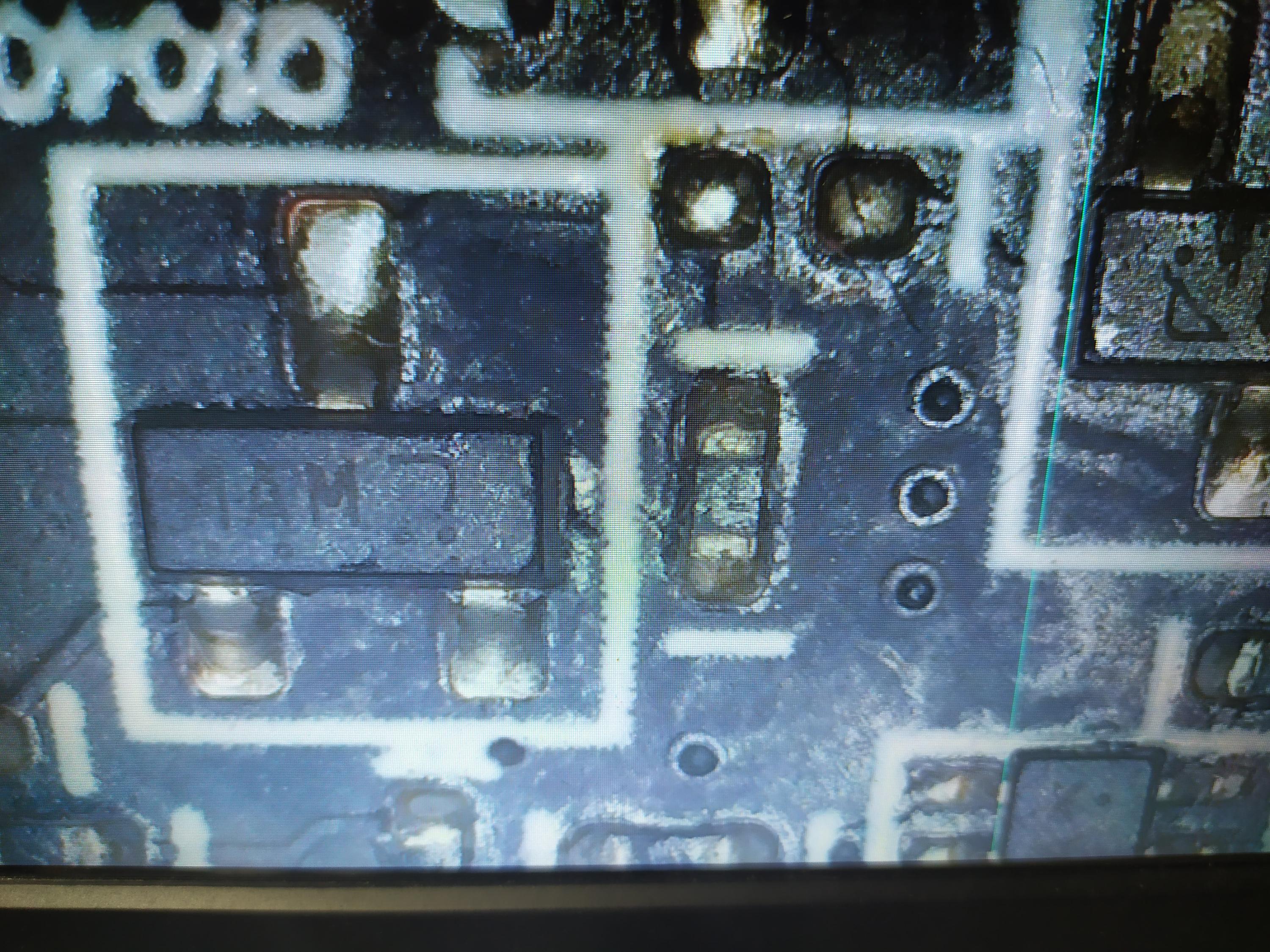

    Hi guys
    Can anyone identify this component U100
    See the video at 38mins 20secs (microscope close-up)
    https://www.youtube.com/watch?v=lgQirxbbov4
    It connects to the SMRESET signal coming in from the PCIe pin 11 and is presumably a logical AND gate or dual transistor/FET

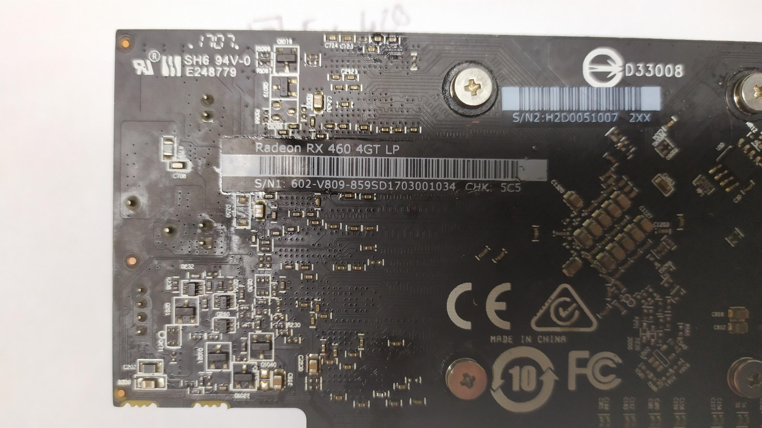

    Dicky,
    I have two of those exact cards, 1 working and 1 dead.
    The resistor does not go across them two pins but goes down instead, see attached image
    If you want me to measure anything or take photos of the area with possible parts missing let me know

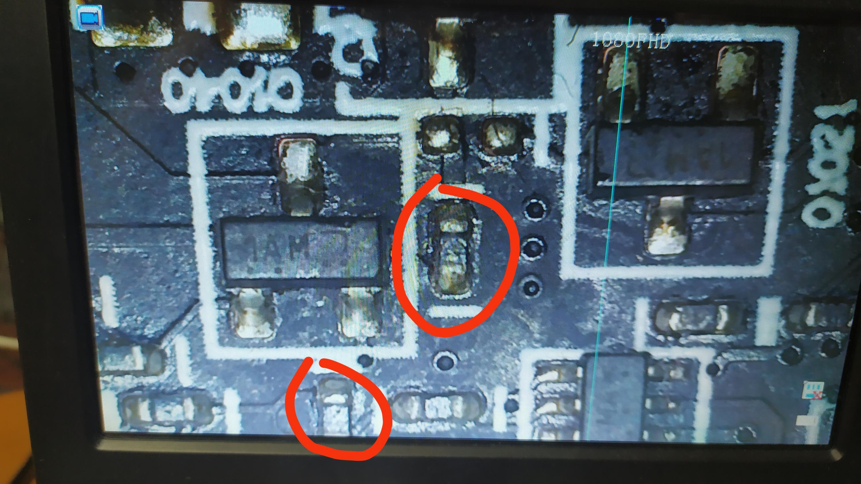

      Re: Possibly burnt/damaged component U100 on RX460 - can anyone identify?
      Just noticed another resistor missing below the 1st one and u100 has the same markings as the working card so don't think it is a burn/scorch mark

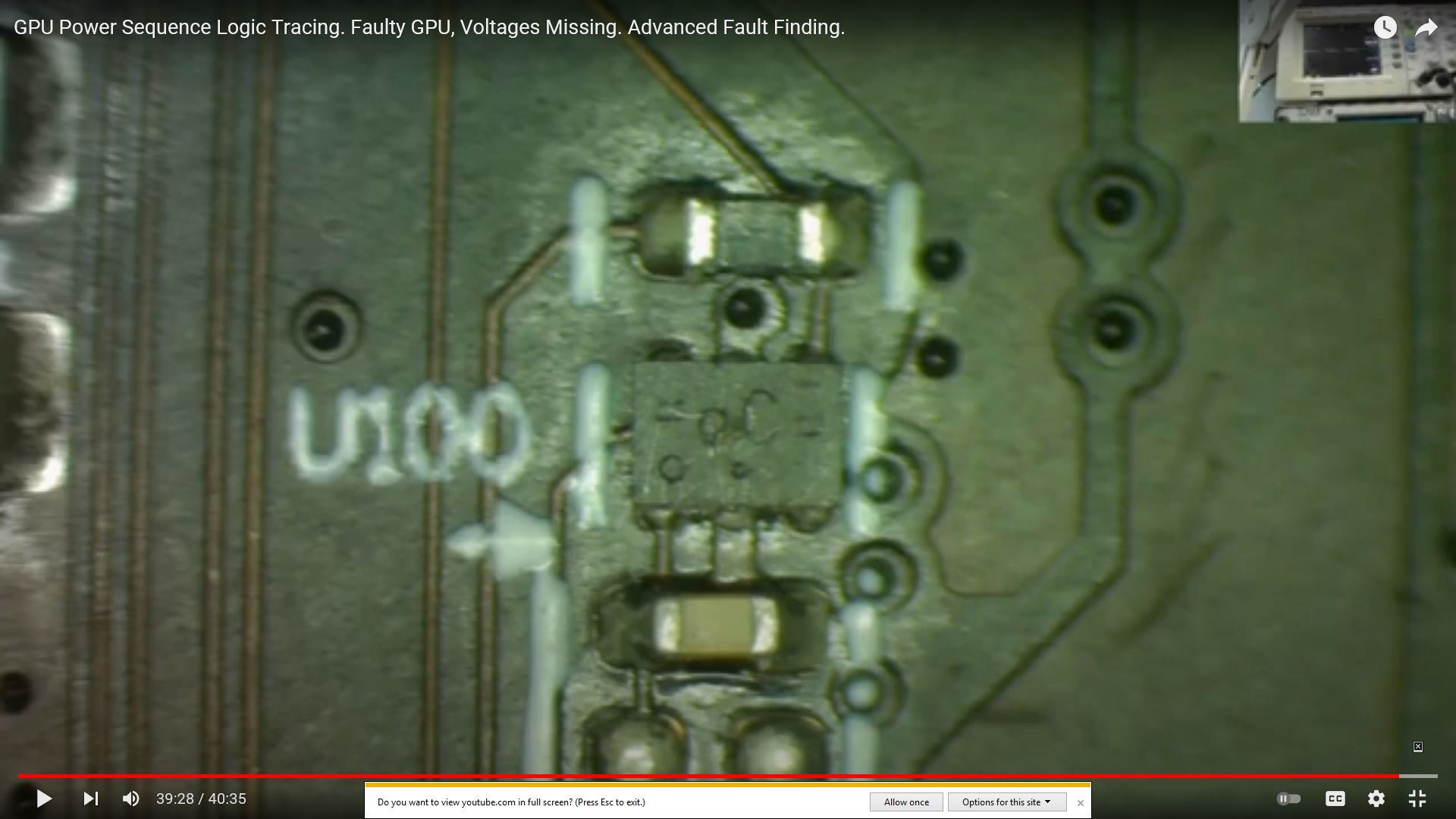

          Here is a capture from the video of U100
            @R_J
            Yes that is the part - anyone know what it is and any advice if it is damaged or not? It's a bit clearer to see on the original video, make sure you select 1080p in Youtube
                  It could be a 74AUP1G57GM sot886 (XSON6) Marking aC

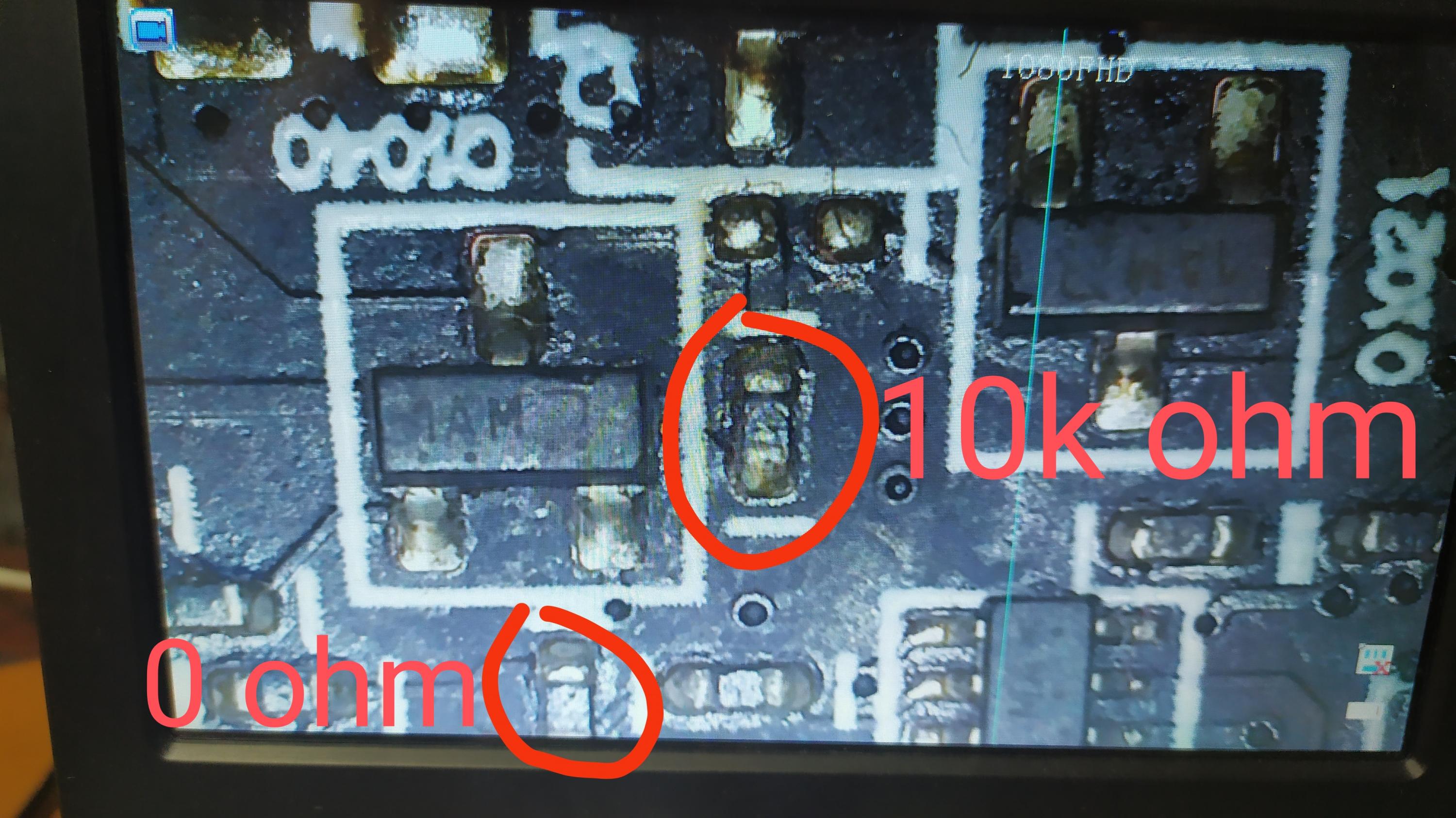

                    Hi Dicky,
                    The top one is a 10 k and the bottom is 0 ohm.
                    I will get some readings from u100 later for you to compare to.

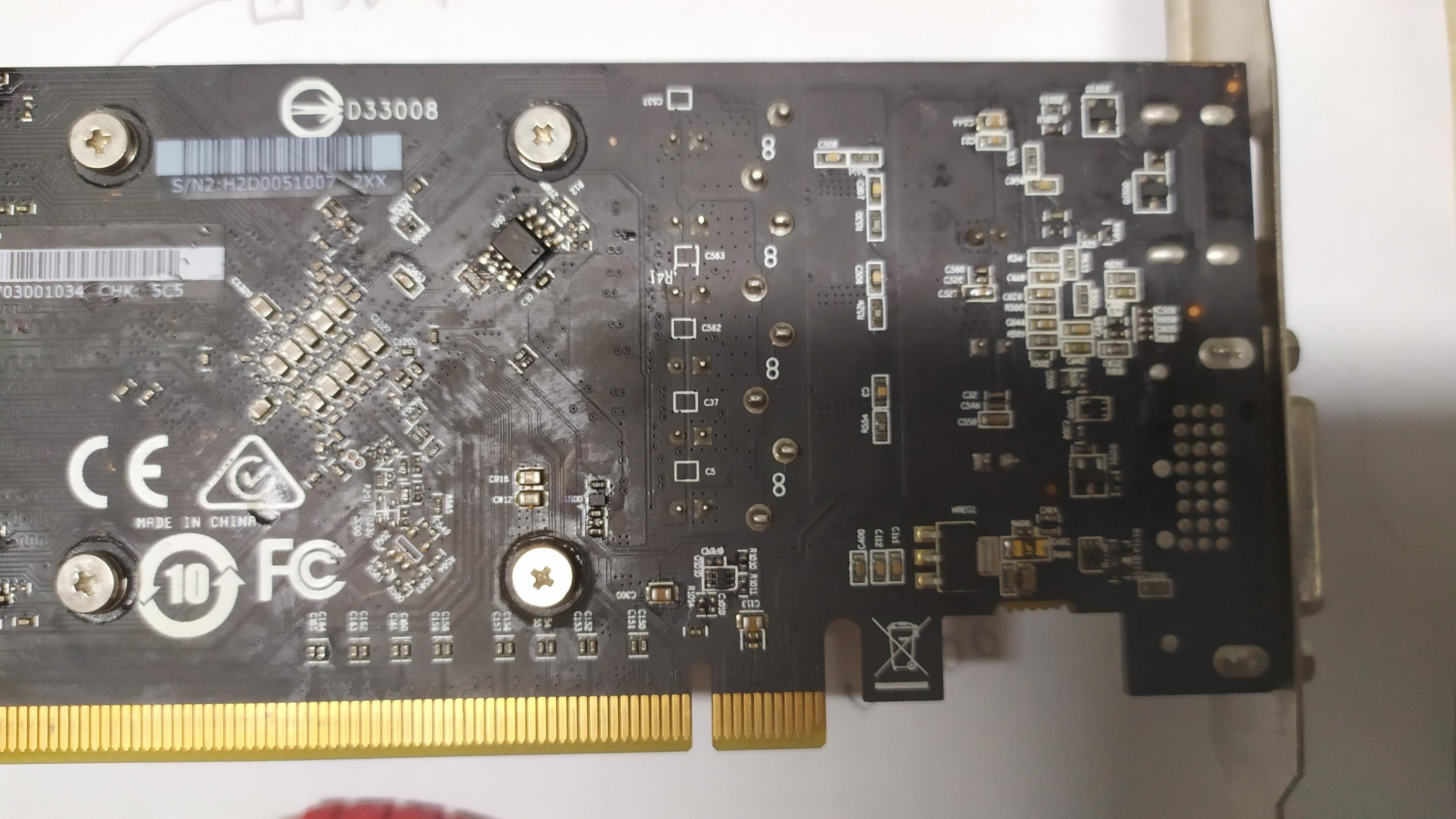

                    • Scotchmist
                      • Apr 2019
                      • 60
                      • United Kingdom
                      Photo of board, hope they are clear enough
