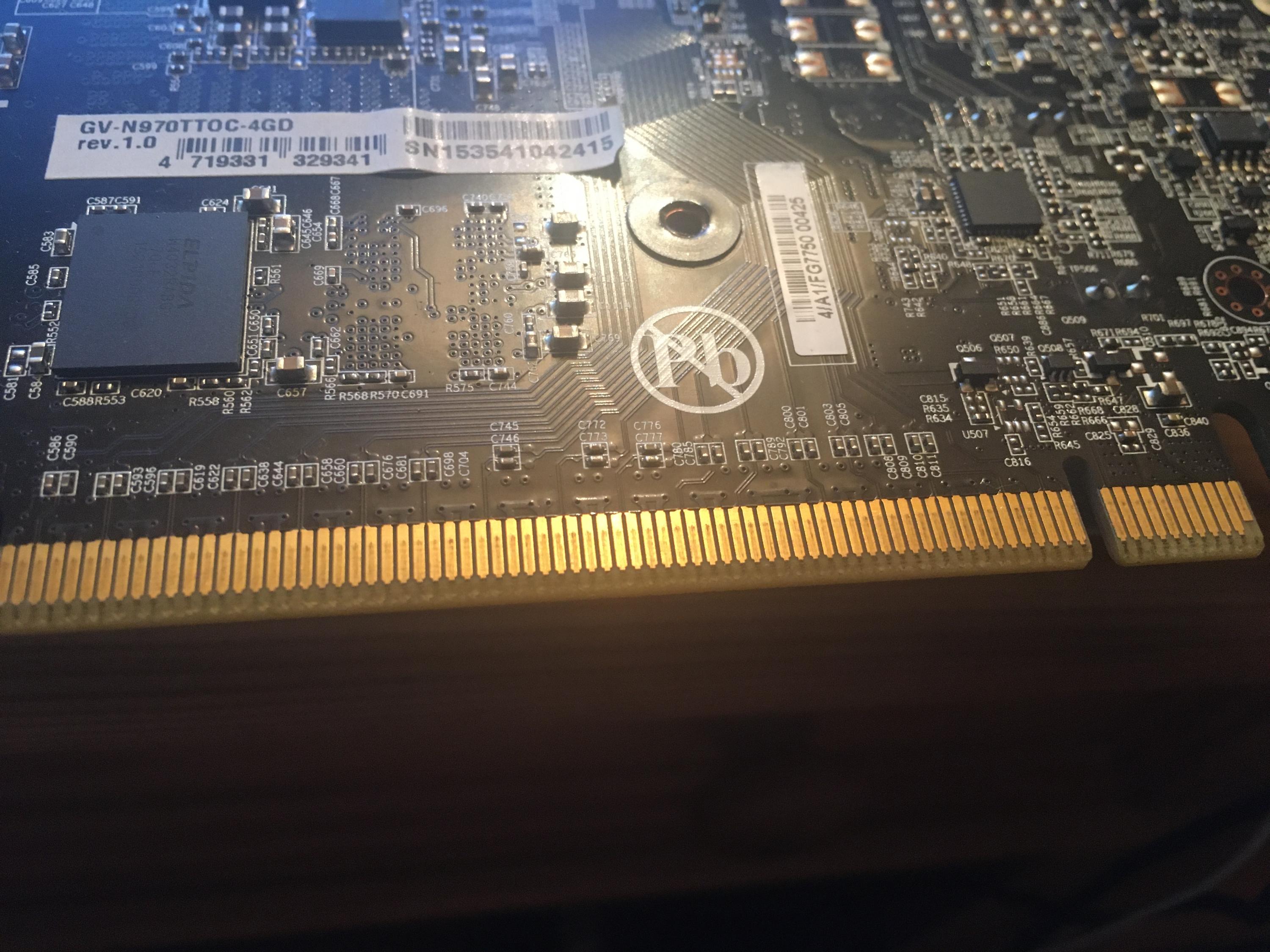

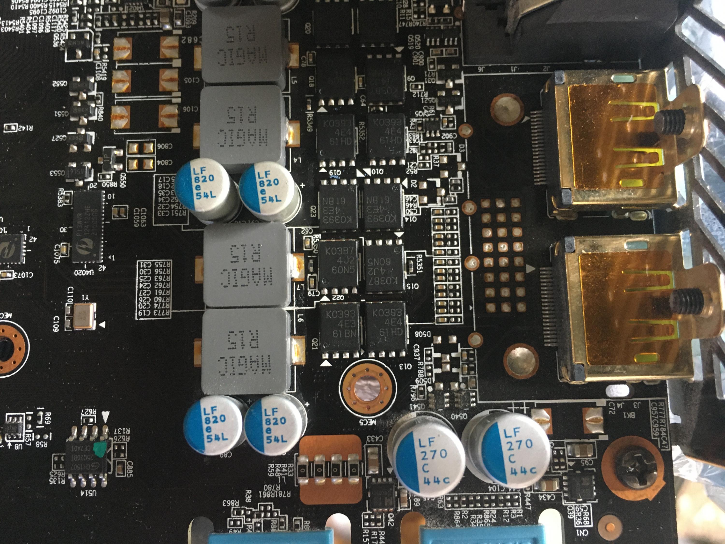

    Hello. So I think I damaged this board when I was attempting to use it with a riser - my memory of it is not great - the lesson I think is to not fiddle with such things after having the final vaccine jab.
    So now the fan spins, but it is not detected in windows at all. There are no burn marks on any of the IC's, having checked with a microscope. The only thing I did see was the look of grimy greasy stuff near one of the big capacitors, also one of the small caps is dented.
    So I would love some guidance on confirming the caps are bad (currently have a multimeter), anything else to look for, and identifying the caps so I could replace the dented/bad/leaky ones. Image is attached.

    I usually don't see caps fail like that on upscale video cards. (at the time of manufacture) Reminds me too much of the dreaded Sacon FZ!

        Check the tiny little MLCC capacitors by the PCIe connector - you may have damaged or broken one or more of them when using the Riser? That would cause the GPU not to detect.

                  I doubt you would get a reading on the tiny little capacitors, it's more the case that they can gt broken or knocked off the board with a bit of rough handling. If they zre all present I am sure they are OK. If any are missing/broken generally the GPU will not detect.
                  Have you checked all the voltages, Vcore, Vram, 1.0V (Pex?) 1.8V.....

                    Hey thank you for the reply, and yes absolutely no chance of getting a reading off them, they all look to be present and correct c816 doesn't have a capacitor, but it looks like it never did.
                    I have looked at some voltages and resistances and got some values but not entirely sure what would be right and what wouldn't be good or indicative of damage.

                      Basically you can see that each PCIe 'lane' is a differential signal (two copper traces) and this is where the capacitors are connected. You would not expect to see anything much in the way of voltage here. It's a form of LVDS (low voltage differential signal)
                      Probably the only meaningful measurement you could take here is if any of the capacitors are short circuit , which may happen if they have a hairline crack. Most likely if they look OK they are OK. I would say that the resistance readings you get should be the same for all 16 PCIe lanes.
                      These signals all go to the GPU so if something is widely different on one or more of them this could also indicate a GPU fault.
