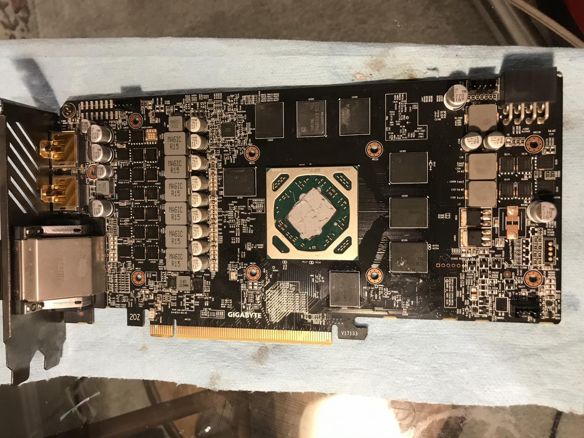

        Have a look at the board without the plastic shield & fans, maybe a few bad caps? bad thermal grease? Post some pictures.

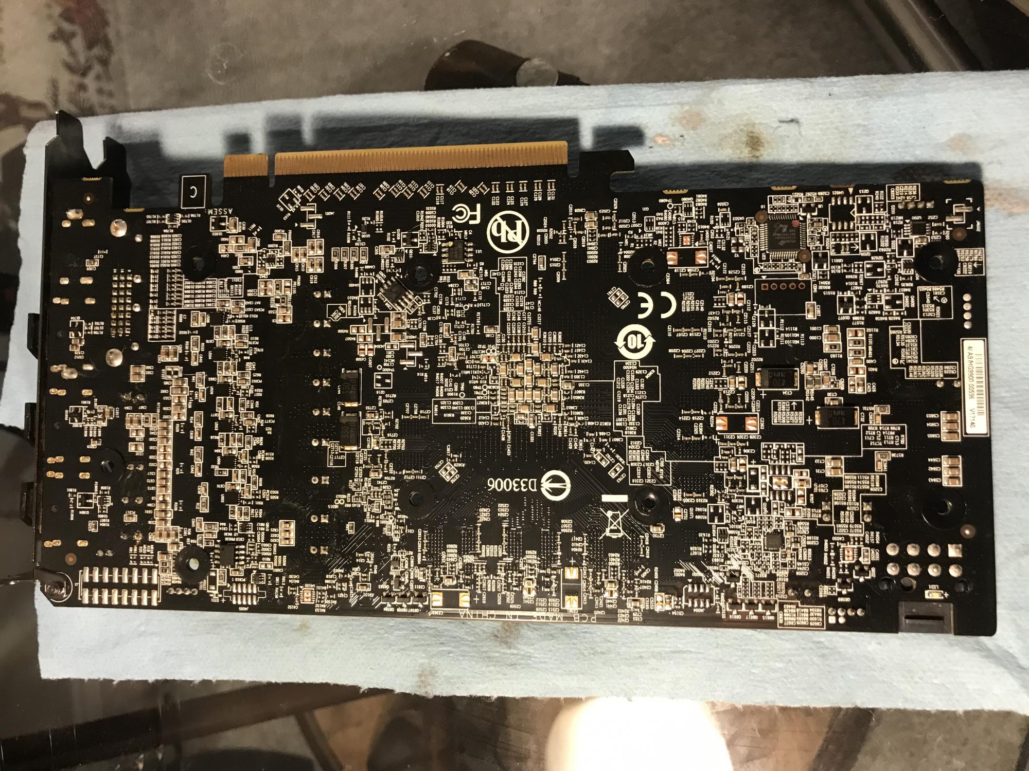

          i replaced the fuse again and powered it up without the back plate so i can take measurements.
          note on the backside lower right, i removed a sop-8 LM358 dual amplifier. i thought it was giving weird values. the vcc is supplied by the 12v rail.
