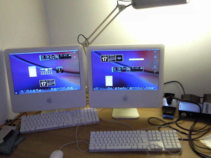

    Hi all.
    Just received a 1st Gen Imac g5 17".PSU is dead due to blown fuse.Part is this:http://gb.mouser.com/ProductDetail/L...P7/gXKoBvNe7k=
    The lead time for this is 12 weeks!,searched all my sites in UK and they are the same,does anyone have a spare er,floating around?,if so I will put you on my Xmas card and favourite person forever list!.
    Happy Xmas,
    J-P.

              Arghhhh,I don't know,just got it today,opened up Imac no LEDS lit up,no blown caps,though it looks like a refurbished LB,due to the existence of larger caps which in my experience,they are usually all the same size.
              Chucked in my spare PSU,part no:614-0333 and started up ,installed 10.6,ran CPU Test 2,ASD,all fine.Turned to original PSU.No output voltages on jumped leads.Opened up PSU,no blown caps,then found blown fuse.
              Conclussion,power surge could have caused this on non UPS/surge protected system,or original owner tried to power up system on non isolated enviroment.
              In which case the PSU might have saved itself further damage,but can't test without this fuse!.
              Very frustrating.

                      It's tighter than a Gnats chaff in there.Tighter than tight day in Tight Land.So as it looked so pretty in there and really nothing else would do,because it really is pretty,I half inched the same type and rating from an Intel PSU I had propping open a well thumbed and loved picture book of my prettiest fuses and popped it in there.
                      Gentleman,the rest is academic.
                      • deckart
                        • Sep 2009
                        • 67
                        Re: Generous soul needed!.
                        Photo.

                            Sorry Toasty,I couldn't answer your questions because I had no idea of the history of this Imac,just got it from Ebay in the UK.As said nothing lit up,caps looked good on the LB,so figured it was PSU.On taking it out smears were evident on the body of the Imac.On this Acbel the fuse is shrouded in a plastic coat ,so damage is hidden,just DMM tested,no continuity.
                            Just wander how/why it blew,like I said,power surge,anyway took a few minutes to replace and so far temps/fans(using Istat) and CPU levels are fine.
