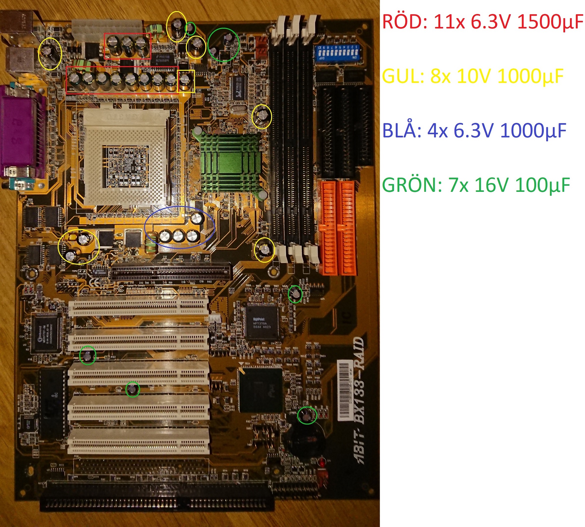

    I just bought a bundle with a Abit BX133-RAID, a 866MHz P3 (SL4CB) and a 256MB PC133 SDRAM stick, that the seller claims were working fine together.
    After building a rig out of it, with a known working PSU (Seasonic S12II 520W, for its good 3.3V and 5V rails), I get a good startup screen, but as soon as I try to enter the BIOS, it locks up with a blue bar across the bottom of the screen.
    I have seen one thread from 2010 about this issue specifically on Vogons, and the consensus there was that bad caps may very well have something to do with it, and although I can't see any visual damage or bulging (maybe ever so slight on two of the 25+ caps), Jackcon from around the year 2000 isn't exactly promising. Every cap on the board is from them, their "B058 Low E.S.R." series, apparently
    From what I can tell, the board has, more specifically:
    11x 6.3V 1500uF 8x17mm* - Just above the CPU socket
    4x 6.3V 1000uF 8x15mm* - Between the CPU and the AGP port
    7x 10V 1000uF 8x15mm* - Surrounding the CPU socket and chipset, between it and AGP/DIMM/USB ports
    7x 16V 100uF 6x10mm* - Spread out, between PCI slots, between ATX power and DIMM sockets, close to CMOS batt,
    1x 25V 10uF miniscule :p - Next to Super I/O chip
    * I don't have a super accurate way of measuring them on the board.
    Any suggestion for suitable replacements? Panasonic FR's are probably the easiest to get a hold of here (through ELFA Sweden), but I'd be very grateful for any input!
    Thanks a lot in advance!

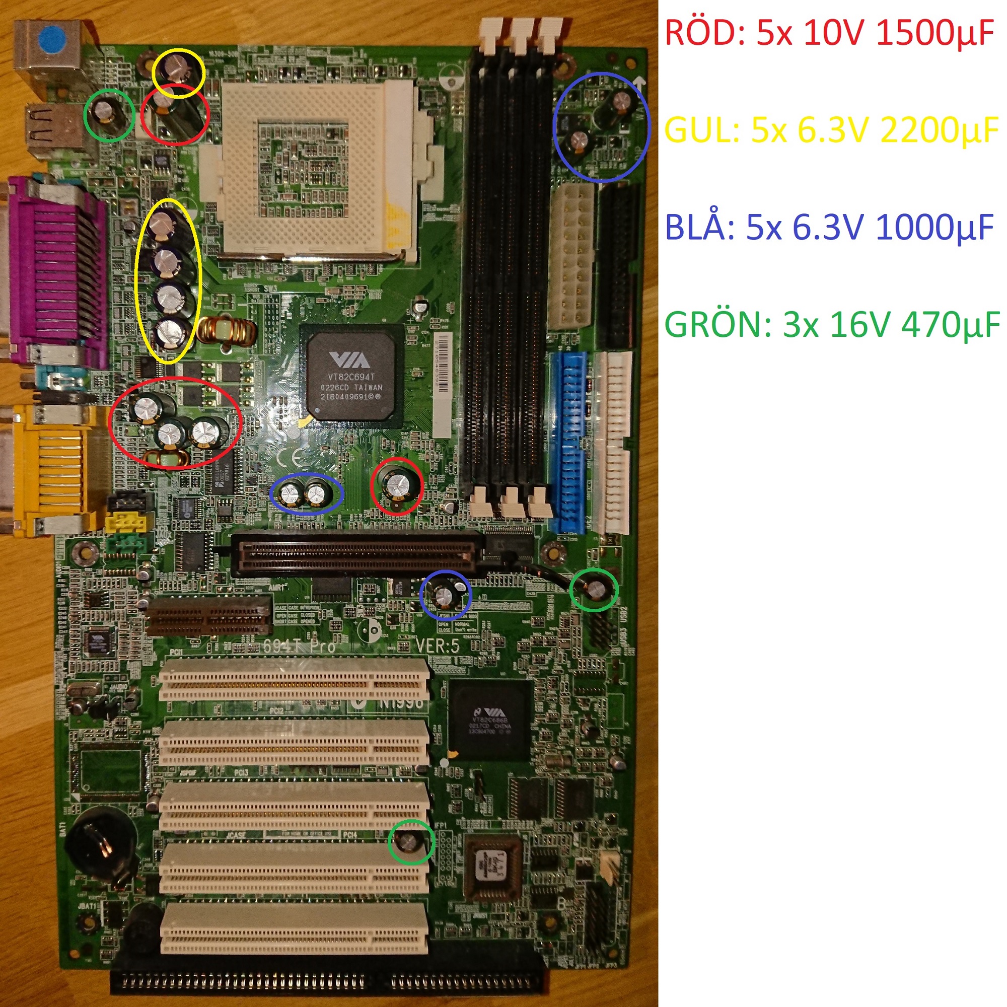

                    Noticed that I didn't include any photos of the board to be recapped (plus the 694T Pro) - posting my reference (in Swe) photos I used. (Yes, my paint skills are awful - I just did them quick for reference. ^^)

                      That said, I noticed that on the MSI 694T board, you circled some 6.3V, 2200 uF caps with K-vents. Those look like Rubycon MBZ... and if they are, they're probably still OK. You can replace them if you want, but I'd keep them as spares, since they are probably still in spec, despite being a little old now.
                      Also, for the 10V, 1000 uF caps and 6.3V, 1000 uF caps.... you could have used just 6.3V, 1000 uF caps for all of them if you like. This is because standard PSU voltages are 3.3V, 5V, and 12V. Clearly neither the 10V nor the 6.3V caps can be used on the 12V rail, but both would be OK for the 5V and 3.3V rail (or any of the mobo rails that are less than 3.3V.) As such, you don't need to stock two different voltages... though it's also worth noting that within the same series of any cap brand, the higher voltage caps usually will be physically bigger and also offer lower ESR / impedance and ripple current specs. So that does give you more options to choose from (as if there weren't enough cap brands already! )
                        Yup, they're MBZ's and they seem ok - but seeing as I don't know the history of the board at all, and it's pushing on 20 years old... and I'm turning it over to have it recapped, I've got FRs to replace them. They gave me all the old caps back last time, so I'm expecting to get all desoldered ones when I get the boards back. Jackcon, Teapo and G-Luxon ones go straight to the bin. ^^
                        You're not making this easier!
                        If I was a bit more into the whole recapping process (and not just doing it on paper/in theory, and not using boards that I care that much about), I'd definitely try to learn a bit more about what to use and when - at least I'm learning a bit about it all as I go, glad to have picked up a bit since last time. This place is a godsend for learning, along with other dedicated forums. And I do appreciate the info and replies in both this and my other thread! Seeing as I recap so few boards and buy so few caps, it isn't gonna save me all that much money to reduce the amount of cap types - and it's only gonna cause me more headache until I learn to calculate and see it all a bit better in my head, lol.
