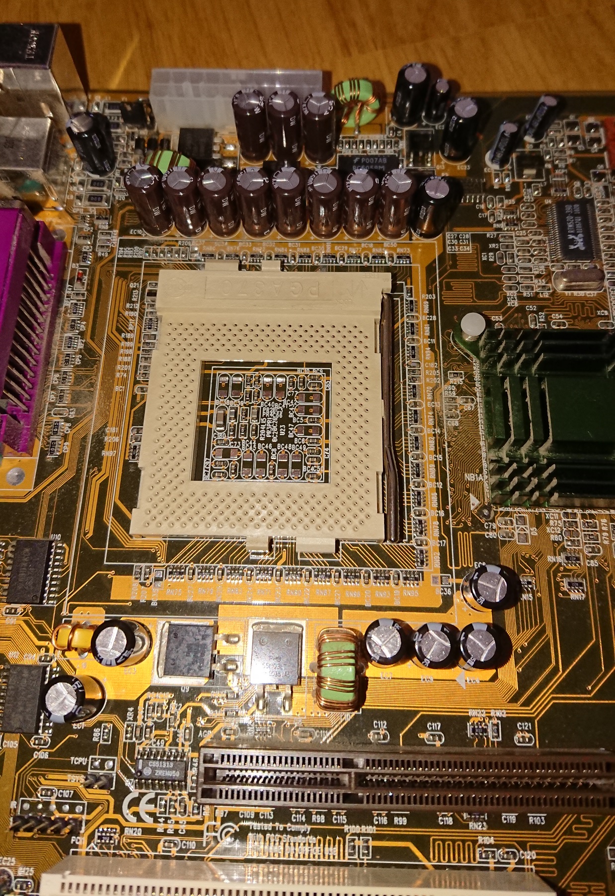

    Snapped a photo of the Abit recap work - looks good, to an untrained eye at least.
      Yup, looks good on the top side.

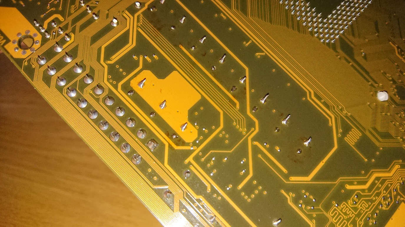

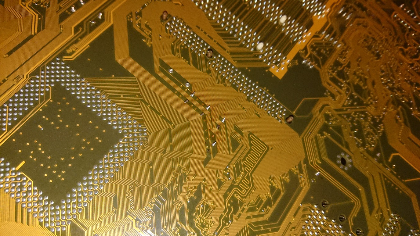

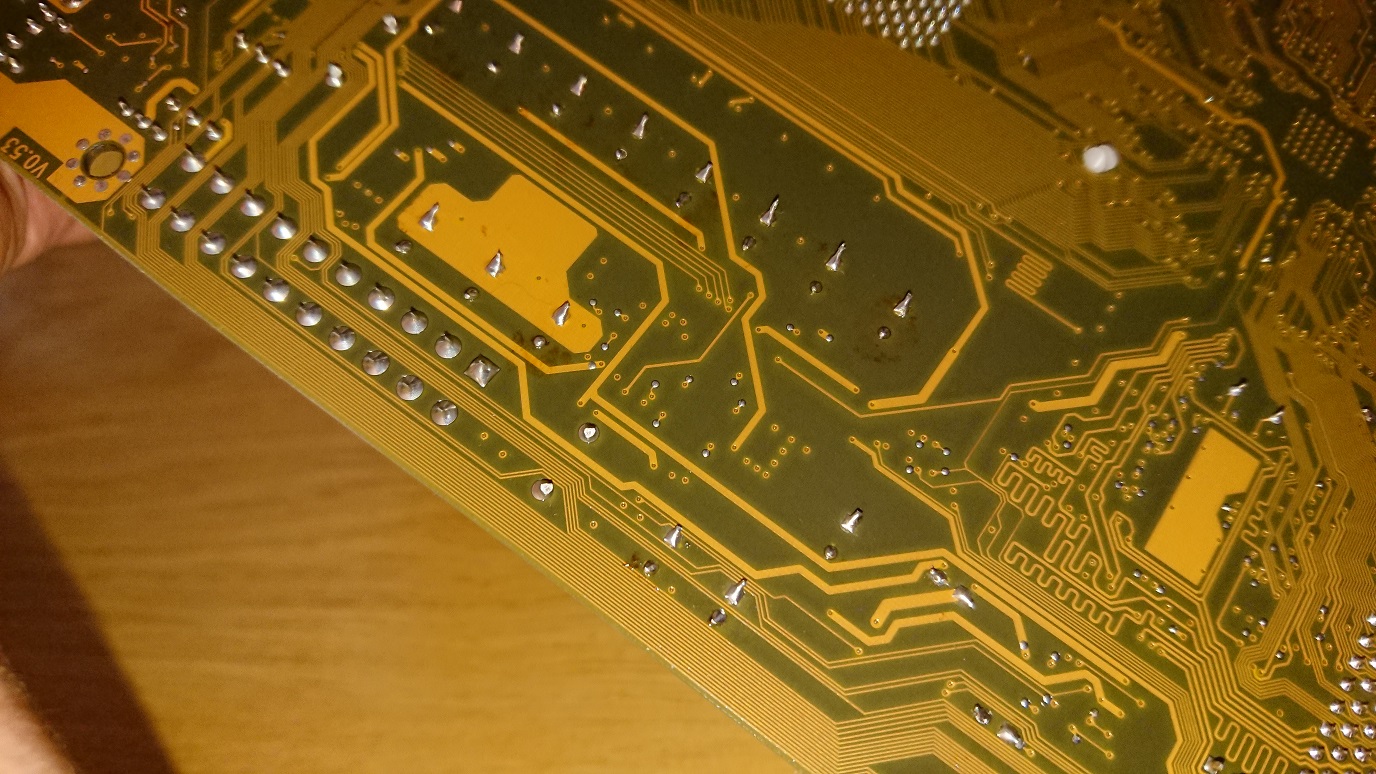

        Noticed some weird discoloration on the backside of the board by the solder joints - normal?
        See attached photos. (Disclaimer: haven't actually tested the board yet - that damn MSI board is haunting me right now.)
          Looks normal to me.
          Can't tell if it's leftover flux residue or PCB coating darkened from the soldering iron, but neither of these are detrimental to the board operation.
          I've darkened some of my motherboards like that too - mostly the ones with thicker copper planes that took more heat to get the old caps out.
          Other than that, the soldering of the replacement caps looks good on your board.
