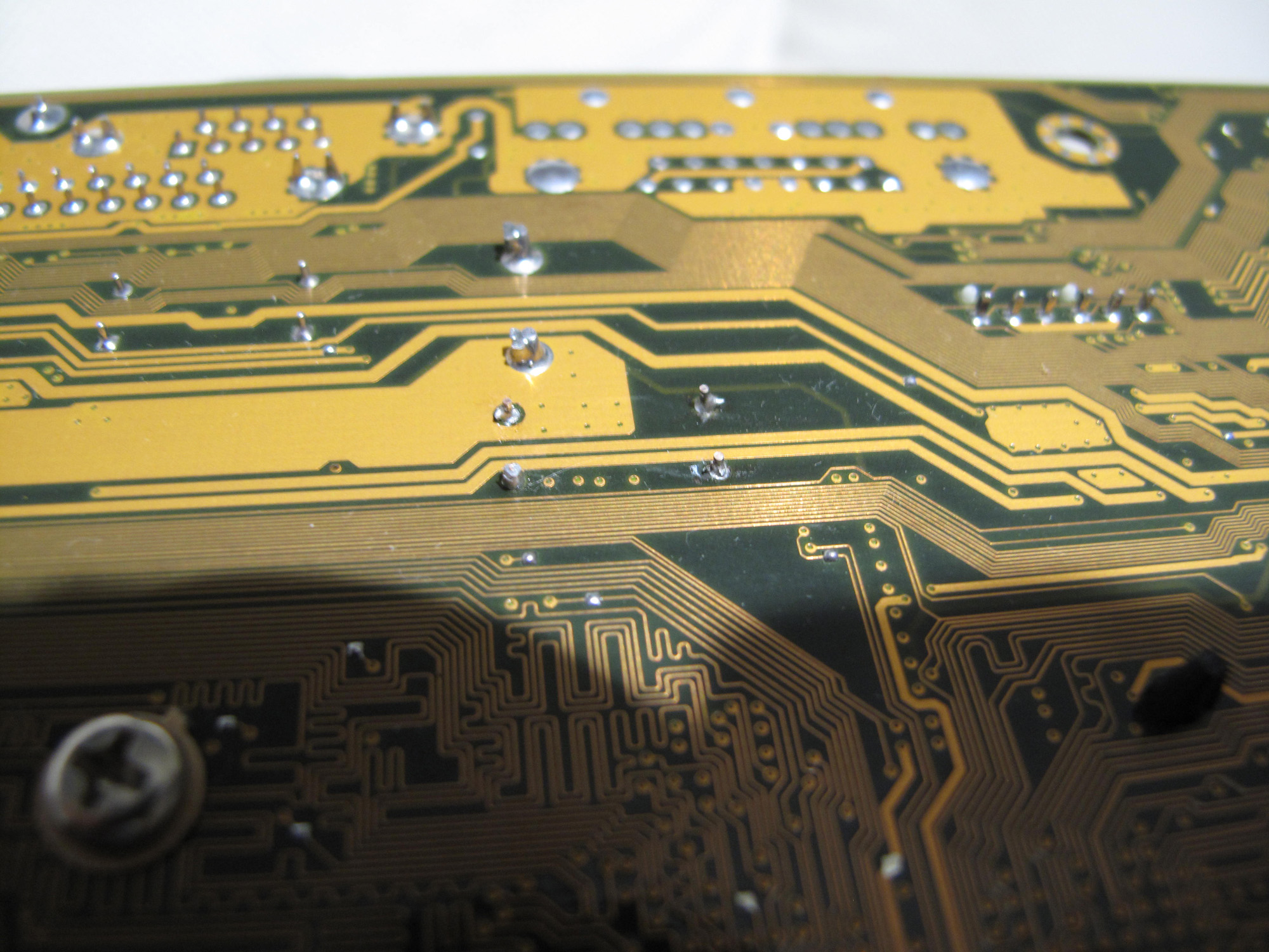

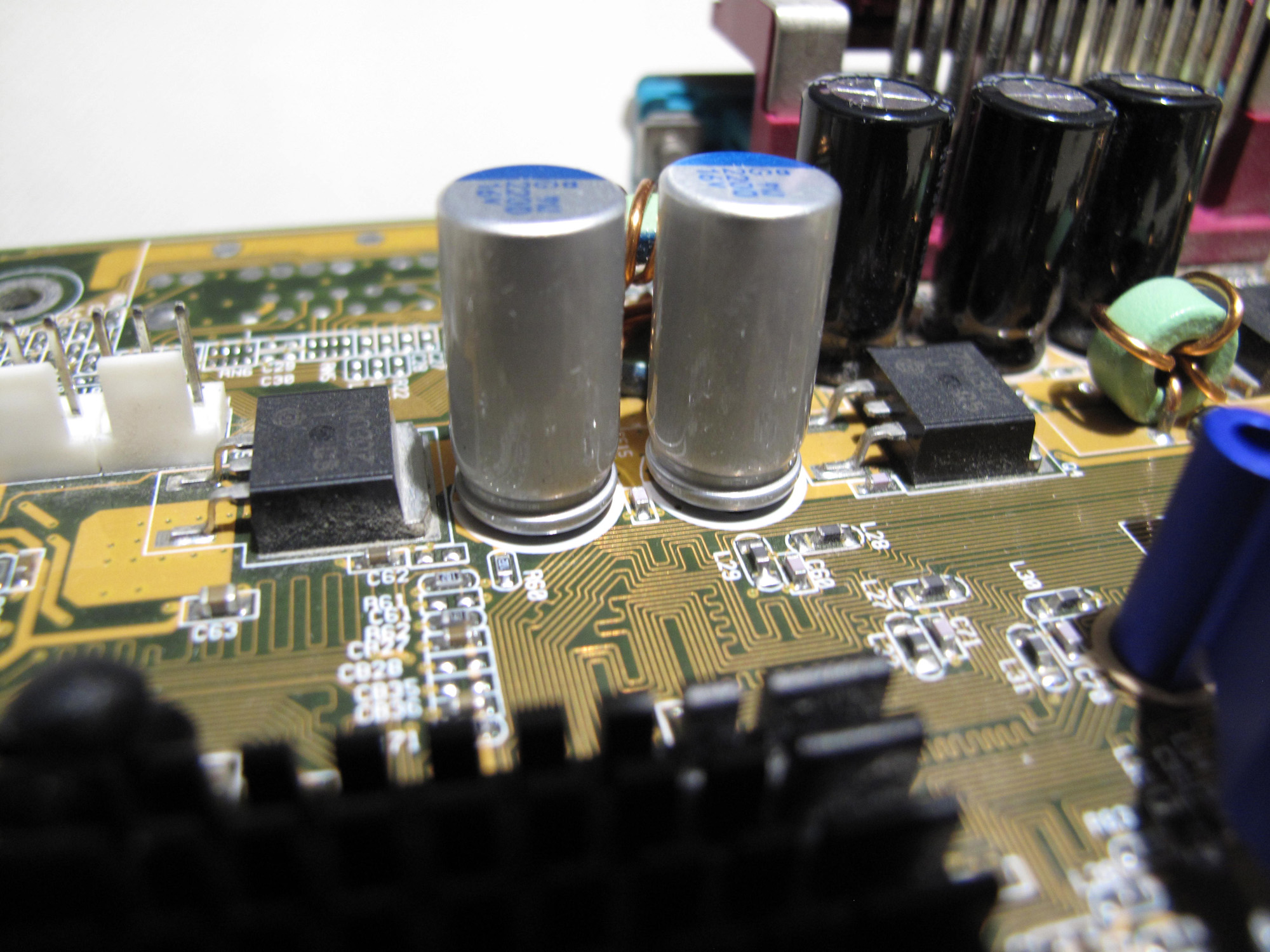

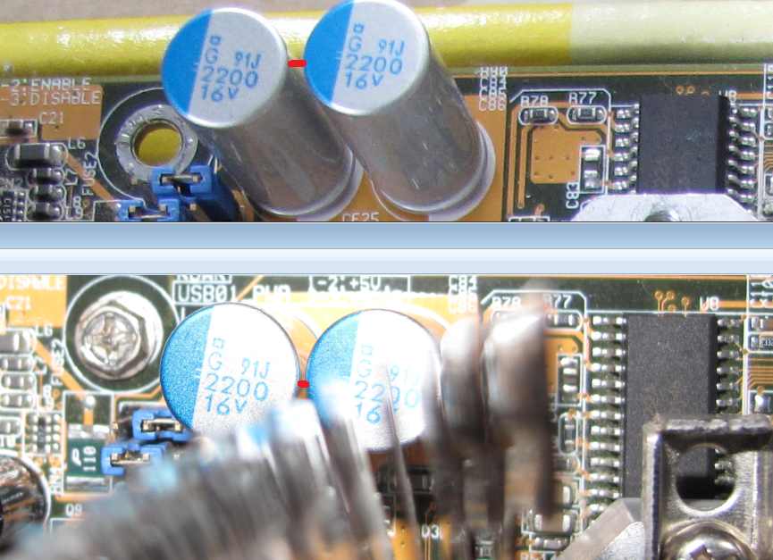

    Hi guys, I have troubles after recapping my board. One of the 4 caps on the output side of the VRM is slightly bulged, otherwise there was no issue with the board at all. I read the other thread about polymodding this board, it was really helpful! So I went on and replaced the 4 caps with the NCC ones too. I used my spare XP1600+ to test first, as I do not want to fry my CPU, it's a nice 1700+ that can run 1.35V and very high clock too. It took me at least 3 tries to get it finally boot up into bios(I was anxious and mistaken the power LED and then power reset for the power switch wiring at first), I was really happy to see it POST into bios normally. Before I switch back the CPU, I wanted to test the 1.35V Vcore too, this time it didn't boot up, the CPU fan spins and there is no beep. I thought OK, it's too low and I switched back to the 1.7 Vcore, unfortunately it never boot up again, CPU fans spins and there is no beep.
    At this point I thought the motherboard is dead. I was frustrated and sad, so the stupidity began, I remove the CPU cooler, power it on and just to see if it gets hot at all. Surely it get hot quicker than my solder iron, before I could shut it off, one of the coils of the VRM shot up smoke for about 1 second. CPU smoked first, I don't care. The VRM actually still looked fine. Later I came to my senses and power it on without the CPU, and measure the Vcore directly from the socket, it actually matches up perfectly to the different jumper settings I tried, so VRM appear to be working still?
    Anyway, what bothers me is that I don't know what went wrong, I don't know why it won't boot up after the first time. I was clearing the hole with a needle, I think was a bit careless and pushed one hole too hard, that probably delaminated the board? So it was one last boot and then the board died?? The VRM seems to work fine, but it took a hit and probably will fail soon? So I shall give it up, no need to try to boot it up with an other CPU again? Please advice, thanks!

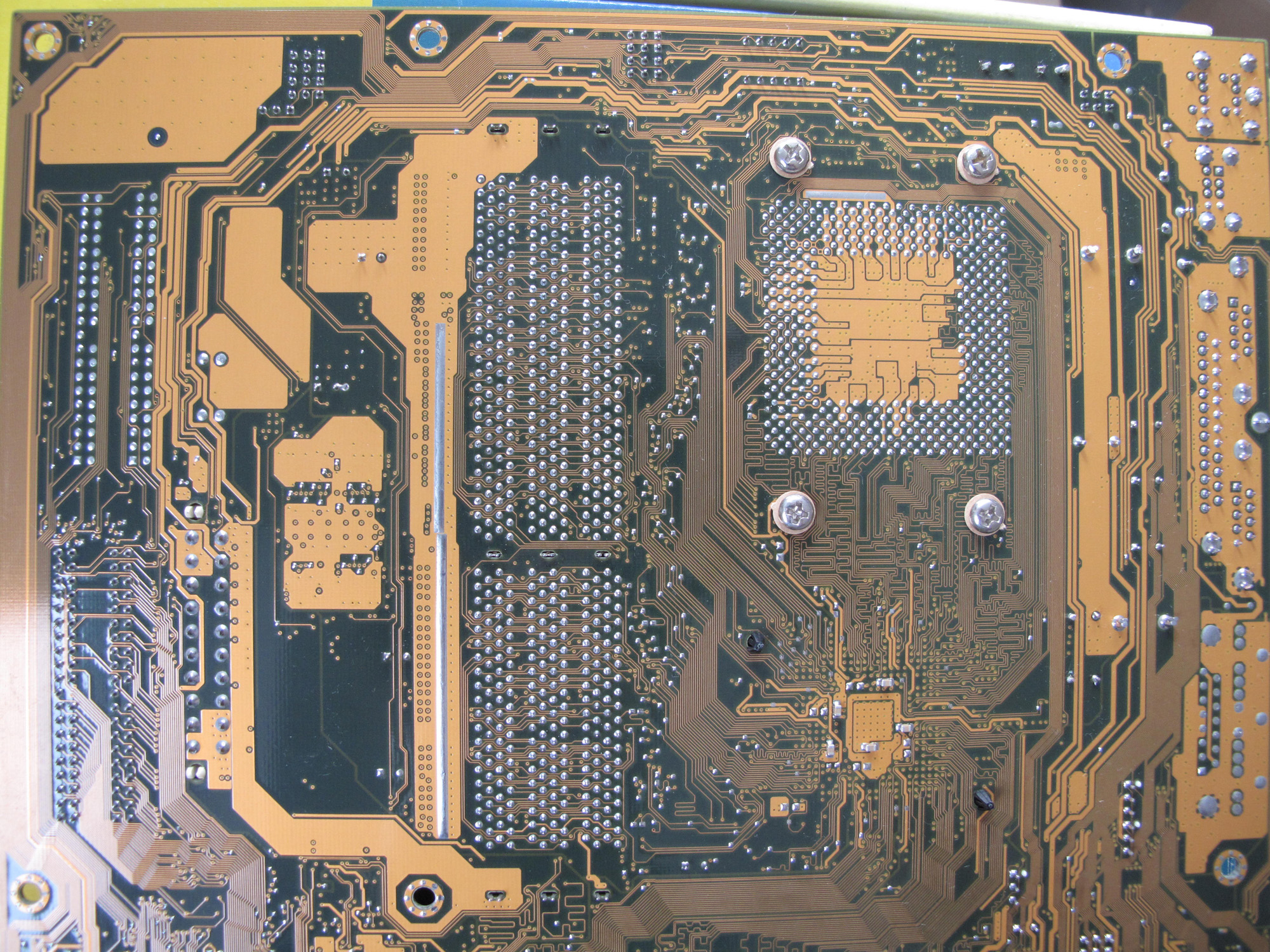

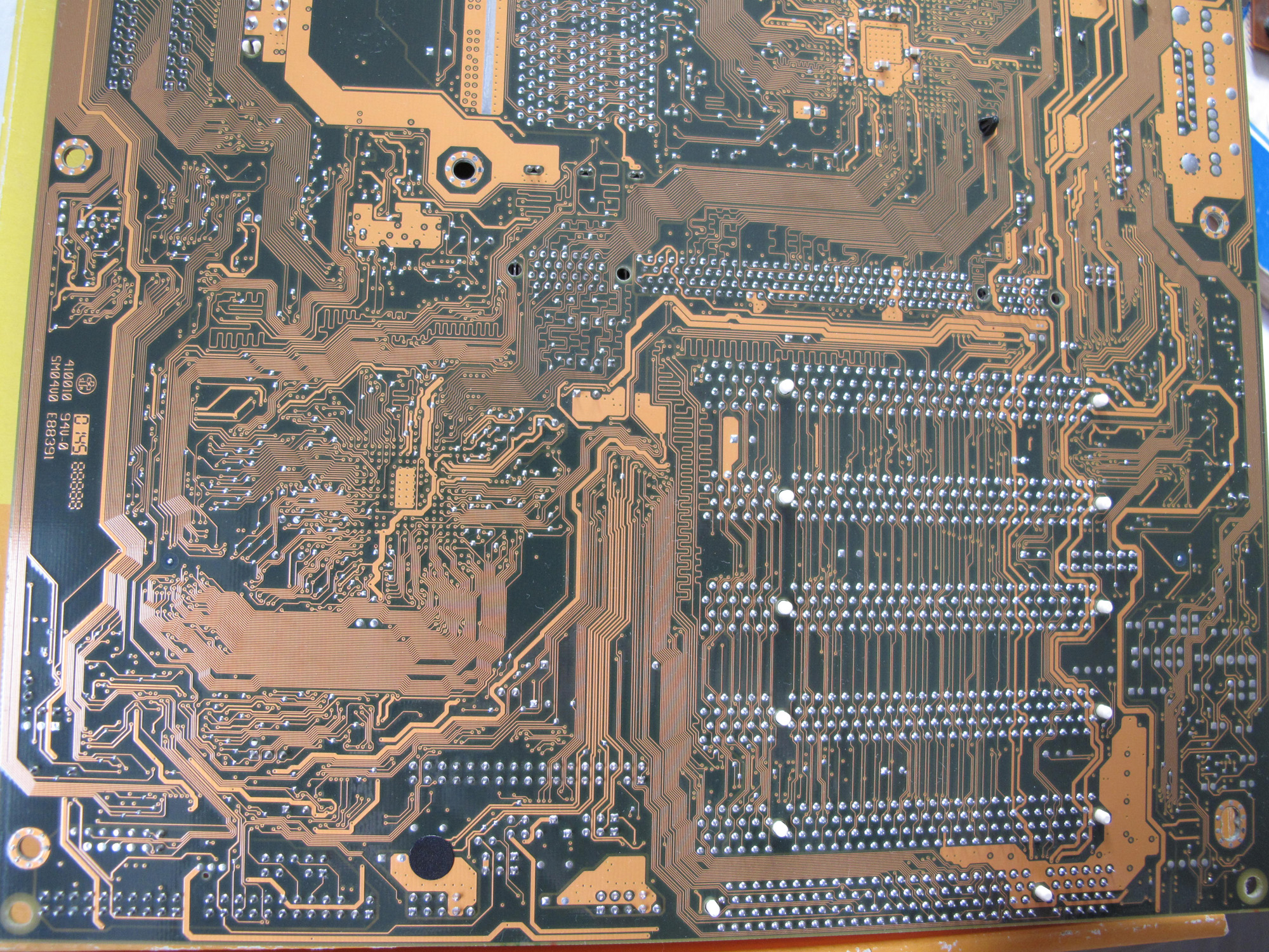

    Please post good clear pictures of the top and bottom of the board where you worked.
    • delide
      • May 2020
      • 20
      Re: Killed my Asus A7V266-E? Need advice

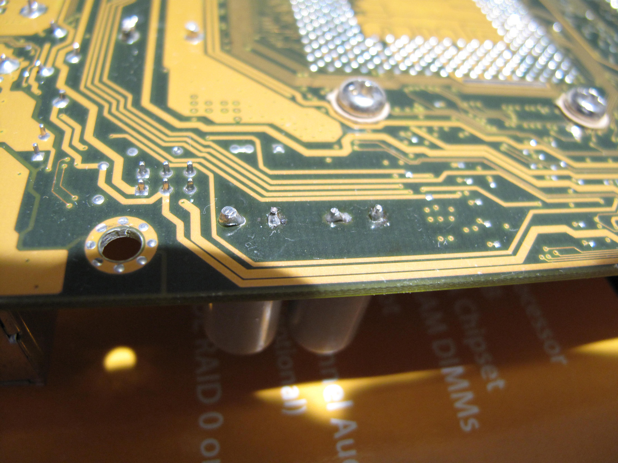

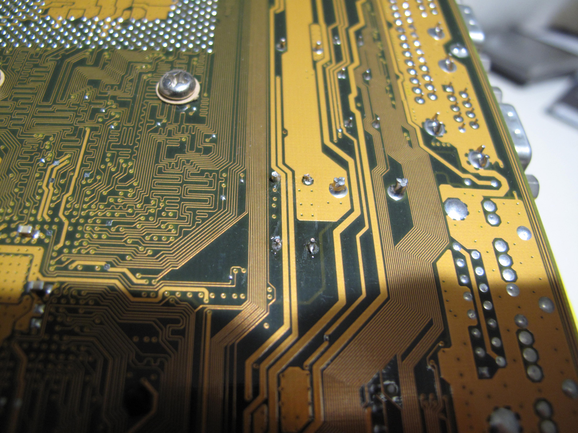

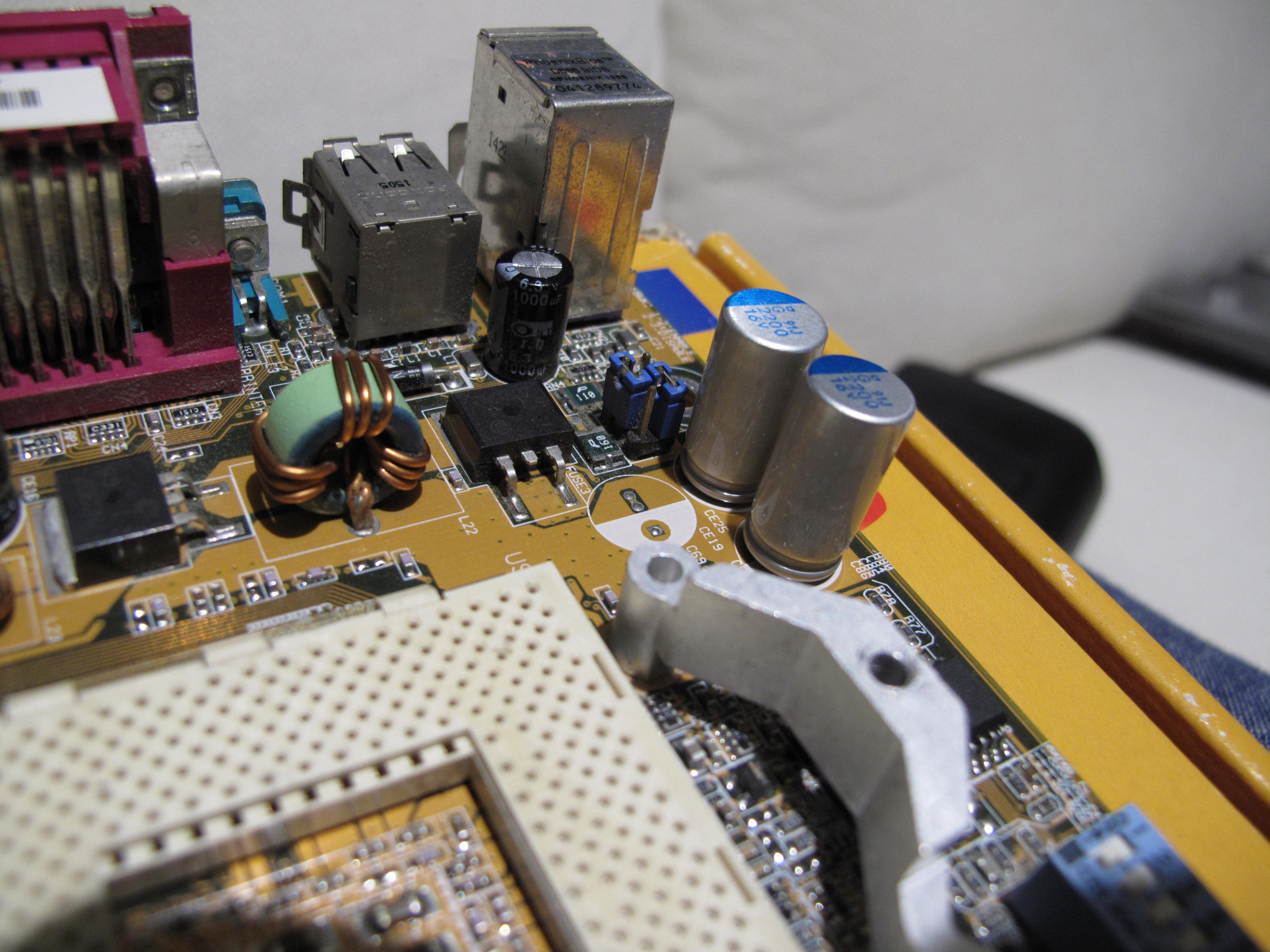

      Thanks for your quick response, I attached some photos of those area. I don't see visible damage, the choke that smoke doesn't look different either. But now I see that one joint is still partially uncovered(bottom3 top right), should have bought much thinner solder wire. For now the VRM still seem to work though, as the VCC at the socket looked good and accurate, on my multi meter at least. I don't have a scope. Still I don't want to give up yet. What are your thoughts? Thanks!
        It doesn't look like the smoke came from the coil. Perhaps it was from the CPU and air movement (from a fan or whatever else) blew it away, making it look like it came from the coil. If it was the coil smoking, you would have seen the wire darken and also smelled it. Overheated magnet (coated copper) wire typically has a very specific and strong smell.
        Also, if the VRM appears to be outputting the correct voltage and nothing is overheating in the VRM circuit, then you can give the board a try with another CPU. Just don't try it without the heatsink this time.
        On that note, beware of online "techs" (particularly on YouTube and social media platforms) that maintain / give advice to performing a "boot test" with no heatsink on the GPU or CPU (or whatever else you're troubleshooting) - it's NEVER a good idea! Heatsinks are there for a reason. Admittedly, modern CPUs and GPUs don't usually go full 100% load when booted, so often times, omitting the heatsink on a modern CPU or GPU is rarely catastrophic. But if thermal throttling is reached, it probably will compromise the reliability somewhere down the road. So it's still something that should be avoided.
        And as for older CPUs and GPUs, you saw what happened already - instant magic smoke. This is especially applicable to old AMD CPUs, particularly socket 462. I think every manual for every socket 462 motherboard I've read included at least one warning that running the CPU without a heatsink will cause likely CPU and possible board damage.
        In your case, however, I don't think the rest of the board took damage. It appears to use a synchronous VRM for the CPU V_core. So the CPU VRM's controller IC probably prevented anything bad from happening, even if the CPU core shorted out.
        With that said, before you try any valuable CPU you care about, perhaps consider getting a cheap AMD Duron or Sempron CPU that the board is compatible with, just in case. Since it appears the board did boot with the recap at some point in time, I think your recap was good - or at least for the caps around the CPU VRM. (On that note, your solder joints don't look that bad, honestly. Most look OK, and a few could just easily be smoothed out by putting a little bit of flux on them and then re-heating them with your soldering iron again.) Of course, if you haven't fully recapped the whole board (that is, most caps 470 uF and up should be change) and there are still bad cap brands left, that could also be the reason why the board is not booting up.
        Before anything, though, I suggest you remove the CMOS battery to reset CMOS settings. This should rule out issues stemming from incorrect CMOS settings (like for example, resetting the CPU V_core voltage.)
        Then try the board with another CPU (and heatsink) to see what happens.

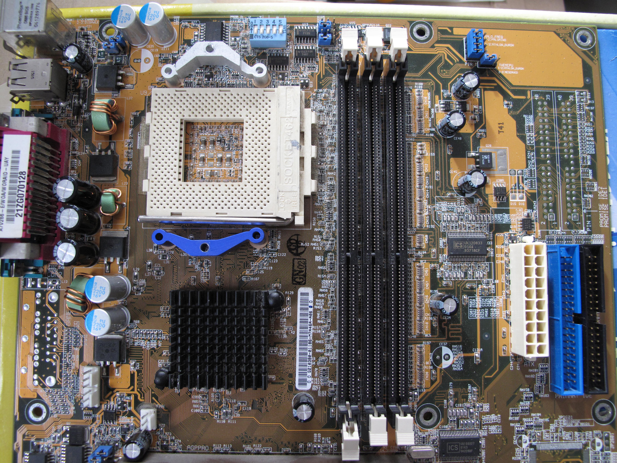

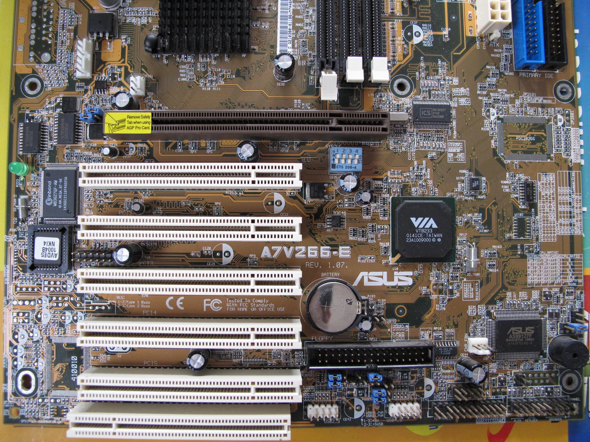

        Also, may we see one or two more pictures of your entire board? (In case we see something that you didn't, possibly. )
          ^this...^ never run the cpu without the heatsink! not even briefly esp. if the cpu and board isnt designed with overheat protection. i know the athlon xp series doesnt have overheat protection to prevent the cpu from being fried.
          the proper way to do this is to run it still with the heatsink on the cpu but unplug the cable for the cpu fan. the heatsink should still provide some thermal mass to absorb the heat while the lack of the cpu fan should allow u to touch the heatsink to see how fast it heats up. thats the proper way to do it.
          that test xp 1600+ is probably fried. try to get another cheap test cpu to see if it works or test that supposedly fried cpu in another board to see if it works.
          u didnt say what psu u are using. are u using a period specific 5v heavy psu? if u are, it means the psu is also quite old and it may be failing. check the psu to make sure it hasnt failed to rule it out as the cause of the non-booting board.
          also try to clear the cmos to see if it makes it boot. sometimes either during overclocking or undervolting, if the clocks are too high or the voltage is too low to allow the cpu to work properly, the cmos settings somehow become corrupt and the board cant boot with the bad cmos settings. clearing cmos fixes this problem.
          if u have read through the forums, the proper procedure to check if u have soldered the caps on properly would be to try to rock it from side to side perpendicularly across the line of the two legs of the cap. it should resist movement firmly. if it feels flimsy, the solder didnt go all the way into the hole. reflow the joint.
          and another joint has too much solder in the bottom2.jpg picture. the left most joint.

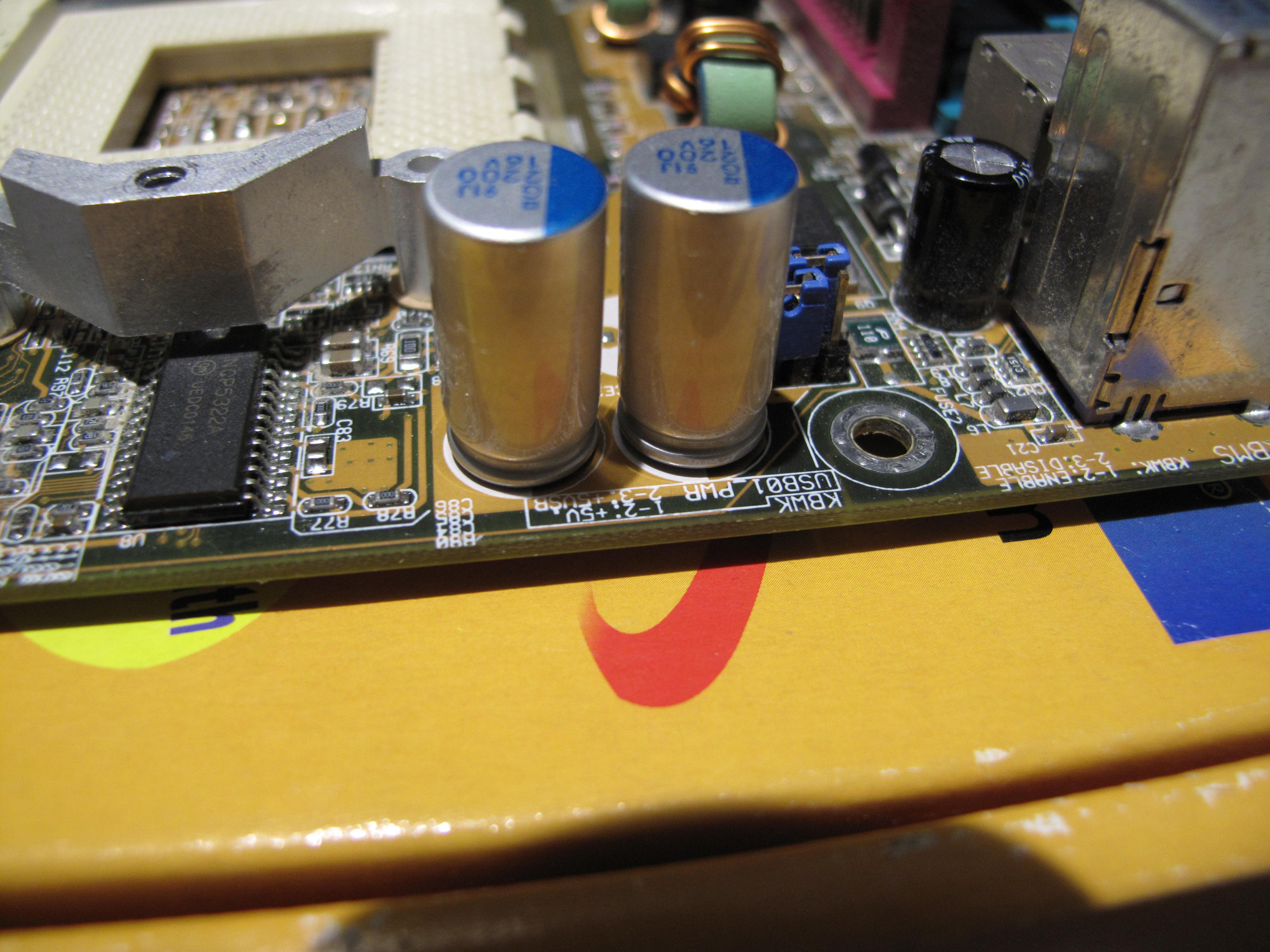

                      I've attched more photos of the entire board, thanks for looking!! Also attached a photo of the CPU, at the top left corner you can see the mark of the "eruption", pointed toward the VRM as well, certainly back up momaka's observations! BTW the die itself still look quite normal too, not that I will put it in again, BUT, just maybe I was not the latest/the last idiot to have fried a XP CPU then guess we will never know
                      An other CPU is on the way, I will then try to boot it up, this time I will certainly clear the CMOS if it won't boot. If I'm successful, I will then fix the joints, then test again, and then hopeful I will finally be able to put everything back together again! And then doing some more tests!

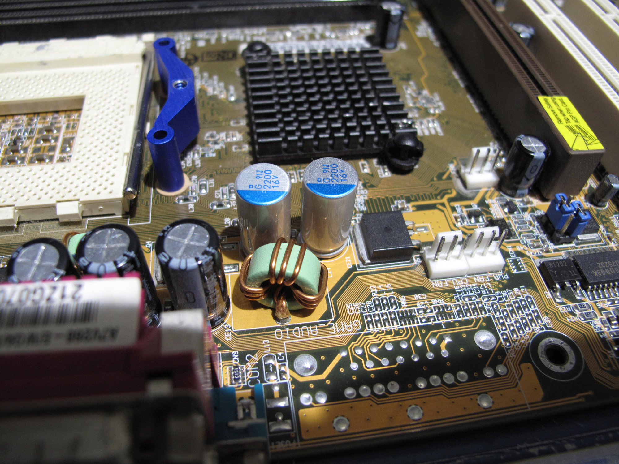

                            I indeed only replaced the 4 HM ones, which are the biggest and therefore the easiest to recap I would think, so I guess I was forcing it a bit too. Anyway, I have subzero confidence right now, certainly feel like the more caps I replace, the more chance I will just kill the board, when I get to them all it would be 100% dead
                            Fear not!
                            The caps around the CPU are usually the hardest to replace, because they sit on the thickest copper planes. The fact that you got those recapped means you're probably done with the hardest part already. So the other caps should be easier to remove and recap.
                            If those Nichicon HM caps that remain on the board are still the original ones and they have a date code starting with H01__, H02__, H03__, or H04__, you should replace those as well. Nichicon HM made between 2001-2004 (corresponding to the above date codes) have a nearly 100% failure rate (even when they don't appear bad, sometimes.)
                            I replace a bunch like that (that appeared OK, but were bad / showing extremely high capacitance due to high internal leakage) in a P4 Gateway PC that was working fine, but always unstable when cold. Replacing all of the Nichicon HM caps on the CPU cured it for good.
                            BTW the die itself still look quite normal too...
                            It does... but then you look at the slightly darkened PCB around it, and you know this thing must have overheated.
                              They actually appear to be Nichicon HD (1500uF 6.3V, they appear to match the case size in the datasheet as well going by the photos provided). The fifth image in the third post depicts part of the series name (“D” on one sleeve and “(M)” on another). They are rather long in the tooth now, but so are all the lesser quality OST scattered about the board. Hmm... not to be condescending, but haven't we had this conversation before?
                              I'd say the 6.3V and 10V Nichicon HM, HN, and HZ made between 2001 and early 2005 (just 2005 for HN and HZ) have a rather high failure rate, but the 16V rated parts seem to hold up better both visually and in terms of their tolerances. Probably due to their thicker oxide film protracting deterioration, and they are usually under less duress unless some MOSFET neighboring them is dissipating too much heat. That said, I would not ever recommend leaving a bad datecode HM, HN, or HZ on any board, no matter the capacitance or voltage rating.

                                Thanks for your reply again! I will certainly check those remaining caps! For now I have good news, I got it boot up successfully! It was totally the opposite of straightforward, there were all sorts of strangest behavior, it took me countless boot attempts but then all problems disappeared suddenly! I was so happy to be able to enter the BIOS that I booted a few times more:-) Also ran a few passes of Memtest86 yesterday, so far so good! Thanks for your advices! Will post how it went shortly.
                                I did reheat and improve the joints while I was waiting for the CPU. I think in the first attempt I made a mistake of not heating up the pins of the caps properly. And one should really practice first if possible. Now I'm just starting to get the hang of it I think. I actually bought the same board together with the other CPU, it hasn't been used since 2008, but it still booted, I will check it later too and probably then recap it completely!
                                Yes, the clips on the cooler are terrible, very difficult to mount/remove, but easy to damage the board/CPU. I'm using a Zalman cooler now, I still have to be careful indeed, but it's much better than those with clips!
