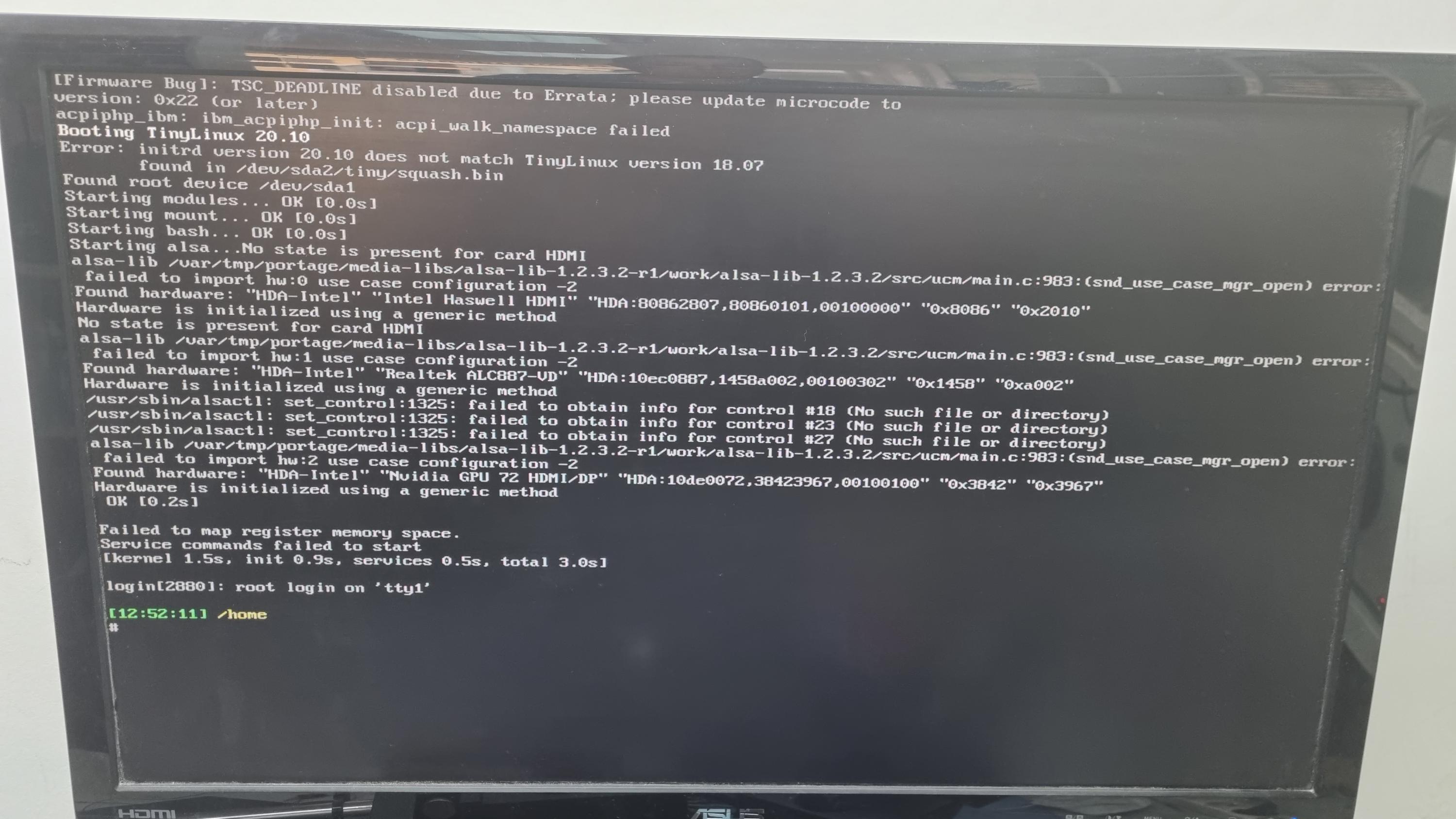

    This doesn't work for me
    I used the disk genius and restored the partitions to a 320Gb HD - all that went OK but when I put the drive on my GPU test rig and boot from it, I don't get the screen shown in the video - I get a load of gobbledegook
    First lines are
    [firmware bug] TSC_DEADLINE disabled due to Errata: please update microcode to version 0x22 (or later)
    acpiphp_ibm: ibm_acpi_init: acpi_walk_namespace failed
    Booting TinyLinux 20.10
    Error: initrd version 20.10 does not match TinyLinux version 18.07
    The first error - please update microcode - I can google and it tells me to update my BIOS but I already have the latest BIOS Gigabyte GA-B85M-HD3 BIOS version F12
    I found this link regards this error - the only solution I seem able to do is the first one
    https://linuxpip.org/fix-tsc-deadline-error/
    Solution 1: The BIOS is up to date
    Solution 2: I tried SHIFT and ESC. I get a different text screen but it still has the TSC_DEADLINE error at the top. It also says 'failed to map register memory space' and 'service commands failed to start'. This means nothing to me unfortunately. What does a GRUB screen look like anyway?
    Solution 3.
    Doesn't work. I don't know much about Linux, but cd /etc takes me to the etc folder. However using 'ls' command in etc shows there is no dierctory called apt and no file called sources.list
    If I type sudo apt install intel-microcode it says
    sudo:apt: command not found
    Solution 4: does not seem to apply to my situation
    Solution 5: as far as I can tell the RTC is set correctly
    The other two errors I googled but didn't really find anything useful.
    It really annoys me when I find a help page for a problem and in itself the help page just presents me with more problems!!! GRRRRRR
    OK OK it is probably me that is in error and not the downloaded images. So what am I doing wrong here? And why isn't the answer to that obvious from the so called help pages? And you would think the creator of the video might have mentioned some of this stuff...

              • piernov
                • Jan 2016
                • 4438
                • France
                Re: Software to analyze Video RAM faults on graphics cards?
                Shouldn't matter.
                Error is clearly here. Haven't checked the image though so dunno if it's correct or not.
                • dicky96
                  Sun Seeker
                  • Mar 2017
                  • 1825
                  • Spain
                  I took another hard drive and tried again. I follow the instructions as per the Kings Overkill video and everything goes like he describes. Once I restored the three partitions from the downloaded images, I try to boot my GPU test rig from the HDD but it does not work the way that is shown in the YT video
                  Here is a screenshot of exactly what I get. I don't get that screen saying wait some seconds for GRUB and I don't get the 1/2/3 test menu like in the YT video.
                  Can one of you guys with more knowledge of linux help me to get it working? I don't understand this stuff sorry but I do know how to follow the instructions, not that this helped me so far

                  • foshland
                    • Jan 2017
                    • 126
                    • Spain
                    #29
                    Hi, at that point put "ls"
                    it will shoy you a list of directories, choose one depending on card and put "cd that directory". Once in there, put "./mats -e 10" and enter, after that, for having a report, put "nano report.txt" and enter. Hope this help, It happens to me same as to you, it doesnt open the menu so i have to go into it manually.
                    All this info, gotten from here
                    https://www.youtube.com/watch?v=6yBJ_YxCEzg
                    minute 5:18
                    hope it helps
                    • foshland
                      • Jan 2017
                      • 126
                      • Spain
                      #30
                      And now I found that you should configure PC BIOS to legacy, not UEFI, then the menu starts (at least for me)

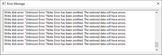

                        Hi Guys, I have downloaded all the files, and they extract from rar correctly w/o errors, but I have an issue with DiskGenius, as with the 3'rd partition it gives me multiple errors somewhere during the partition restoration process.
                        Tried some previous versions of DiskGenius, but same or even a worse behaviour.
                        Also deinstalled bitdefender, but does not change. Extraction from rar is correct, so the image file schould be OK.
                        The disk however boots, and I get the menu, but trying to start eg AMD option stalls somewhere during the loading proces. Disk is an samsung evo sata ssd 256mb.
                        Do you have an idea what to do or what can be the problem ?

                          Hi, I did it with diskgenius 5.4.2.1239 X64 version (the last version on the web), with the disk in a usb case and for running it on the testing PC in no usb case, just sata connection.
                          I know a lot of people had problems with the part 3, as it is the biggest one, can you try to download it again? I think if winrar doesnt give you errors you should be fine, but you know, maybe its corrupted someway
                          (did you try to boot in legacy mode instead of AHCI?)
                          • DynaxSC
                            • Apr 2021
                            • 479
                            • Poland
                            #33
                            Hi, thats the same DG version I used also first time. I believe the problem is in the fact, that I connected the drive to SATA port, not via USB. Ordered now such a box, and will try again on Friday.
                            Regrading the menu, I also did not get it at first time, I had to change the boot order on the mobo to the disk itself as the first priority, then the menu was loading easily in UEFI mode. Legacy I think I tried once, but w/o success, I will try it again. I had also to try several boards, now an ASRock H110 board seems to work, with ASUS H110 I had issues with ACPI compatibility. Read somewhere ASUS does not care so much about Linux compatibility in regards to ACPI implementation.
                            Regarding the third file, it has downloaded again during the night, and has same length as the previous copy of the file. The length of the extracted pmf file in explorer is 33 807 163 KB, so it seems to be complete. Maybe you can check also your length with my.

                                #35
                                finally I got this disk running, I downloaded the third file again, and it could be restored with DiskGenius w/o errors. I have compared both files by byte, and it seems despite the first file had same lenght, it was different to the new one somewhere at 15GB. Now it boots w/o a problem, and AMD testing is also running.
                                Important is to set the disk itself as primary boot in the mobo BIOS, otherwise some single partition will boot and no menu comes.
                                It makes no difference if the disk is connected during restoring via SATA inteface or via USB and USB disk box.
                                My board I tested with is ASROCK H110M DVS with i5-7400 CPU and one 8GB module.
