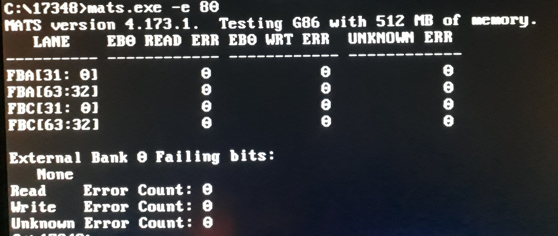

                                  I used it on 8800 GTS G80.
                                  GTX 260 won't be supported as it is a GT200 core, however there is some support for G9x.
                                  thanks, run on 8500gt with 8 memory chips! where is chaannel B? did you accomplish using mods.exe for that card? mine wont run.
