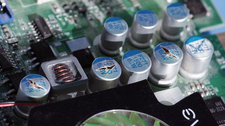

              I mean comparing these two for example.
              The blown graphics card capacitors are electrolytics which just happen to look extremely similar to the real polymer capacitors on the motherboard, right?
              Only real difference I can see is that the electrolytics have the usual vent, which the real polymer capacitors don't have.
              This is what I mean by "fake", unless I am misunderstanding something there....
              To me, it just seems to be a way to trick the buyer into thinking he is getting high quality capacitors because they look almost the same...
              -David VanHorn
              • PCBONEZ
                Grumpy Old Fart
                • Aug 2005
                • 10661
                Re: Anyone know what the capacitors on an MSI 790GX-G65 are?
                Yes, they just happen to look like poly but aren't.
                Those shown are indeed Sacon FZ series.
                Thing about Sacon FZ is they -abuse- the fact that they look like Poly.
                - Sacon FZ come with blue marking to -look like- Chemicon Poly.
                - Sacon FZ also come with black markings to -look like- Nichicon Poly.
                True Polymer caps do not have vents.
                Functional Polymer caps may have vents. [Some common sizes do.]
                Electrolytics 8mm and up have vents.
                Electrolytic 6.3mm and down may have vents but often don't.
                Correct.
                - When I discovered that FZ are[were?] available with either blue or black markings any doubt in my mind that the buyer confusion was deliberate was erased. Sacon is[was] doing look-alike on purpose.
                The brand seems to have gone *poof* [again] but there are still zillions of these cap out there already installed and possibly some in supplier stock piles.
                Sacon FZ have also been found on Jetway and Biostar motherboards.
