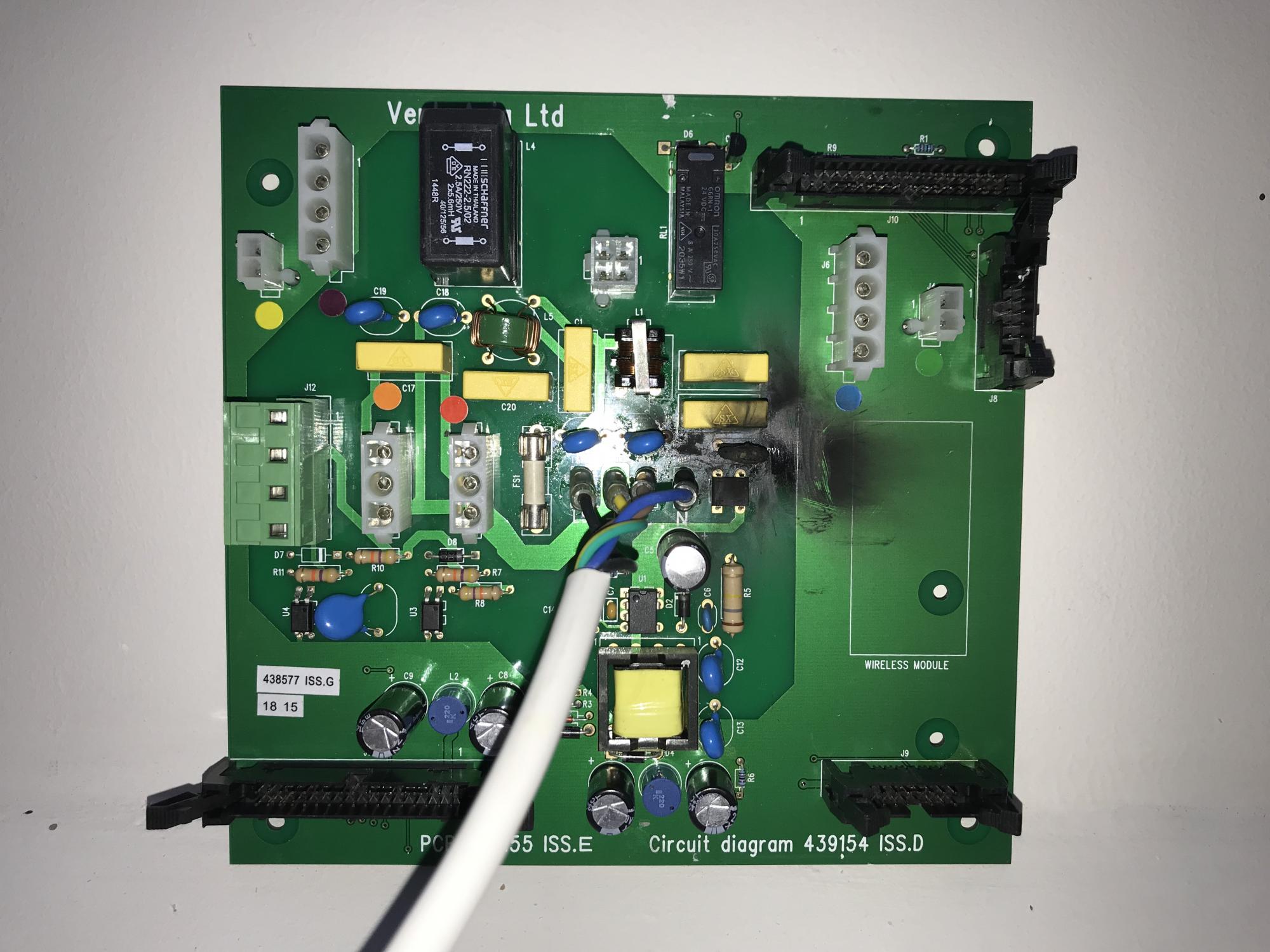

Power supply board from a ventilation unit - burnt out something
  • cjard
    • May 2014
    • 14
    • US

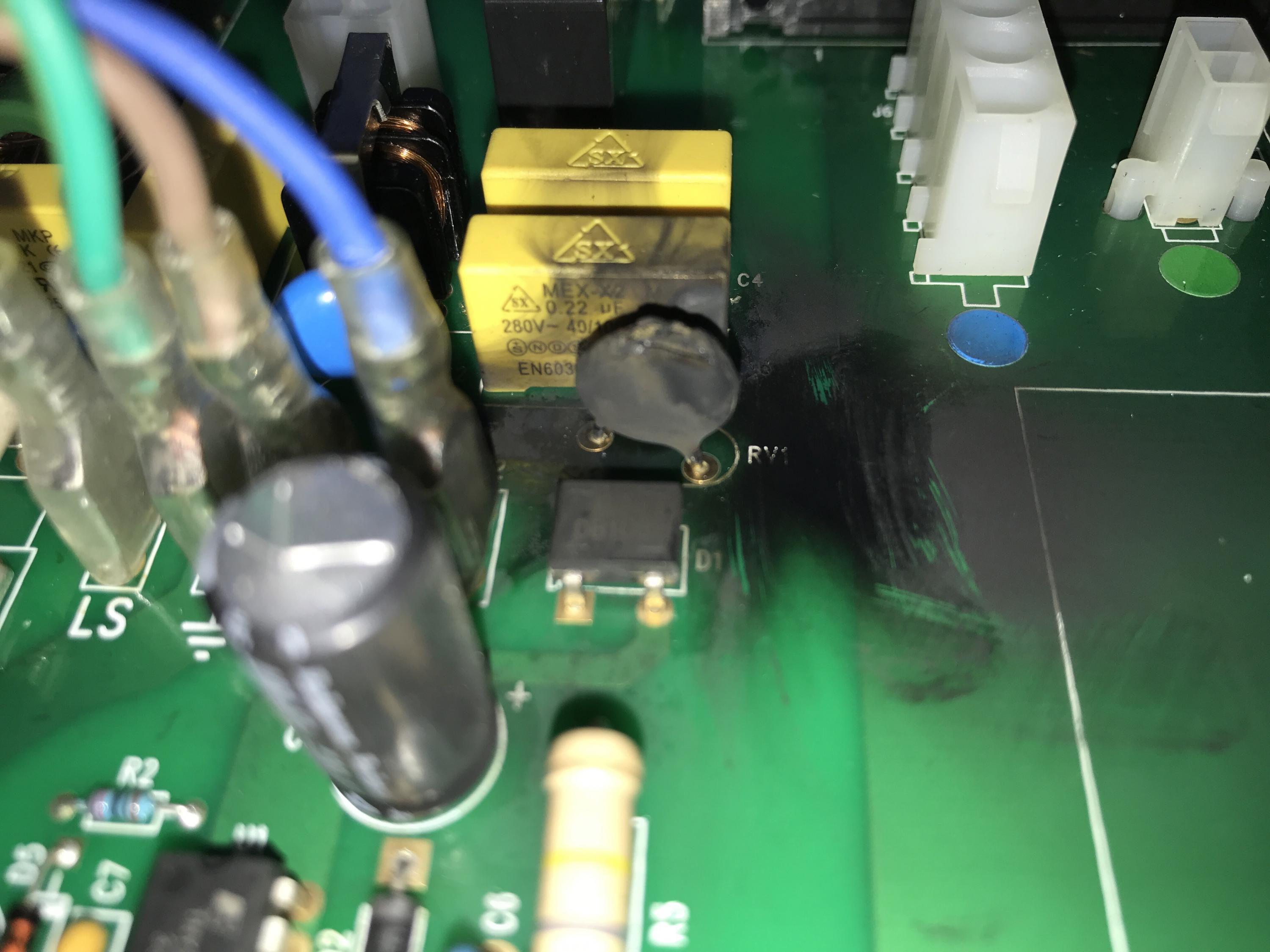

    This vent axia ventilation unit stopped working and I pulled the power supply board hoping it was the internal fuse. Seems this other component might be to blame but what is it? It looks like a capacitor to me but next to it on the board is printed RV1 whereas a physically similar component at the other side of the board is labelled C15...
    Any ideas guys?

    Re: Power supply board from a ventilation unit - burnt out something
    the big cap in the picture looks bulged.
    the device may be a resistor to limit inrush - have you checked for shorts?
      looks like a stand in for lack of a fuse . guessing there is a short after it
        Check if RV1 is inline with the a/c line or is across the a/c between line and neutral, It could be a inrush ntc thermistor if in line or a MOV if it is across the line, clean it off, you might see a number on it.
          My neighbor has the same device as I pulled this board from, so I'm gonna take a look at the components and see if I can see anything on them, writing wise
