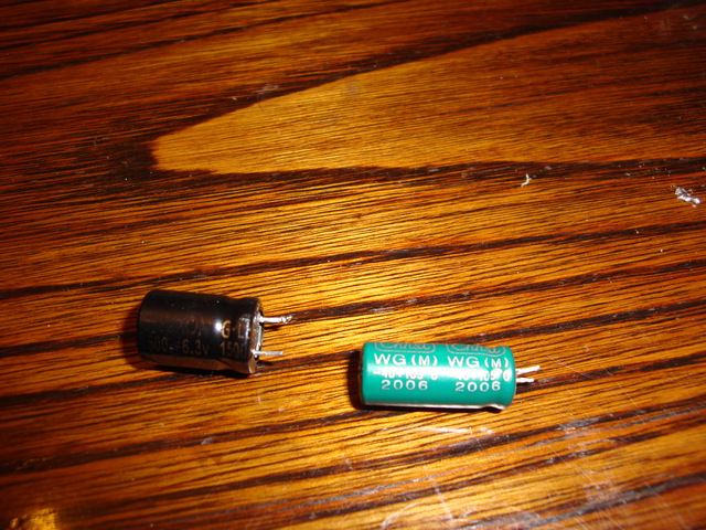

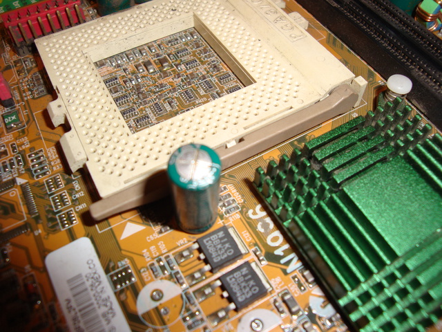

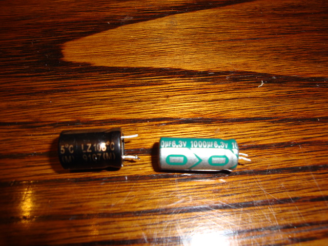

          Hi, finally i removed the capacitors, thx guy...now i have a doubt, i want replace someones from another bad board capacitor. The bad ones is the green ones : 1000uf 6.3v wg(m) -40+105c , want replace with the other ones darkones is like : 1500uf 6.3v GLUXON 5c to 105c, if possible? i attach you some photos with capacitors and showing one bad from board , is a ibm motherboard. thx a lot for your time.

            g-luxon? blech...

              i know can be bad, but works?
                greets
                why waste the time?
                too many good sources for replacements.
                i bet tc/badcaps.net even has a kit for that board.

                    fix it now, not when it burns due to dried up caps. save yourself a board.
