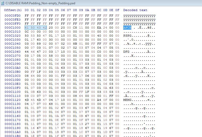

Lenovo 330s-ARR-R332200U motherboard remove on board ram
  • laup
    • May 2018
    • 11
    • United Kingdom
    ive looked through all the lines for 2311 but cant see a consistant row of them
    could someone please have a look at my bios and remove the onboard from within, appreciate it
    Laptop : Lenovo 330s 15 ARR
    motherboard: 330s-ARR-R332200
    SN: yd04qytm

        Originally posted by laup
        sure
        You can remove the SPD with a macro script - https://www.badcaps.net/forum/troubl...20#post3232220
        Alternatively ,search the internet for SPD removal tool and use that, it does the same thing.
        I doubt it will work though as the SPD is in the EC firmware.
        APCB (AGESA PSP Configuration Blob)
        Coreboot info https://doc.coreboot.org/soc/amd/family17h.html
        APCBs are used to provide the PSP with SPD information and optionally a set of GPIOs to use for selecting which SPD to load.
          Appreciate it, i will give it a go tomorrow, didnt know this existed, ive only done onboard ram mods via resistors in the past, but there doesnt seem to be a full schematic for this board available
          • laup
            • May 2018
            • 11
            • United Kingdom
            I will try and see , if not i will then see if i can read super io via svod and possibly run the script?
