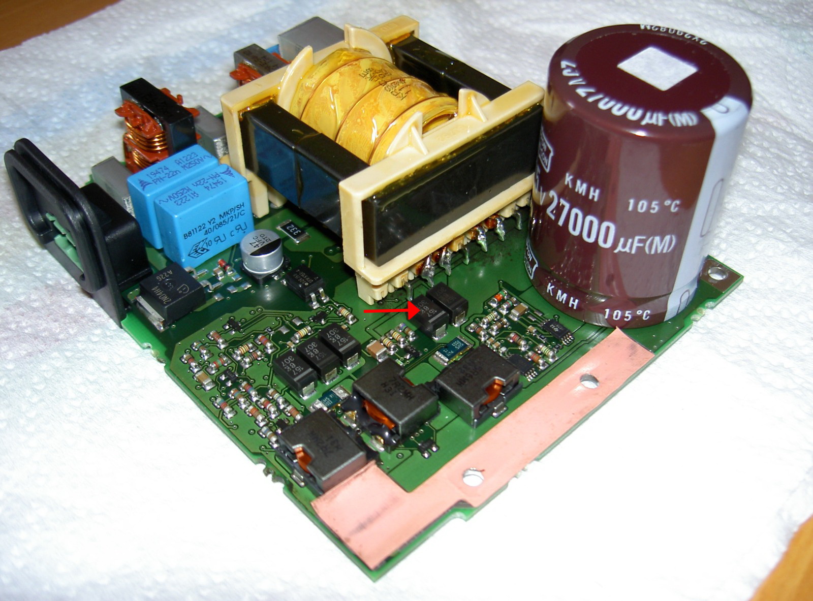

    can you help me identify the component that i marked in the attachment?
    i thought it's cap and i bought smd cap with 157 marking on it but it isnt work properly .

      Re: Siemens 840D PCU50 Industrial Computer
      probably a diode, compare it to one of the others.
        i compared it to the other ones , it doesnt act like a diode when i test it with multimeter it act more like a cap, i mean in diode testing mode i hear only small beep and then nothing in both ways ,
        the marking on it is something like "150 j " .
          well "157" would be 150uf - do you have a cap meter?
            no i dont have one , but as i said i about 150uf caps but with different voltage rating(16v) and it didnt work , when i put it's own cap i have 3.3v output but when i use the one that i bought the voltage gets to 1.3 and it's not stable ,do you think the difference in the voltage rating could cause this problem?
              no.
              if the original gives 3.3v then isnt that correct?
              where does the input to this "part" come from?
              if it's the transformer then it is a diode - probably a fast or schottky type.
              if that is the case then your cap is passing current and would explain things - need someone like budm to chime in on this!

                yeah it's correct but i run it with just one of those caps or diods the other one that i showed in that picture was short circuited so i had to desolder it and even if it is working with just one of those i had to find a replacement .

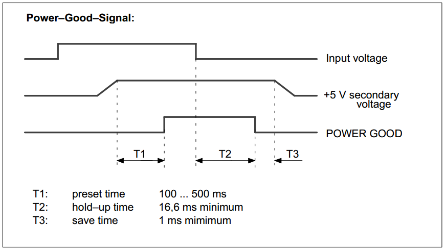

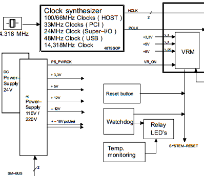

                    #29
                    i think i found the problem about why my system isnt booting up , as i said before this power supply creates some kind of power good signal for starting up the system,i've showed this figure in the pic below that i crop from siemens manual.
                    so i realized when i connect my power supply to 24V input it make somethine like beep buzz sound and it's from trans and i checked my outputs with osilloscope and i saw a voltage ripple in sync with the buzzing sound on all the outputs ,so i think this ripple affecting this power good signal and cause my system not to boot up , any idea on how can fix i this ? please help me i dont have much time for repairing it .

                        no i didnt mean that the input gets fail, i meant when i connect the power supply to 24V ,the siemens power supply act like that so i have ripple on its outputs ,

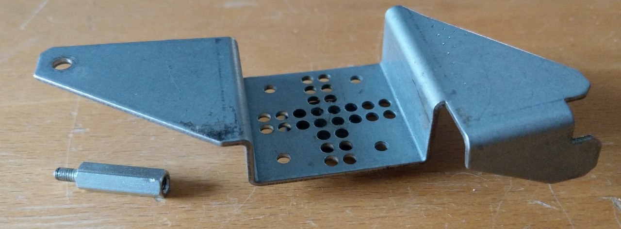

                                I have two motherboards with that northbridge issue. Would anybody have some of this bracket A5E01040392 left, or knows a supplier? Siemens service is not able to supply it.
                                Any help is highly appriciated.
                                best regards,
                                Horst
                                • Per Hansson
                                  • Jul 2005
                                  • 5895
                                  • Sweden
                                  #36
                                  I have one however it will not help you.
                                  The board needs to be reballed, I've had one done successfully by forum member Th3_uN1Qu3.
                                  That said this is a difficult board to reball because it uses black glue under the chipset.
                                  I have also had success with eBay seller hicomp-gmbh, however the price is about 10 times higher.
                                        Hi and welcome to Badcaps rossi, it is already mentioned in the two posts I quoted below, you can follow the blue arrow to get to the posts.
                                        I took a picture of the bracket, it is probably not available anymore, it puts some uniform pressure on the northbridge via 4 rubber feet on its bottom.
                                        (Missing on this one because they have a tendency to "melt").
                                        It is not a permanent fix, reballing the northbridge is the only permanent fix...
                                        There is a well known issue with the northbridge not making good contact on the Socket 370 boards.
                                        Siemens even released a mechanical "fix" for these boards, I've attached a picture of how it looks.
                                        The bracket for the Northbridge chipset (VIA Twister S3) is called A5E01040392
