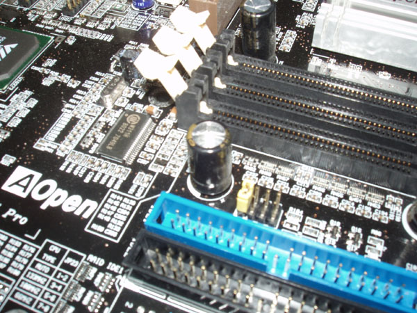

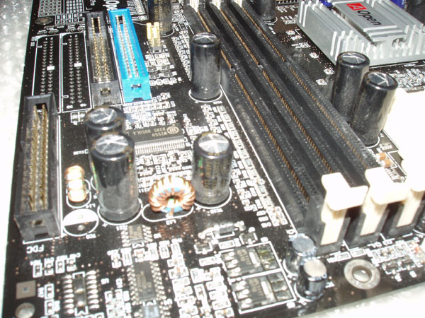

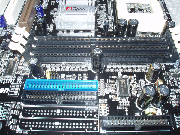

    Got two of these baords yesterday. They have managed to put two Lelon caps on these boards (both bad on both boards) besides high-quality (I guess...) Rubycon YXG-s (who produced the smaller blue 1000 uF caps seen on the third photo?).

    the blue caps look like united chemi-con but there is no series TMY found at united chemi-con. an internet search revealed no data on TMY therefore they may be crap and are imitating the look of united chemi-con.
    I have seen this on an Albatron PX-865PE board where amongst the 1000uf 6.3 United Chemi-con KZG which are little brown caps, they put also a few EVERCON 1000uf 10V caps which are the same colour and with the same vents as the United Chemi-con caps. Only the writing on the caps is different.
    It is curious that the TMY imitate exactly what chemicons look like. perhaps i am wrong?
    Rubycon YXG is at the bottom of the series of their caps relevant for motherboard applications, used because they are the cheapest i guess. An OK but not excellent choice for low ESR, the ZL series would be a better choice. At least they will not fail.
      or maybe it is a discontinued product? i am also trying to find the data of (look alike) chemicon LXF, chemicon "sam young" (<- is it really chemicon?), panasonic FJ (<- the top and the bottom seal are exactly like panasonic), and samsung ssl...
