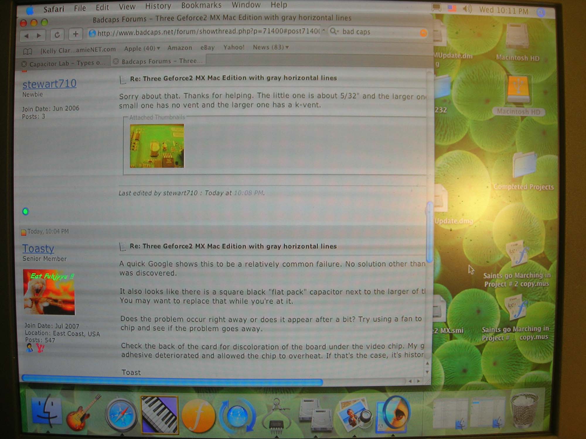

Three Geforce2 MX Mac Edition with gray horizontal lines
  • stewart710
    • Jun 2006
    • 42
    I have 3 Nvidia Geforce2mx AGP video cards pulled from PowerMac G4s. All 3 display the same symptoms. They have gray lines going across the screen horizontally wherever there are lines of text. The monitors work fine, it is definately the cards. There are 2 SMT capacitors on the cards that I plan on replacing just to see if it helps. I just don't know what the specs are.

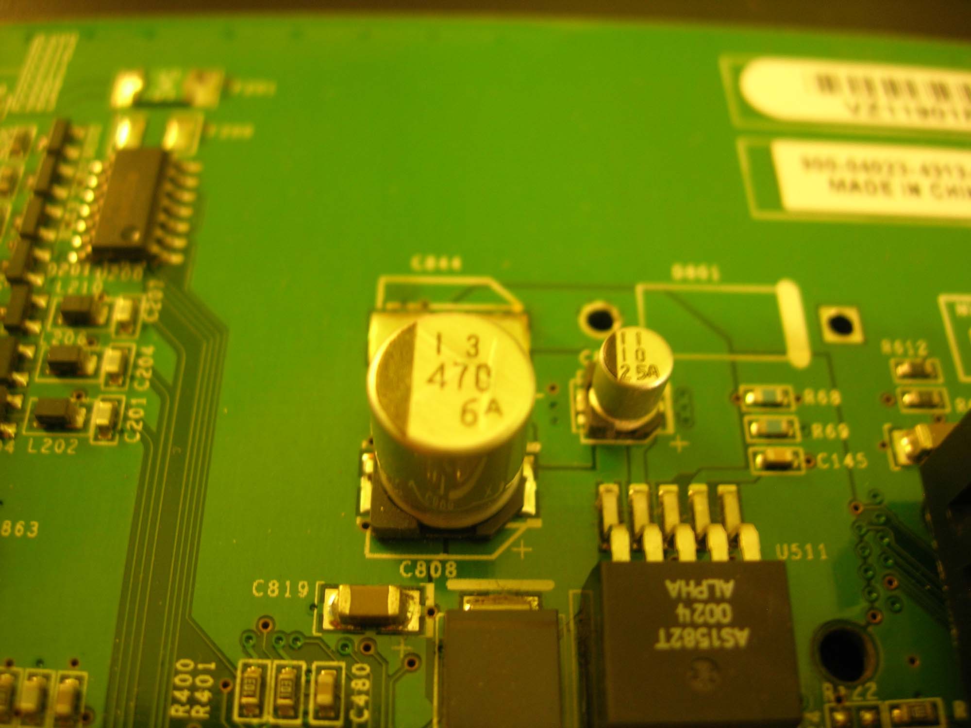

    Can anyone help me figure out which low-esr caps to buy? I'll probably order form Digi-key or Mouser.
    Thanks in advance.
  • PCBONEZ
    Grumpy Old Fart
    • Aug 2005
    • 10661
    Re: Three Geforce2 MX Mac Edition with gray horizontal lines
    Without having a pic this is a complete guess.
    470uF 6v [or 6.3v]
    10uF 25v
    So far as how low of ESR or how much Ripple we can't tell you without ID'ing the make and series of the old caps.
    You also didn't mention diameter.........

      Sorry about that. Thanks for helping. The little one is about 5/32" and the larger one is about 5/16". The small one has no vent and the larger one has a k-vent.

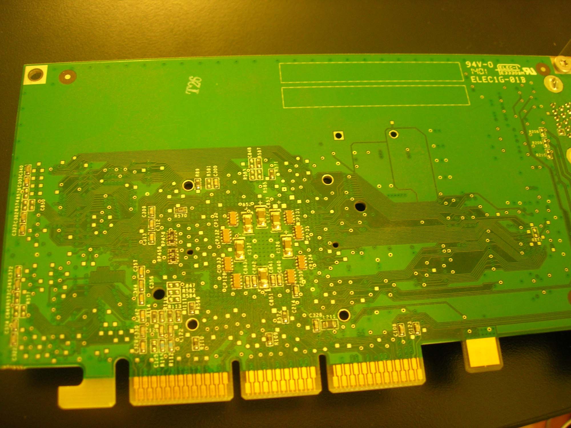

        It also looks like there is a square black "flat pack" capacitor next to the larger of the 2 aluminum can caps. You may want to replace that while you're at it.
        Does the problem occur right away or does it appear after a bit? Try using a fan to move some air over that chip and see if the problem goes away.
        Check the back of the card for discoloration of the board under the video chip. My guess is that the heat sink adhesive deteriorated and allowed the chip to overheat. If that's the case, it's history.

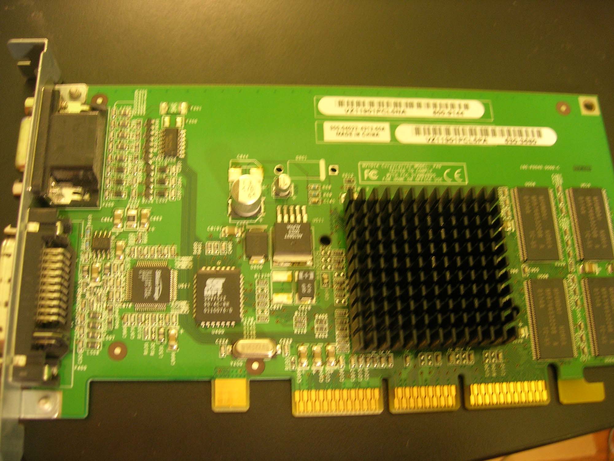

          Here are a few more pics. The funny thing is it is the same problem on 3 identical cards. None of them show any obvious discoloration or failed components. They are always like this, I don't think cool air is going to change anything. It starts on a cold boot with the Apple logo, before the OS loads.
          The flat pack is labeled:
          S4
          OC
          has symbol of 'G' superimposed on a sideways 'S'
          This is a capacitor?

              They are Suncon CE-AX Series
              The 470uF 6.3v - ESR 0.170, Ripple 450
              The 10uF 25v - ESR 1.800, Ripple 80
              Page 33 and 34.
              [It's almost a 17 Mb PDF file.]

                >>This is a capacitor?<<
                No, now it doesn't appear to be one but perhaps a diode.
                However the other one, below and to the right, does look like a cap. If you could take a clear picture (like your first one) of the other flat pack just below the 5 legged device marked Alpha and also the board markings and its markings, that would help.

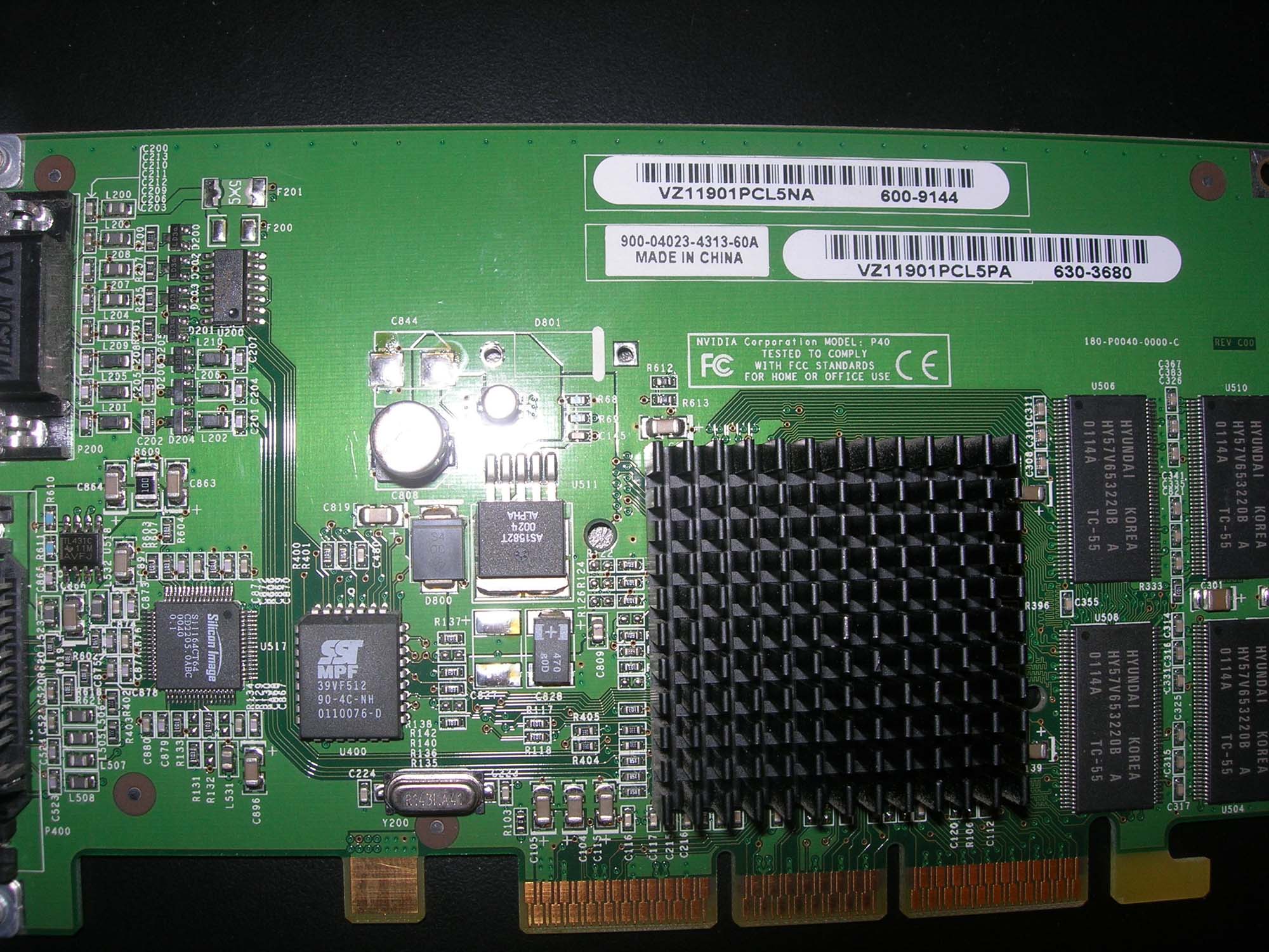

                Could you also post the nVidia part number 900-????? and/or the Apple number 630-?????

                  900-04023-4313-60a and 630-3680 or 600-9144

                    Appears to be a 470uF cap, but could also be a 47uF. The markings vary from manufacturer to manufacturer. I don't know the voltage by the markings, but you can measure across the pads to its left as they are connected in parallel with it. Choose the next voltage up. i.e. - reads 12v choose 16v, reads 16v choose 25v
