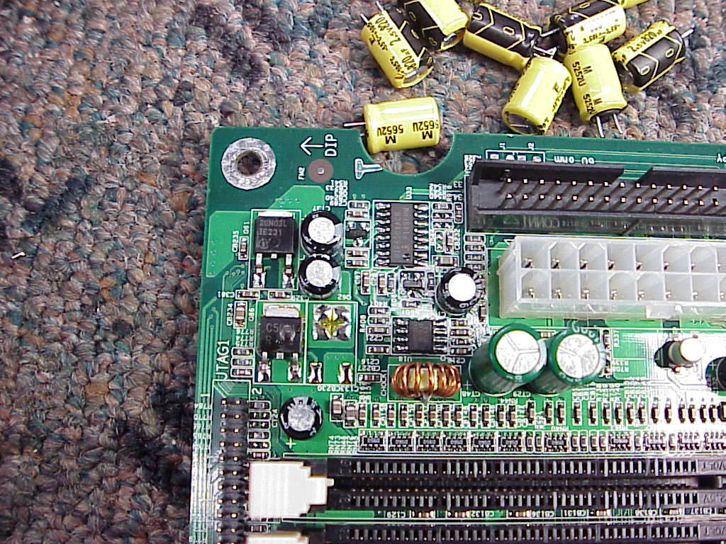

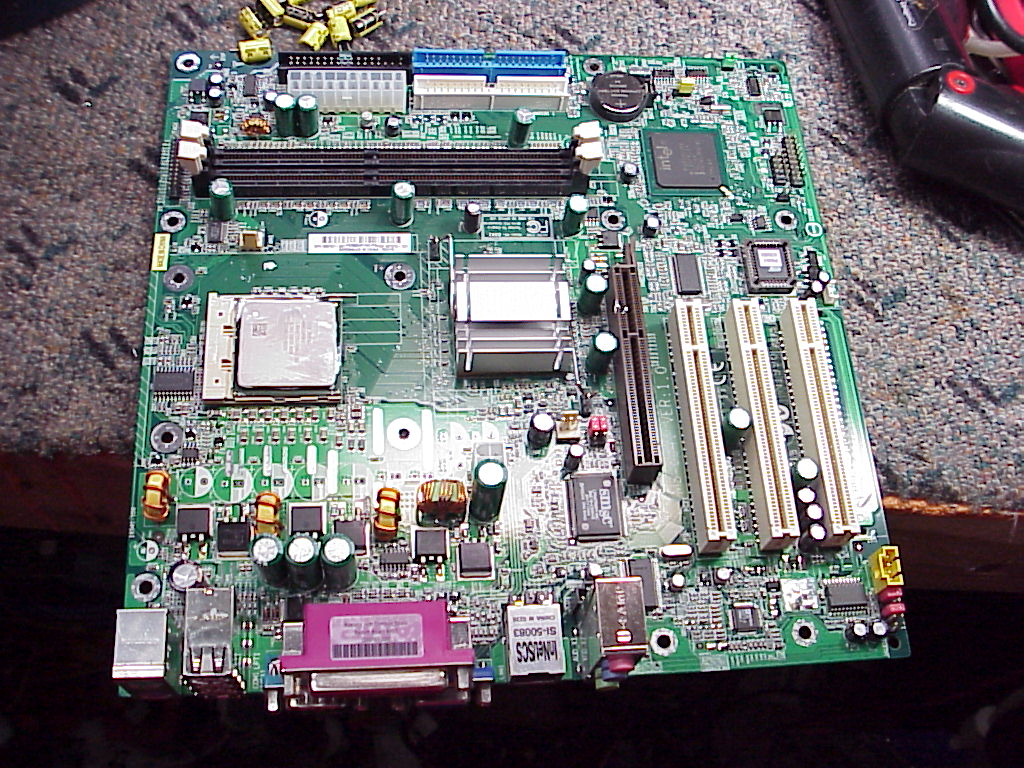

need to id q86 on ms-6541 ver 1.0
    blown vdimm reg.

    Re: need to id q86 on ms-6541 ver 1.0
    Any chance of saving that?
    Looks like something went a rye in the ram and burnt that out. Had that happen on my ECS rs482-m754.
      sure.
      thats why i asked about the transistor.
      easy fix.
          i got it under a magnifier and got 2sc5001.
          btw digikey has it.
          2SC5001TLQCT-ND
            I've had one of those MBs around here with that same device cooked off in the exact same way, for a couple of years before trying to find out what a "Q86" was. Hmmm? OK, longer than that now . .
            Anyway, I was going to build an inexpensive system for a technophobic type, and at the time, an AMD was a better idea, but as anti-tech as he is, I worried he'd be worse than usual if it was not the more heavily advertised "Intel Inside" P4. This MS-6541 had no bids on it at eBay, and I wasn't diligent about the fine print. My bid was the only one.
            But the seller had warned about a "bad Q86". I had no idea what that was, and for a dollar, plus about $8 of shipping, I just took my medicine (paid for it whether I wanted it that way or not). Now, the thing showed up when clearing a space to put another surplus item.
            For $9, is it really worth my time to try my hand at soldering (well, de-soldering first) on this motherboard? It's not much of an MB, limited mostly to 2.0 and under P4s, as it is . .
              go for it. if you let it sit then it is dead for sure, if you try to fix it then there is hope.
