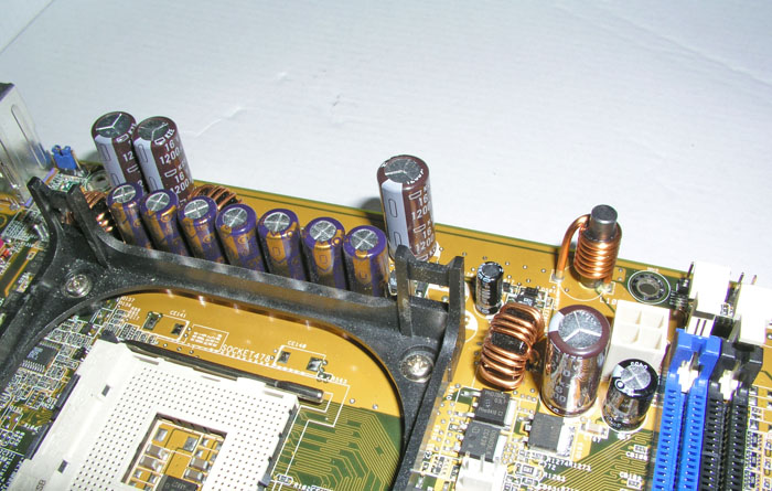

    I recapped the major caps on the P4C800-E. The row of 7 OST RLZ 1500uf 6.3 i replaced with 4 3300uf 6.3 Panny FC. Also i did the 4 chemicon KZE 1200uf 16V with 1500uf 10V FC. Gonna do the 20!!! OST 1000uf 6.3s later cos the RLZ were a real bastard to remove. had the iron on one for so long that it started fizzing. not good.
    The thing is there is this coil hum which happens each time i press a key in the bios. doesnt do it in dos when i type. cant remember if it did it before, prolly did. what is the reason for coil hum?
    EDIT : I have found it is a mistake to replace the 16V KZE with 10V caps cos it is probably the 12V to the VRM. I am putting them back until my next cap order.

      Could the coil humm you are experiencing be a result of the joint which got fried?

        i hope i didnt screw the board. anyway it is posting and running memtests fine so it at least it will have some future use.
        This time i found a thick (not sharp, rounded) sewing needle that was just the right size for the port and screwed it down into some electrical connecting blocks to make a nice handle. worked great. i am gonna look for a dental pick though, i can see it is a great technique.
        i am thinking that as the manufacturers switch to lead free solder we are gonna need more temperature.

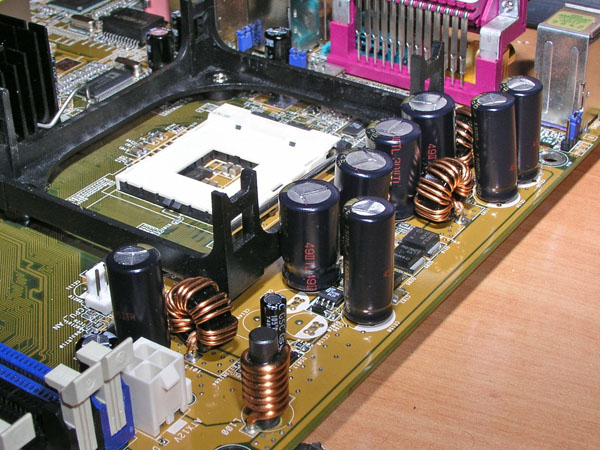

                                  I just got one of these boards in for repair... and noticed EVERY one of the caps is reverse notation for the installation.
                                  Every board I've done so far has the white silk screen lined up with the stripe on the cap. I just installed 6 VRM caps, and noticed they are backwards.
                                  The photos above also show the Stripe on the opposite side of the white screen art.
                                  The rest of the board I'm working on has the same (opposite) configuration.
                                  Any comments?

                                    I pulled and discard the six Rubycon MCZ that I erroneously installed backwards. Also replaced the four KZE with MBZ equivalents.
                                    That said, the P4S800-MX will power up, but will not post, nor beep.
                                    Basic question: if the board powers up, does that mean the CPU is alive?
                                    Or, can a board power up with a smoked CPU.
                                    This board is loaded with OST 1000uF craps, and I kinda hate to waste all my Rubycons on a board that is hopeless. Is this a stupid posture, or is there a strong liklihood the OST field caps are preventing POST?
