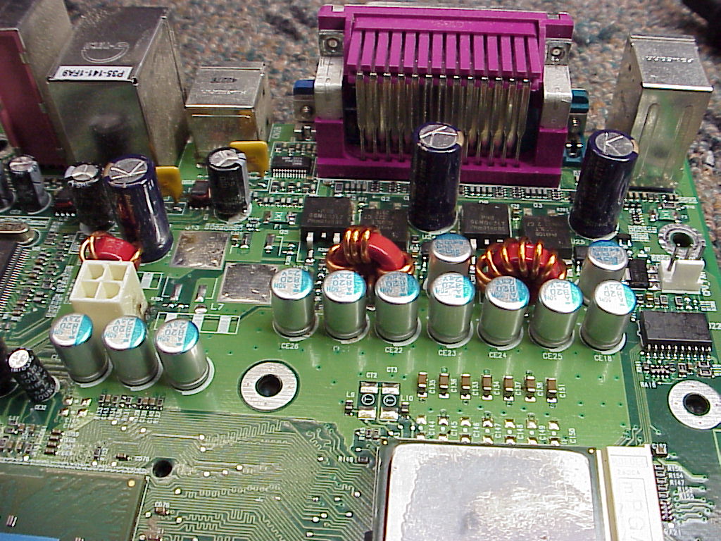

    Hello all. I have an HP 742c desktop that has 10 bad caps. I have never replaced caps, but am OK with soldering. My question is which caps should I get? The caps are all 1500u 6.3V with 105c temp.
    Link to mobo
    The caps are all the same. [/IMG]
    Sorry its so blurry.

    Re: HP 742C with 10 bad caps
    imperial gl/gv ve?
    i use 820@2.5 polys in those.
    just the ones on vcore though.
    these were a common trouble board so i bet topcat has a kit for these.the kit is the easy way if this is the only board you intend to fix.
              hn are a possible problem series.
              at any rate they dont take heat very well.
              these are all on vcore on imperial mobo's.
              fill any empty spots when you recap.
              btw i recapped this with nippon chemi con psa 820@2.5v
              the very common fujitsu re 820@2.5 are the same.
              i have both on hand in large quantity so i use them wherever i can.
              see pic
                Mouser stock for HN and HM is new/current production.
                Not the old 2001-2004 vintage with problems.
                Using poly in Vcore as kc8adu suggested is a probably a good idea anyway.
                Not mandatory, just a good idea....
                Poly's do better than Lytics right next to a hot CPU.
                Get a 60+ watt soldering iron. Mobo PCB is thick and you'll be glad you did.
                (Well, no, you won't. You won't know how much it sux to use a smaller one if you're using a 60+watt to start with.)
                Also if you have a Bestec 250 watt PSU (often found in Imperial GL/GV based systems) then chunk it in the shit-can and get one that doesn't burn-out chipsets on motherboards.
                    You aren't simpleton. You're a newbie. There is a difference.
                    Welcome Newbie! -
                    All the caps you are replacing are 1500u 6.3v?
                    What make and series?
                    What diameter are they?
                    You going Lytic or Poly?
                    Make sure specs on new ones meet or beat specs on old ones.
                    You want ESR on the new caps to be the same or less.
                    You want Ripple to be the same or more.
                    Make sure diameter will fit in the spot.
                    Next to slots or CPU make sure height isn't an issue.
                    8mm usually has 3.5mm lead spacing.
                    10mm and 12.5mm is usually 5mm lead space.
                    For a Mobo 6.3v and 10v caps are interchangeable as on a motherboard they are used on 3.3v or 5v power and either 6.3 or 10 caps will do fine.
                    As for grade:
                    HM is comparable to MBZ.
                    HN is comparable to MCZ.
                    To order from here go to:
                    https://www.badcaps.net/pages.php?vid=23
                    You can also go to eBay, Mouser, or Digikey if you are in the US.
                    In this case Digikey is probably only good for poly.
                    The highest grade of Lytics they stock is Panasonic FM which is slightly less than MBZ.
                    (Not much less though.)
